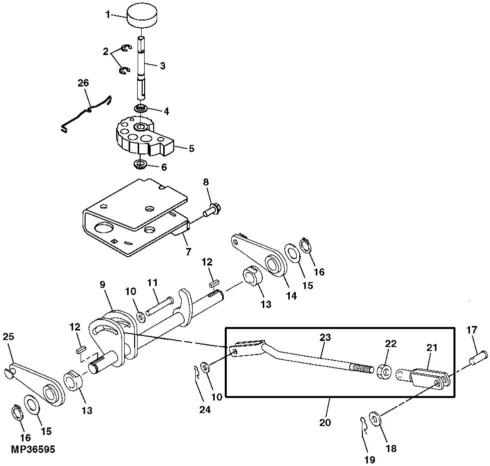

I am also looking for information concerning the mower adjustment knob, I cut my grass for the first time with the 54D and no matter where I set the adjustment I had to adjust and lock on my 3 point hitch slide for the desired hieght am I doing something wrong?????? As far as the tractor goes I worked in the woods with it all day yesterday and it worked flawless could not ask for a better tractor not to big and not to small with lots of power but it is all new for me for this is my first tractor.
/ Taking the plunge! (2320!) #6
I have a 2320 and am very pleased with it.
The mower adjustment knob on the tractor deck near your right foot is to regulate how far down the deck goes or is used to lock the deck in the up position.
If it is not stopping the deck at the height you want there is something wrong.
Attached is the picture of mower deck height adjustment assembly from JD parts. After looking at this you might want to check under the tractor to be sure all is assemblied and hooked up correctly.
Remember the independent lift kit and/or the 3PH lift is not intended to be used as for the height setting

/ Taking the plunge! (2320!) #8
So let me get this straight the lever for the three point should not have control of the deck???? I followed all the instructions along with wheel adjustments but as I said no matter what I do with control knob on the bottom for deck hieght it seems not to have any bearing on it and as I said I had to lock in the three point lever to get the proper adjustment. Thanks for all your help.
/ Taking the plunge! (2320!) #9
"Thanks for the replies. I'm assuming the dealer is the source for the shop manual??"
Yes.
/ Taking the plunge! (2320!) #10
Something is definatly wrong if the height adj knob is not working for you. The one on our tractor works perfect, you should only have to move the 3pt control very little to get the deck to drop to the stop set with the height adj knob. Of course all this is rendered usless if you have the independant lift kit. The upstop limiter was not set right on ours when we got it which caused some issues with locking the deck fully up but other than that all has worked as Deere says it will.
