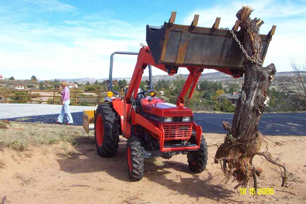

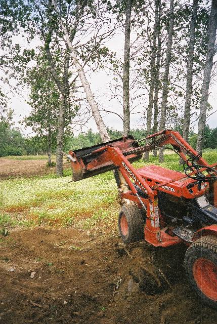

Egon said:
Tacking down trees with a tractor can be done if there is a correlation to tractor size and tree!!:D
Egon,
One time I was doing the same thing you are showing in your picture with a similar size tree. The tree sheered from the bucket and the pointed top quickly slid over the bucket toward me. This happened so fast that I could not react. I feel I was real lucky when the tree got hung up and stopped short of my head. That was the last day I tried to push trees over! We now tie small trees as high as possible with a rope and from a safe distance pull the tree by hand in the direction we want it to fall. I have also seen large trees move equipment (trucks and logging machines) that were cabled to them! These trees I leave to the pro's.
