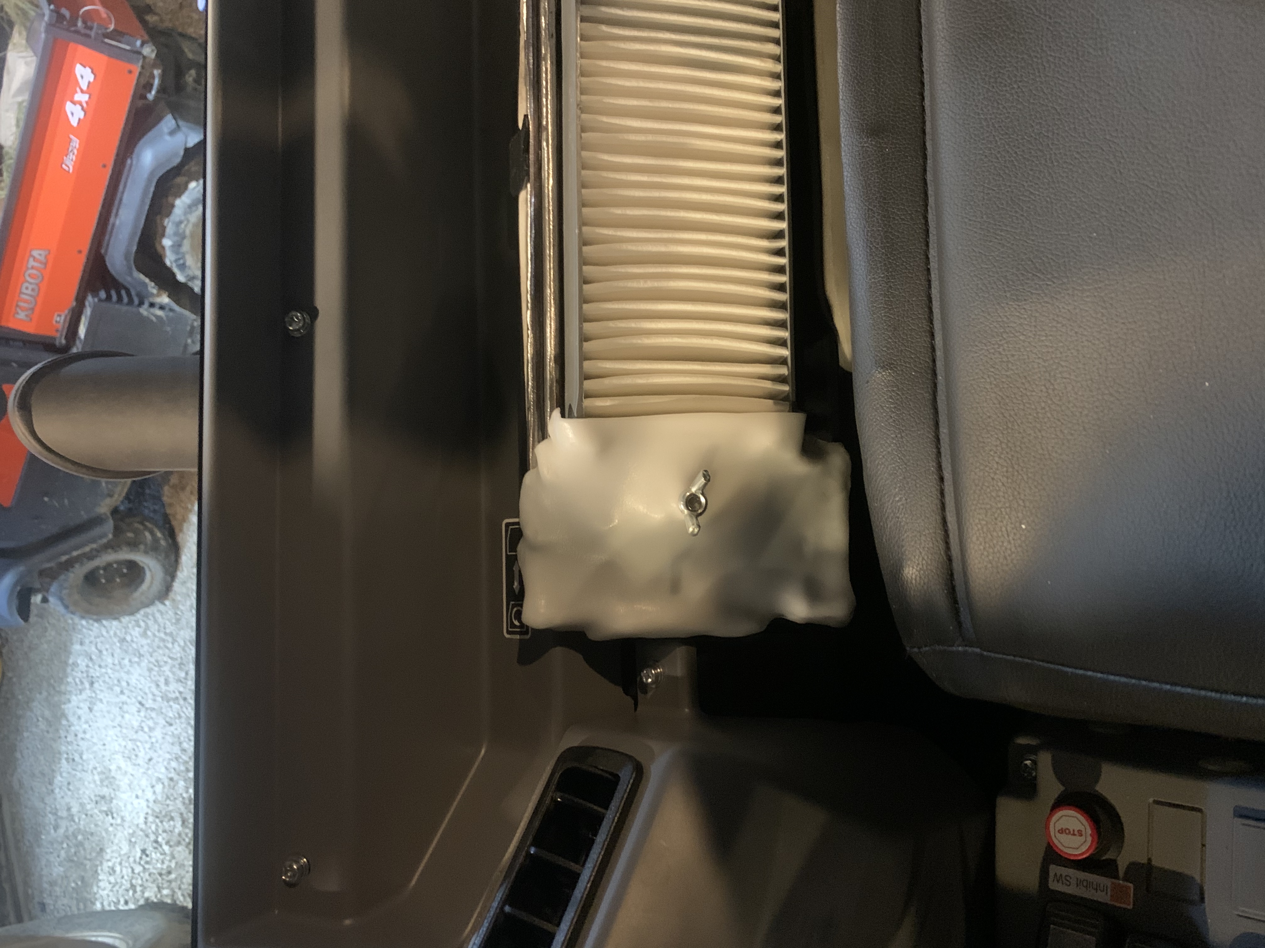

20007130-1D28-41FB-A653-15036E05AA53.jpegThose familiar with the cheap way kubota sucks fresh air, which helps with positive cab air flow, I didnt just want to block it off. So I had some thermo plastic and molded a cover that connects it to the filter.
