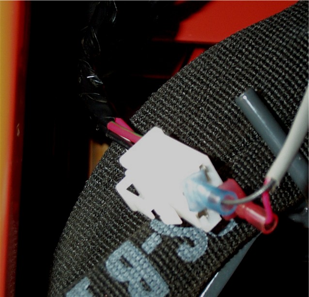

Did you cut the transponder wire, or just coil it up, its about 3 feet too long? I have a gap when the hood shuts, the wires fit in the gap without drilling a hole in the black plastic. Any reason why you choose to drill a hole? The wire for the power fits through the space for the throttle cable, did you just fit it through the space or make another hole? And finally what size male spade did you use to connect to the loose connector above the battery?
Thanks for your help.
/ Tach installed on BX #29
I didn't drill any holes-- ran the transponder to the engine compartment through the hole for the throttle cable and just bundled the extra wire using a small tie wrap to hold the excess. There was also room under the grommet around the lever for the hood release to get the wires through to mount the control unit on the dash. No drilling, cutting or other modifications.
Don't remember the exact size of the spade lug for power, probably 1/8" or so, I had quite a few laying around just found one that fit. Good luck with the install.

Thanks for all the comments, I just installed the Tiny Tach and it turned out GREAT! /forums/images/graemlins/wink.gif I mounted it via the large screw and used a piece of angle iron painted black. I ran the wires via the throttle cable entry through the firewall and used the picture JRW posted to wire it via the extra connector above the battery. I tied wrapped the extra wire to the wire harness in the engine. I even printed out and laminated the RPM/PTO small chart Tractorless made and put it on the key ring.
