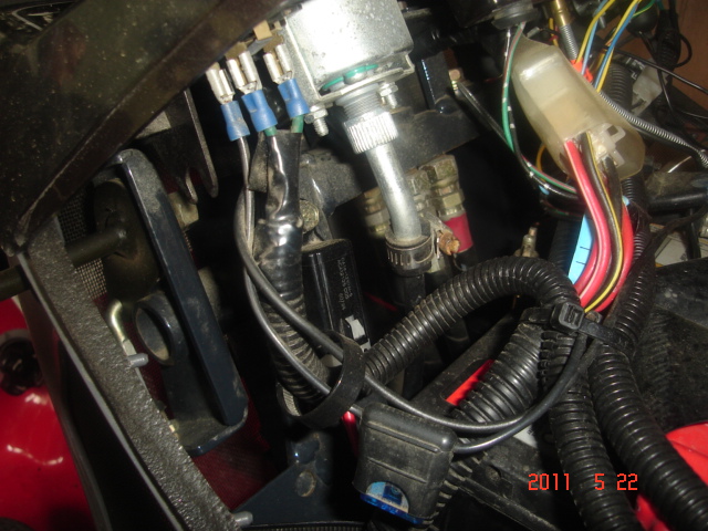

Curious... Mine has a nice, gentle 40-degree or so bend at the gauge, and is still operational.
The only problem I had was that the knurled nut fell off just after I got the tractor 3 yrs ago- apparently not tight enough from the factory. Problem was, the nut then slid ALL THE WAY DOWN THE CABLE and was very hard to retrieve.:mad: One of those 40-second jobs that turned into a small nightmare.
Fixed that by putting a piece of rubber hose and a small clamp on the cable so it can't get lost again....
Still wish the &%^$# thing had a light!

That is exactly like the cable that is on mine and I wsa thinking it was about 10-15 degrees. How-ever it is right at that bend where the cable breaks.
Wonder where a chap could get a 90 degree small worm gear attachment for that end. I have seen similar somewhere but like everything else I can't remember where.
