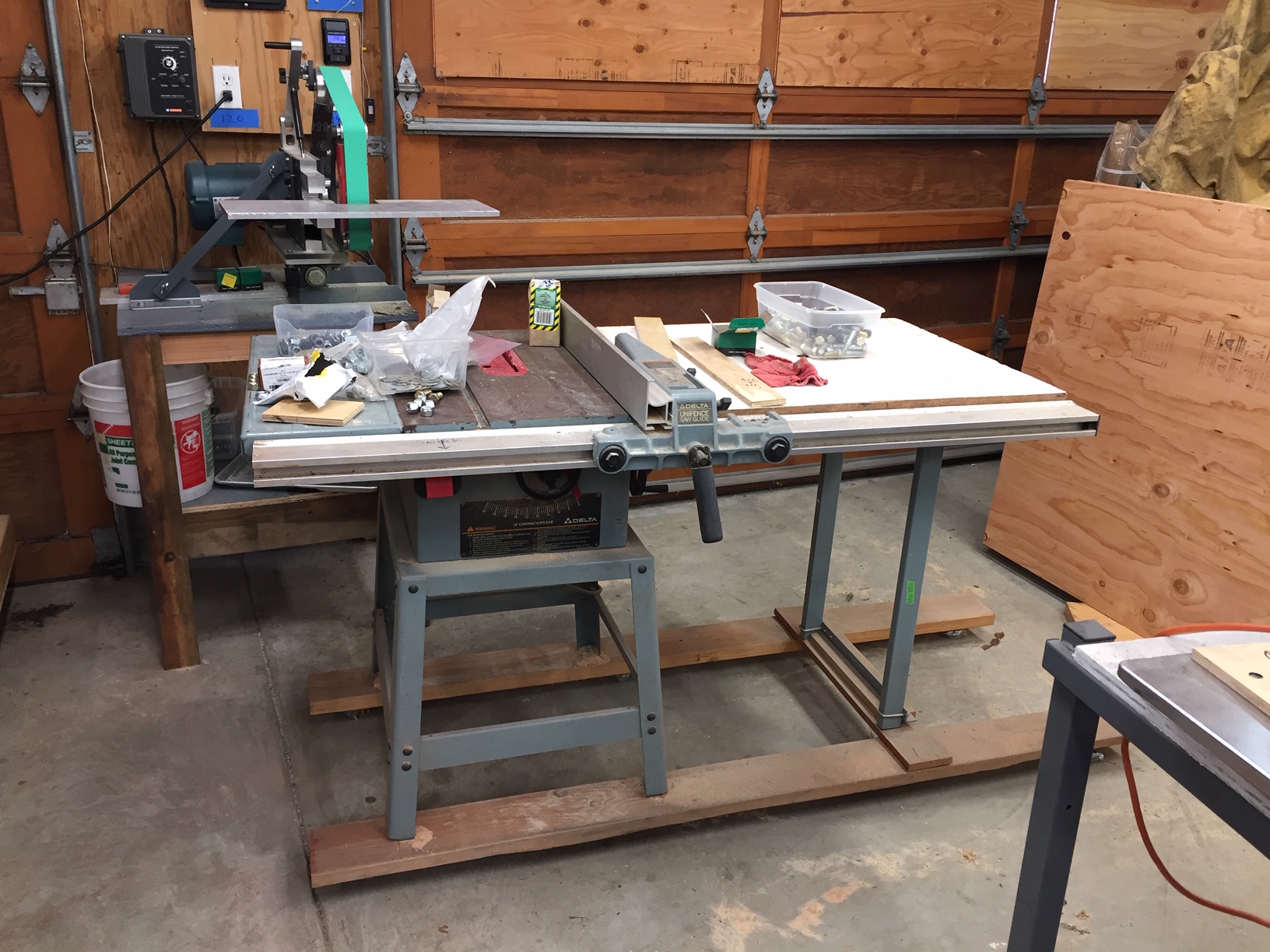

When I got the Delta saw and fence extension 35 years ago I made a simple rolling base from scrap lumber. I used 6 2" swivel casters. It moves easily. To stay in place I wedge a block of wood under it, takes maybe 10 seconds. Been using it that way with no problems for a long time.

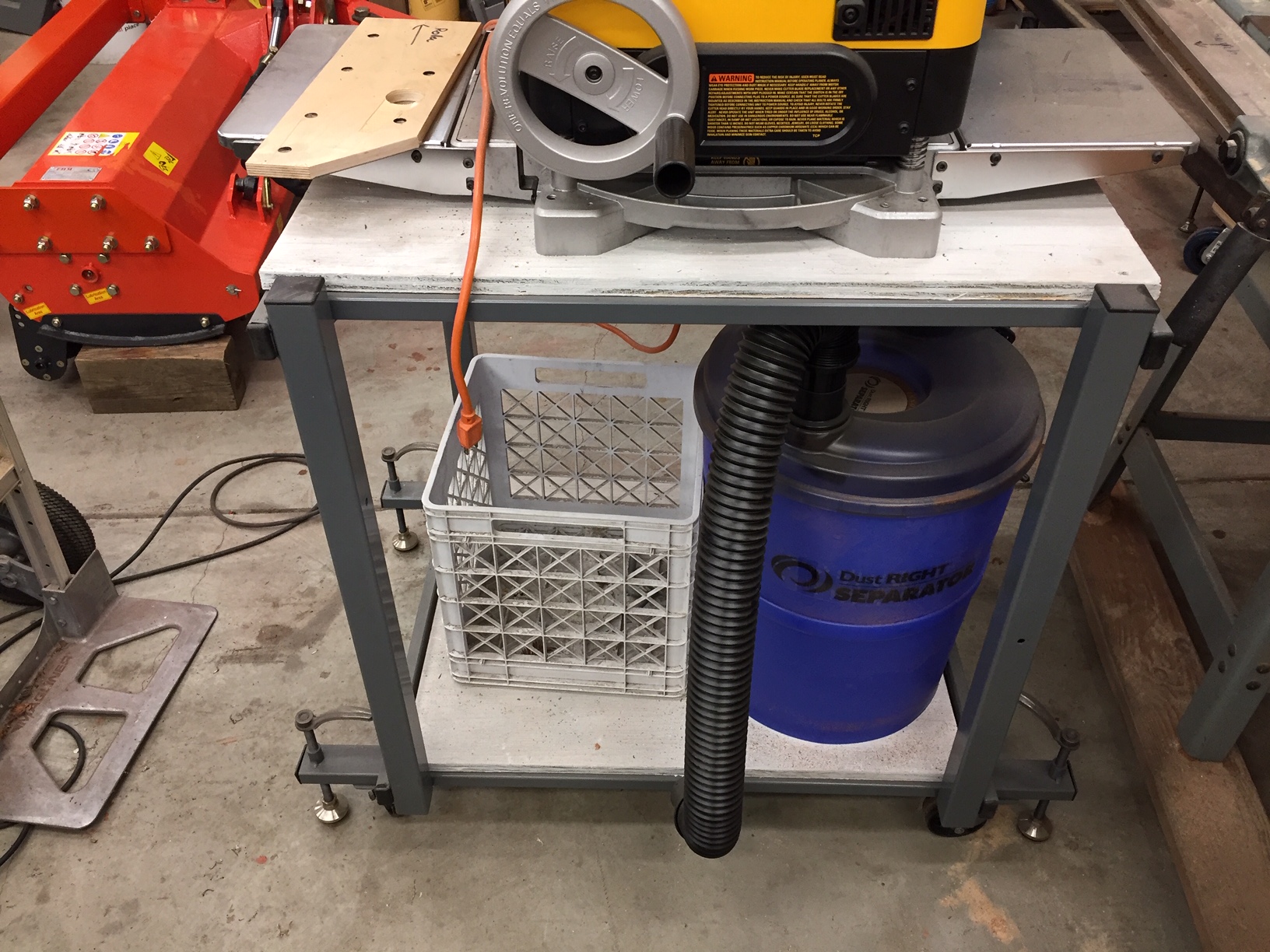

Much more recently i got a benchtop planer and made a stand with 4 swivel casters, 4". To keep the planer absolutely rock steady I put screw lifts on all four corners to raise the wheels off the floor. Takes just a few seconds to do that.
I have other tool stands with 2 swivel casters and 2 fixed casters. Can't say it makes much difference either way.
