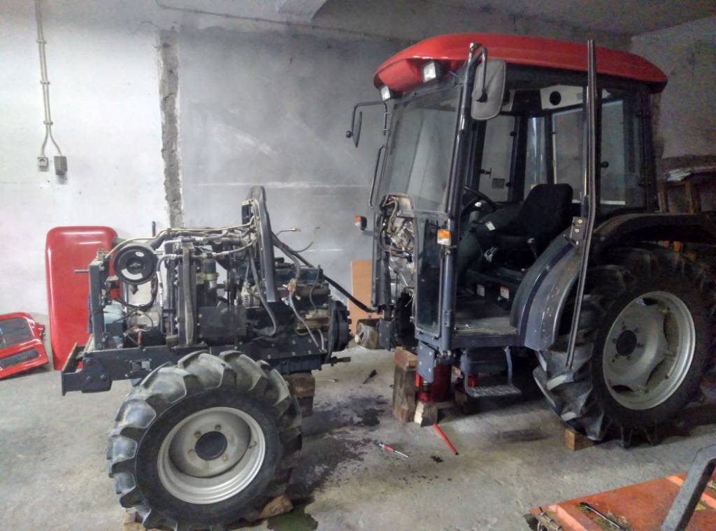

May 4, 2019 / T450 #1 iseki Silver Member Joined Feb 1, 2012 Messages 164 Location Calhandriz , Lisboa. Portugal Tractor Iseki TA 357 / Fiat 455 C / TYM T451 New clutch disc with 120 hours !!! It will be possible??? Has anyone had similar problems?
May 4, 2019 / T450 #2 ptsg Super Member Joined Apr 3, 2013 Messages 7,230 Location Portugal Tractor Branson F36Rn - Agria 8900D Wow! Really? That's unlucky! What was the problem? Wear? Burned disc?
May 4, 2019 / T450 Thread Starter #3 OP iseki Silver Member Joined Feb 1, 2012 Messages 164 Location Calhandriz , Lisboa. Portugal Tractor Iseki TA 357 / Fiat 455 C / TYM T451 I bought it two weeks ago, the former owner should rest his foot on the clutch pedal
May 4, 2019 / T450 Thread Starter #4 OP iseki Silver Member Joined Feb 1, 2012 Messages 164 Location Calhandriz , Lisboa. Portugal Tractor Iseki TA 357 / Fiat 455 C / TYM T451 ptsg said: Wow! Really? That's unlucky! What was the problem? Wear? Burned disc? Click to expand... Burned disc
May 4, 2019 / T450 #5 ptsg Super Member Joined Apr 3, 2013 Messages 7,230 Location Portugal Tractor Branson F36Rn - Agria 8900D Conseguiu arranjar material para isso? Pelos vistos foram 120 horas a passear com o pé na embraiagem. Até dá pena ver um tractor desses, nesse estado.
May 4, 2019 / T450 Thread Starter #6 OP iseki Silver Member Joined Feb 1, 2012 Messages 164 Location Calhandriz , Lisboa. Portugal Tractor Iseki TA 357 / Fiat 455 C / TYM T451 É verdade , tal foi o aquecimento que o ferodo até se está a desfazer , fiz 3 horas nele e consegui chegar a casa mesmo a conta
May 4, 2019 / T450 Thread Starter #7 OP iseki Silver Member Joined Feb 1, 2012 Messages 164 Location Calhandriz , Lisboa. Portugal Tractor Iseki TA 357 / Fiat 455 C / TYM T451 Há uma oficina aqui perto que colocam forras novas , é lá que vou com o disco na segunda feira
May 4, 2019 / T450 #8 ptsg Super Member Joined Apr 3, 2013 Messages 7,230 Location Portugal Tractor Branson F36Rn - Agria 8900D Visto que aqueceu muito, é melhor inspecionar bem para ver se a prensa não empenou com o calor ou se as molas não deformaram. Senão nunca fica a 100%.
May 4, 2019 / T450 Thread Starter #9 OP iseki Silver Member Joined Feb 1, 2012 Messages 164 Location Calhandriz , Lisboa. Portugal Tractor Iseki TA 357 / Fiat 455 C / TYM T451 Isso já estive a ver e está tudo direitinho, mas obrigado pela dica
May 8, 2019 / T450 #10 B Btown Veteran Member Joined Sep 22, 2012 Messages 1,314 Location MA Tractor Ford 1920 Some people don’t know how to use a clutch. Should be a really nice T-451 when you get it back together.
