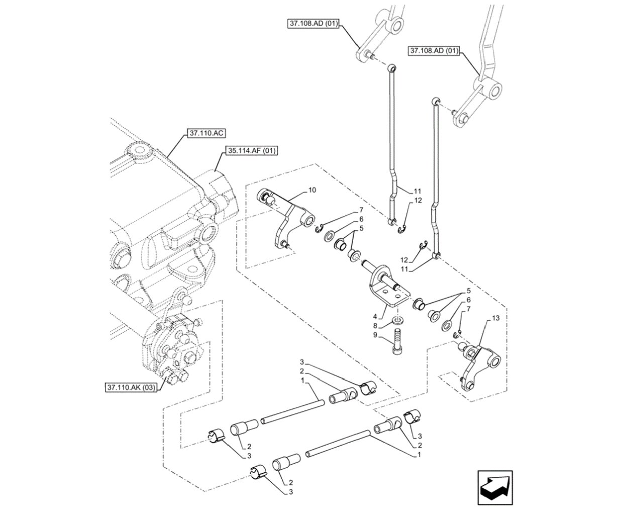

OK TXCYCLE,
I don't have the external lift controls but they are on my wish list, it looks like #1 is a
threaded rod and #2 is a threaded fitting, I'll take a look at them and see if we can
get an adjustment on it.
Thanks

We'll we did get a good look at the shafts, they are properly adjusted
and are traveling all the way to the stops. I am using the same quick attach
that I used on the DX60 with this same snowblower, this tractor just does
not lift the same hight at the old tractor. If I can get a top link adapter
for my cat 2 quick attach I can hook up at a lower hole on the snowblower.
I'm going to get my local guy to look at it.

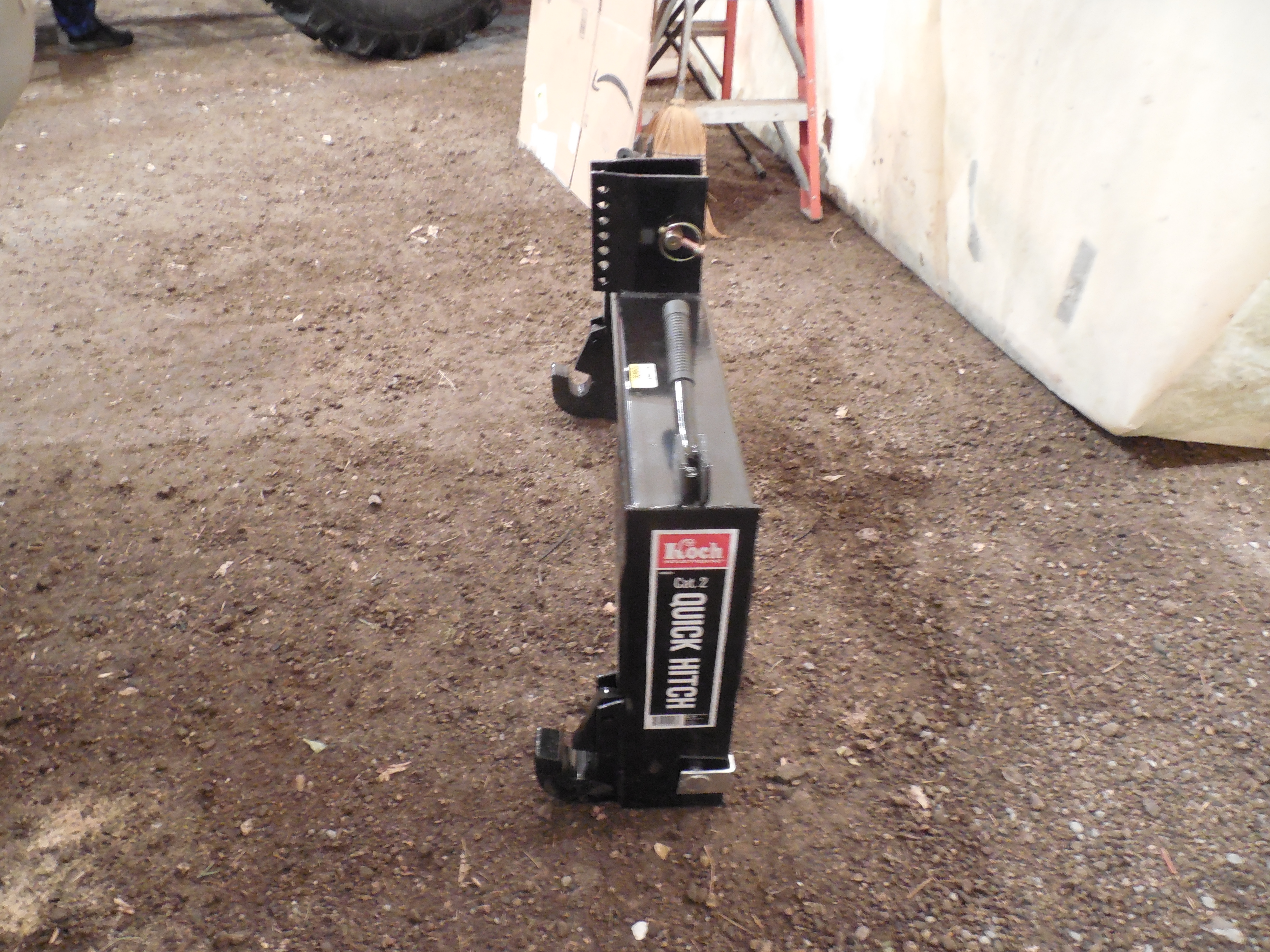

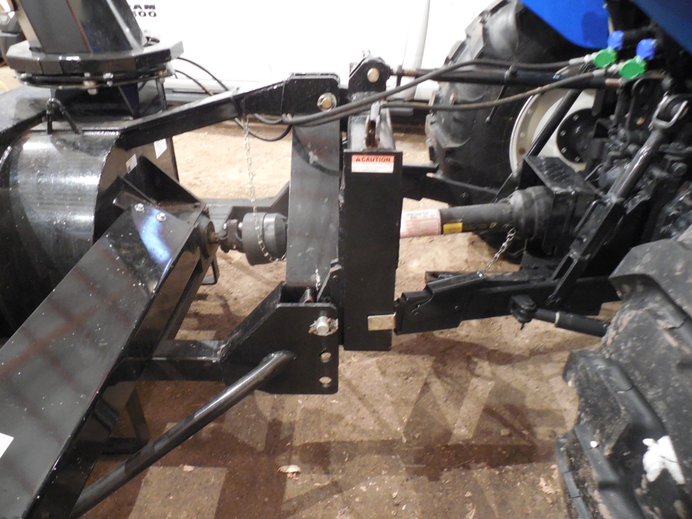

#13
Hey Guys,
Last night Kim and I were running around and saw the new L & M Fleet Supply
in Thief River Falls, we were just looking around and found a Cat 2 Quick Hitch
with a adjustable top link. It was priced at $249.00 so we grabbed it.
With a little work and I had to change out the top hook for one we had here
(We needed a little more wiggle room for the top link to go in easy).
We went from 7" ground clearance to 14".
So our old setup
To our new setup
So we are good to go now, our Cat 1 link adapters will work with this so we don't have
to take it off to hookup our mower.
