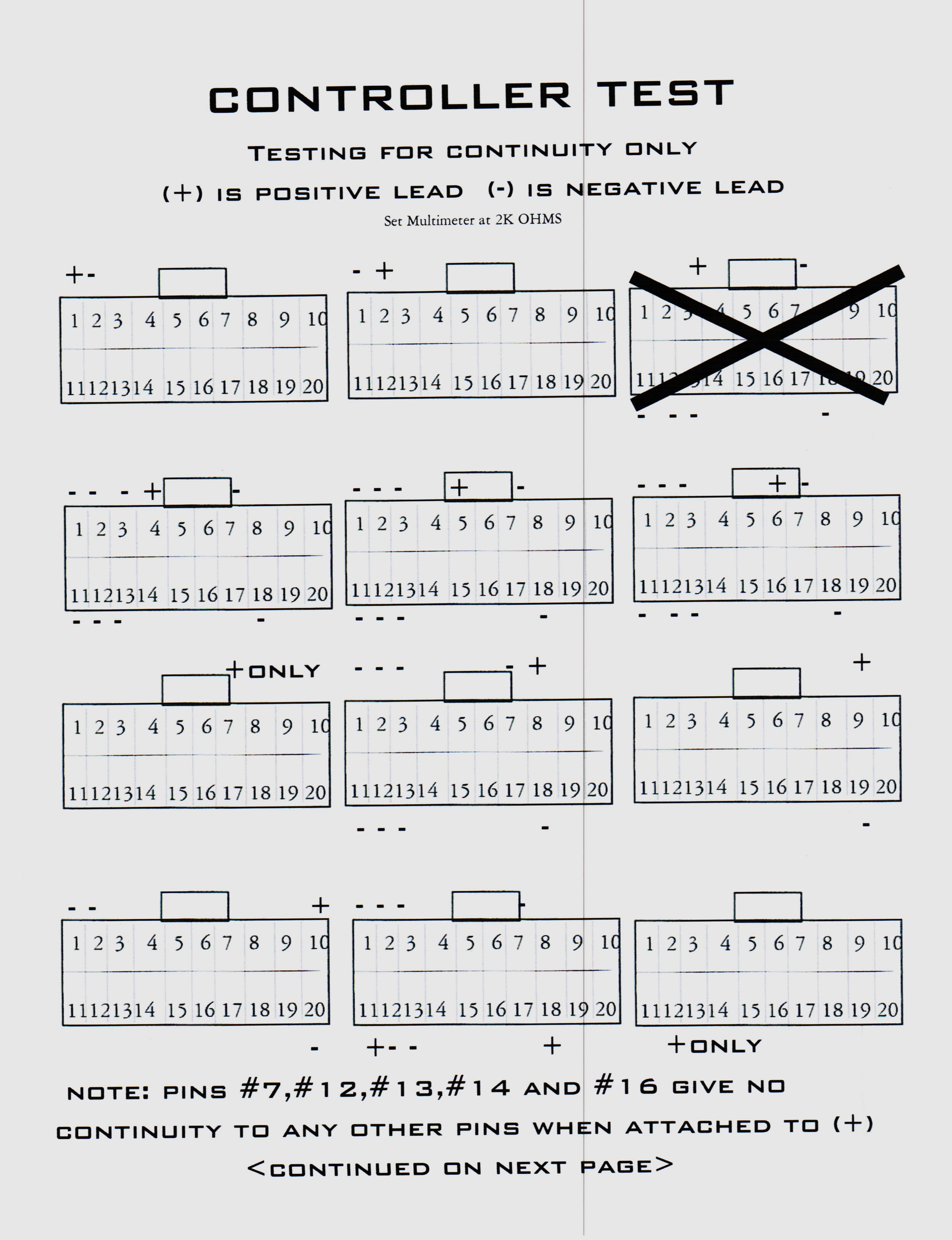

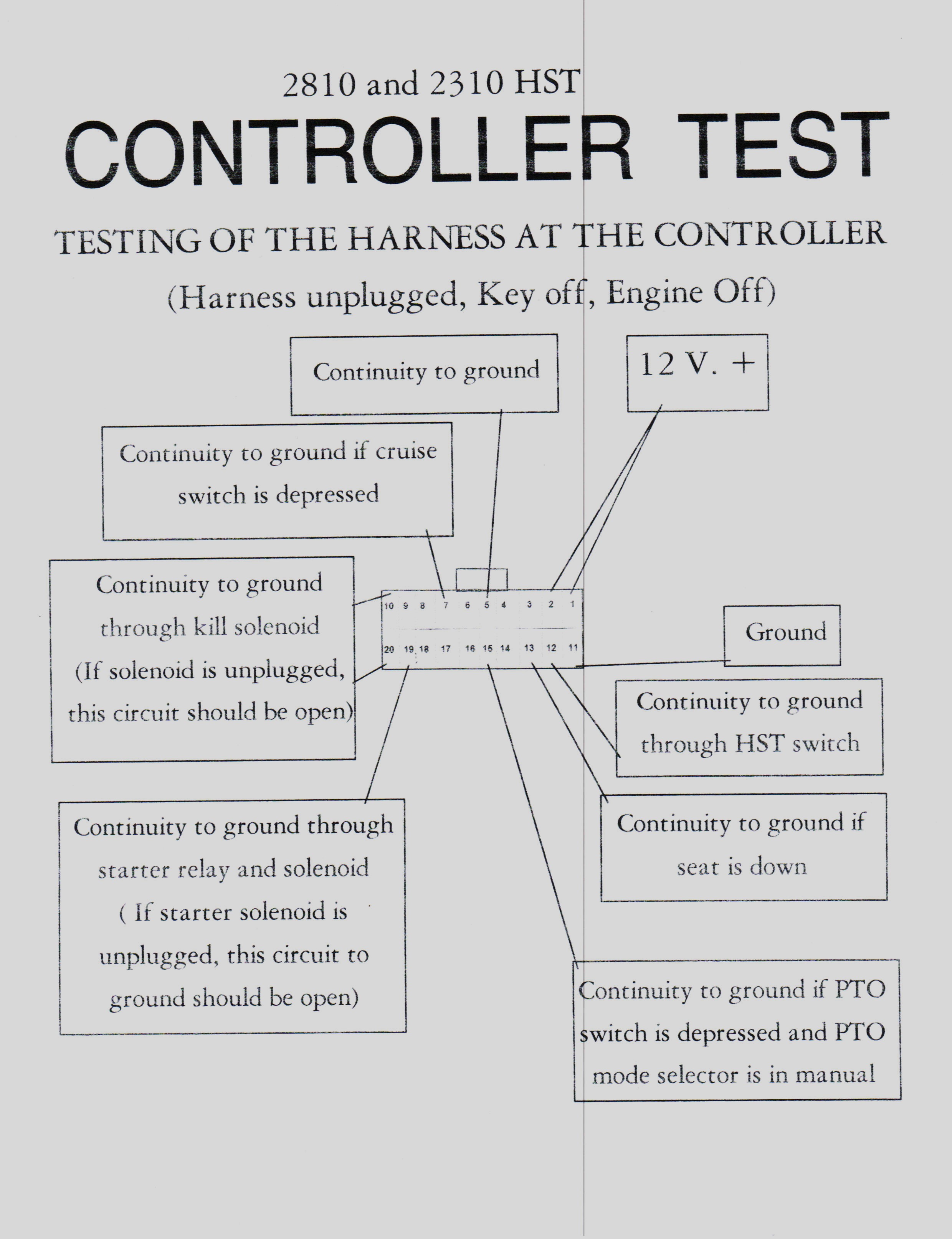

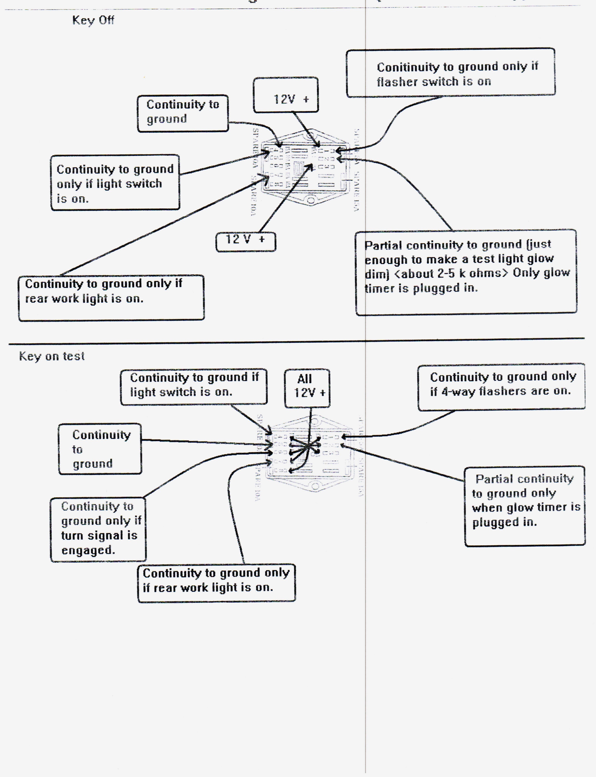

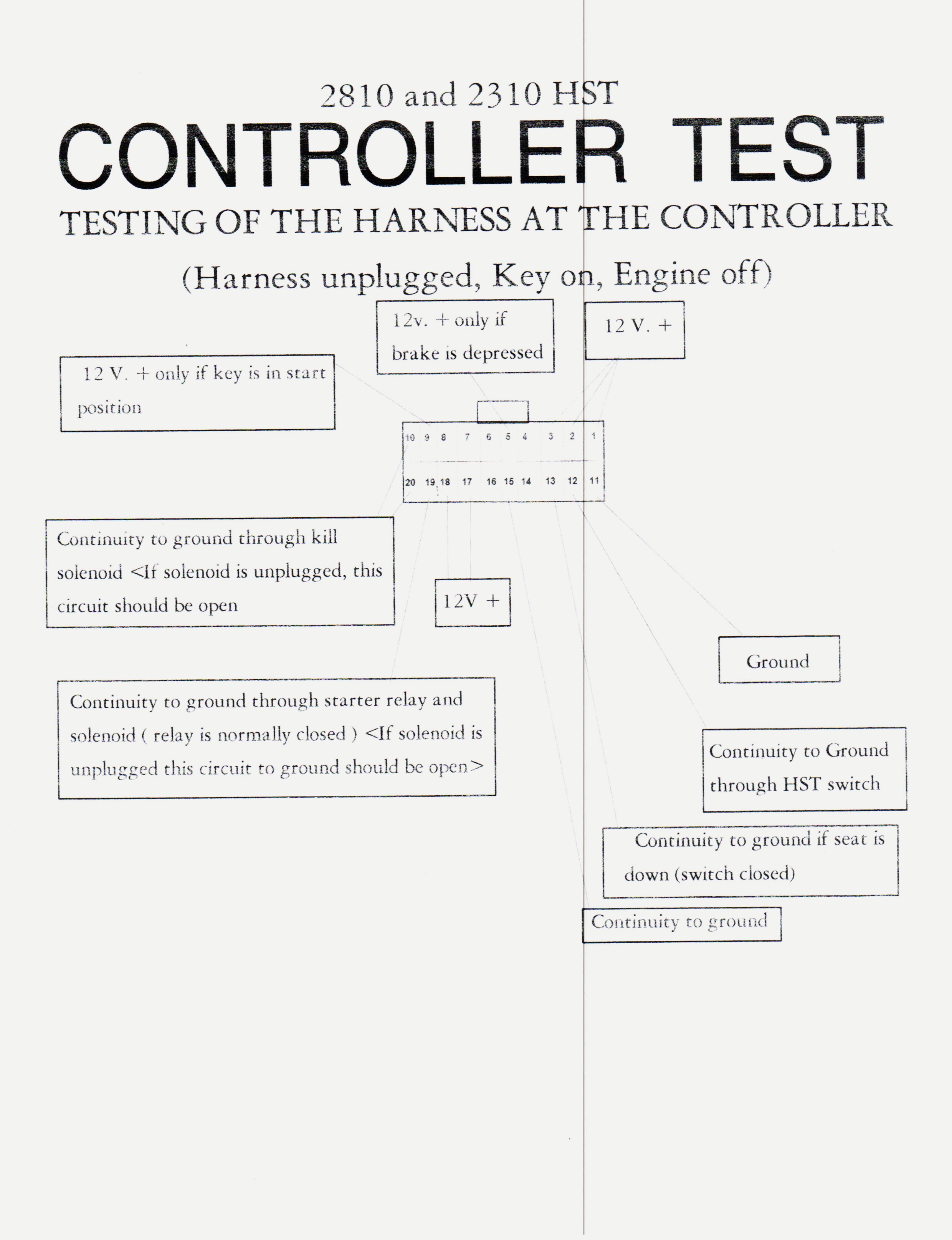

Measure the voltage on starter solenoid when key is in starting position. You might need a helper to do so. In lack of helper put a light parallel to the solenoid. If light turns on when trying to start then the solenoid is bad or has bad connection. You can also measure the resistance of the solenoid against ground. It should be several ohms ( 10 ohm plus minus) I think. If the solenoid pulls but the tractor doesn't start the solenoid contact is bad or the screws holding the contacts are lose. Some solenoid can be taken apart some has to be replaced a unit. If there is no voltage on the solenoid then it is possible that the control unit is faulty. Call the dealer and ask for testing diagram. Attached is testing diagram for TYM 330. The control units might might be the same. If not then the dealer has the correct diagram for your tractor.
CCF07182013_00000.jpg CCF07182013_00001.jpg CCF07182013_00002.jpg CCF07182013_00003.jpg CCF07182013_00004.jpg CCF07182013_00005.jpg CCF07182013_00006.jpg
