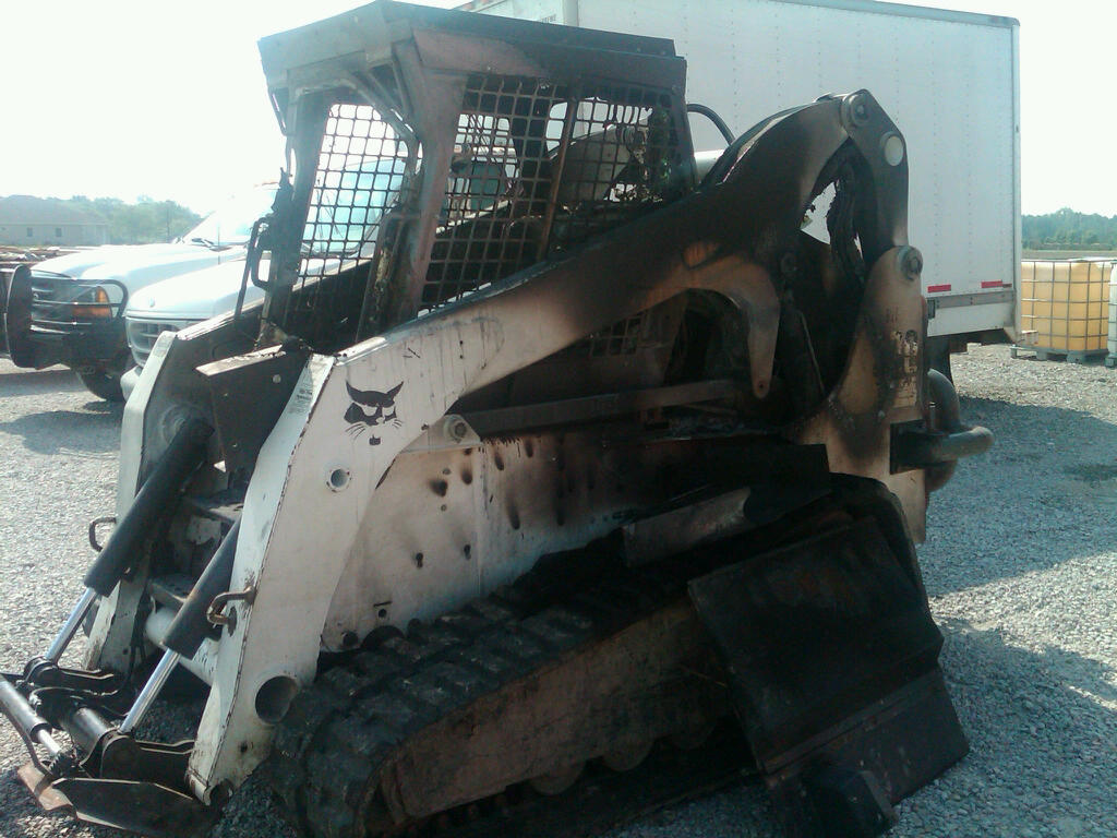

I just got this from one of my friends that still sells Bobcats. He said to replace the covers around the cylinders when they get torn in the woods and really take the time to clean your engine compartment. He knows of quite a few that have burned and thinks that the forestry kit gives the operator a false sense of security.
Covers around the cylinders? Mine are covered with steel plates and I always blow radiators and engine/turbo compartment out at least every 4-8 hrs per day depending on conditions.
No debris accumulating to speak of in that short of time unless you work under tall pines with a lot of dead pine needles raining down on you.
I guess some use a type of cover on the rear lift cylinders?
