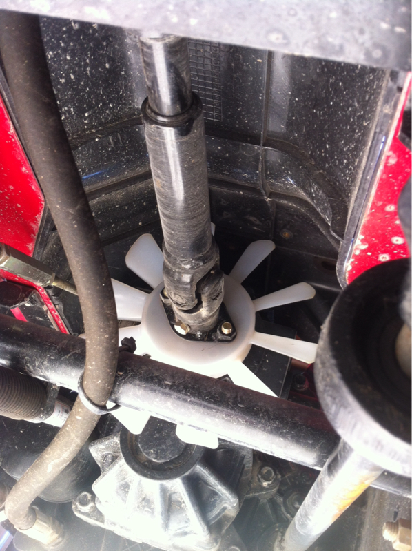

I also have a TYM 273 that the drive shaft broke. After looking at it and the design I seen a major problem
The shaft is made to run straight. The engine to the transmission is not in line . There is a drop of about 1 inch so this is why the shafts break . TYM replaces it with a shaft with 2 u joints and a center spline . A much better system but it has no grease fittings so crossing my fingers that it last for more than the 350 hours I have on it now. The dealer here in Pa has them on stock so it is a issue. Price was 218.00 plus sales tax total around 230.00. If anyone has the old style shaft that goes bad it is a chore to get off. Now that I know id just cut the shaft in half and slide the ends off the splines. The new one slips on the splines and is held there with a pinch bolt on each end. Good luck with it. TYM don't seem to care about this problem but has upgraded the shaft. There gain our loss. We have to buy it.

So here is the telescoping version on the Mahindra eMax 25.
$500+ for the whole thing. It might fit but it also comes with the fan.
I may just order a TYM shaft.
