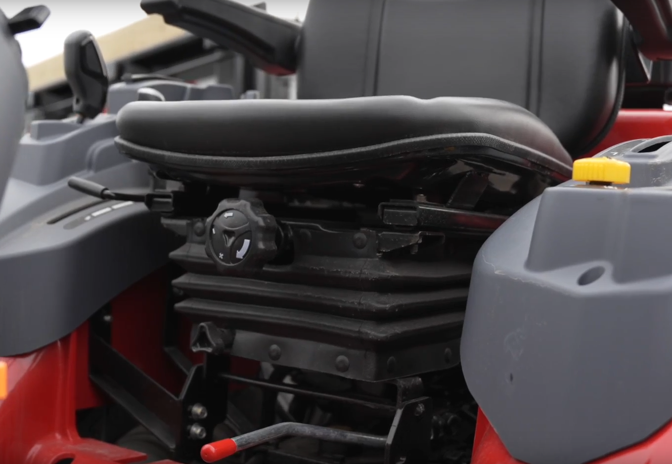

I’m trying to reconnect the backhoe but the left hydraulic line, when facing back of tractor, pressure is so high it won’t go in the quick disconnect on the tractor. Any hints on releasing the pressure on that life? The right line goes in as smooth as silk. Thanks!
   / T25 backhoe reconnect to tractor #2
There is a red lever under the seat. With the engine off, move that lever left and right. That should release the pressure on the coupler.

Yes, with the engine running and the lever in either position but middle, it will pressurize those couplers with full system pressure.

Thanks! Will try again with engine off.

Also, I would never have thought that red lever to be anything but a seat adjustment. Of course I don't own a TYM, let alone a T25.
