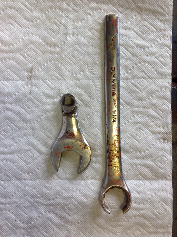

Today i got a low charge pressure shutdown about the time I smelled hydraulic fluid. The hose from the fan motor to the right rear side of the pump is leaking. Looks hard to get to the pump connection.

The hose from fan to pump has JIC fittings to unscrew from the pump fitting. Raise the cab and place something to lay on across the steering lever panel to the top of the pump (a heavy cardboard, thin plywood, or creeper works great) then reach behind the pump and take to hose off. A fitting may have worked loose or hose reached its life span, there is a lot of heat back in there with the turbo.

Well the hose connection to the pump is easier to turn using Bobcat special tool 000001. If it saturday when the dealer is closed and if NAPA is out of this tool then you can get the pieces at a pawn shop. A Chinese 1-1/4 wrench, and a 1/2 drive socket, welded into a long shank crowfoot. It would be a sin to do this to a USA tool. I removed the fuel filler hose and fill opening, then it was a straight shot to get to the connection with tool 000001 and a 24" extension, ratchet.
Tool on the left is 000001. The tool on the right is Bobcat special tool 000002, which did not fit well.
