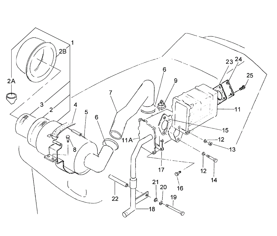

I have the warning light on my T1510 tractor. I know it has to do with the air filter and I replaced it but the light did not turn off. Tried disconnecting the battery for a day and no help. Is there some sort of reset or am I missing something here? Any help would be much appreciated.

Check the air box for the sensor. I believe there is a reset button on the sensor.
   / T1510 Warning Light
Any idea where about the sensor would be located on the air box?
   / T1510 Warning Light #4
I'm not sure in that tractor in particular and the parts diagram over at Messicks doesn't seem to be very clear either.
Should be the part #9 on this diagram.
Thanks, I will take a look at it this weekend. Really appreciate the help.
Update: After checking everything over and not finding any type of reset for the light I wanted to take a look behind the dash to check on some other stuff and when I got back there I found a nest of some sort. Quickly saw the wire harness wires damaged. Looks like the harness feeds the warning lights. I cleaned out the nest and wiggled around the wire harness then bolted everything back together. Started up the tractor and the light did not come back on. I'm guessing that is my issue with the light.
