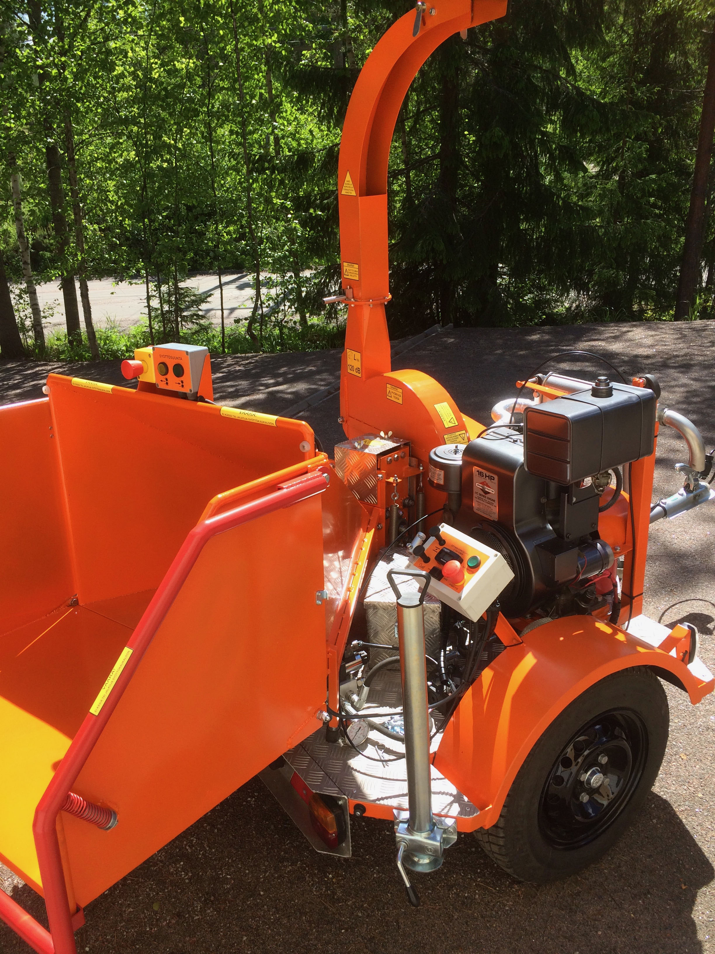

Finally!
I have earlier asked here and on some other forums for advice on chipper feed hydraulics. Now I have finally got my wood chipper made ready - although I am retired it took me over 13 months. The whole project started from this,
and ended up with this towable hydraulic feed chipper

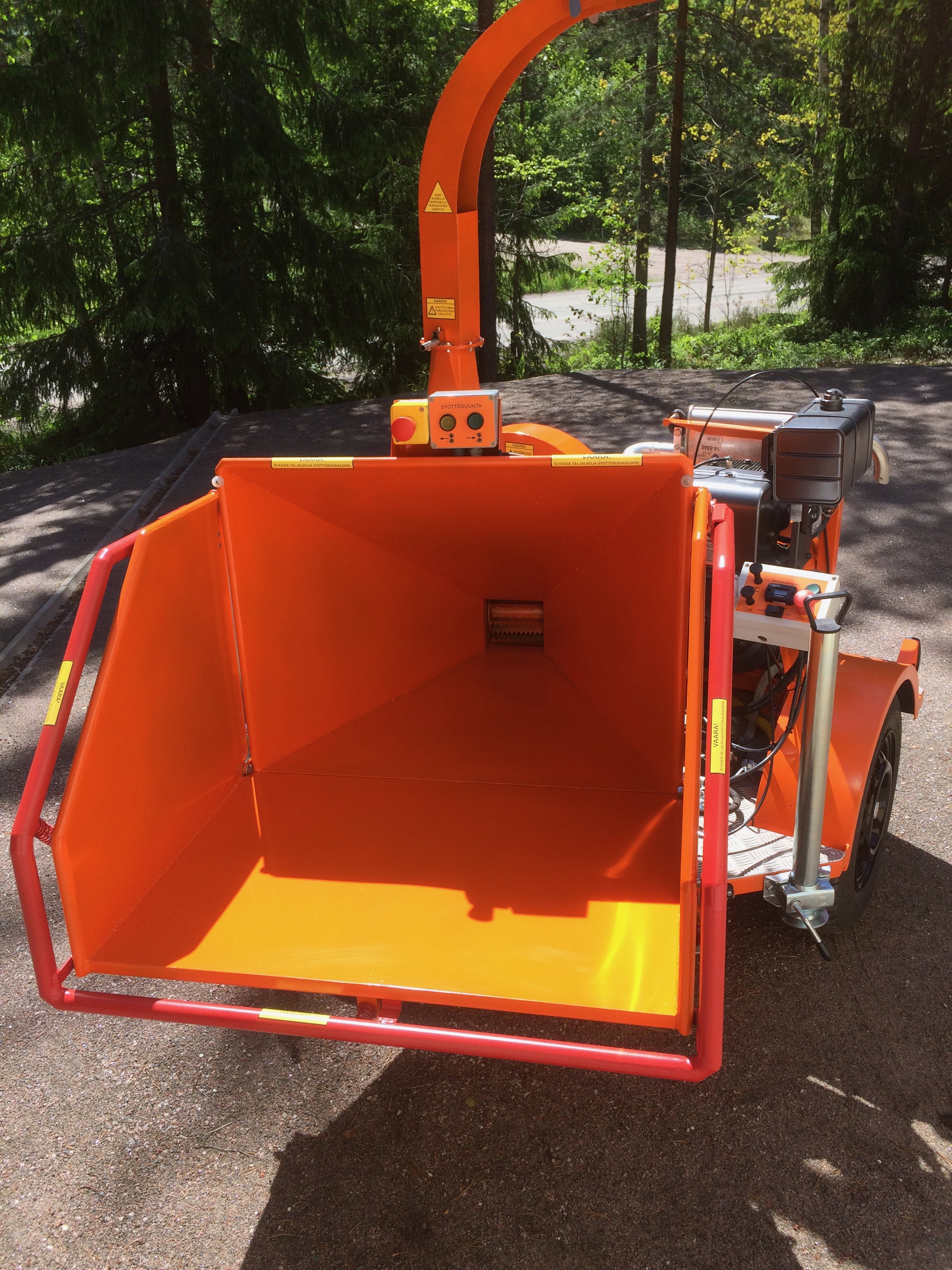

Initially I made the chipper with manual feed but first tests showed that it did not work very well so I decided to redesign it to hydraulic feed. As I had to buy the hydraulic parts as new the whole project budget was doubled.

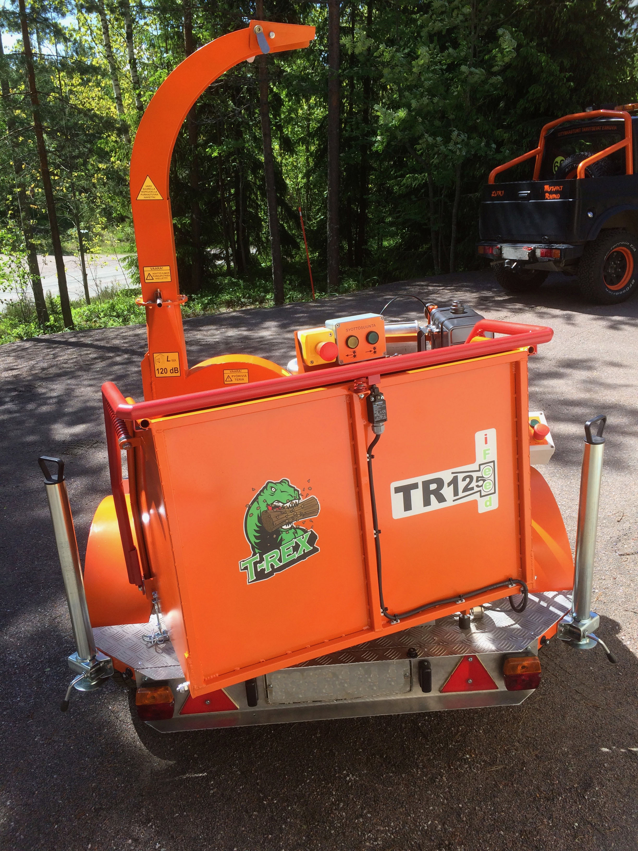

The chipper is powered by a 16hp Briggs&Stratton cast iron engine from 1979. The axle and frame is from a old homemade trailer from 1980. The chipping wheel diameter is 500mm and thickness 20mm and fitted with two chipping blades. The weight is about 32 kg and it rotates at 1 300 rpm. The engine axle has a centrifugal clutch with two V-belt groves with diameter 90mm. The chipping wheel pulley diameter is 180mm. The hydraulic pump with a flow of 7,4 L/min. is also driven from the chipping wheel axle.
The infeed rollers are driven by 250ccm gerotor motors. The direction of the motors are controlled by two solenoid valves. A flow divider is also fitted to make it possible to adjust the infeed roller speed. Additionally an Arduino microcontroller is via an inductive sensor fitted to read the chipper wheel speed. If too heavy load is applied and the chipper wheel speed drops below a set rpm value the microcontoller cuts voltage to the infeed roller solenoids until the chipper wheel gains enough rpm again. The chipper is capable to chip wood up to a diameter of 125mm.
The feed table edge to indeed rollers is 1 250mm to meet CE safety regulations. An infeed cutoff bar is fitted around the feed table edges. Emergency stop switches are fitted above the infeed and on the control panel. The chipper wheel housing cover is also fitted with a safety switch.
The towable chipper trailer base is re-registered as a towable machine and it is now allowed to tow it on public roads. The total weight of the chipper is 380kg.

Wow that is really well done. How fast does it feed?
The maximum design feed speed is about 18,2 m/min. The flow regulator is however now set on maybe a little over half the range so it should be around 10 m/min.
There is actually four things that can be adjusted to get optimum performance,
- the engine speed - now set to about 2 700 - 2 800 rpm
- the hydraulic pressure - now set to 80 bar
- the setting of the flow regulator - now set to about 60% flow
- the Arduino micro controller feed control software - the chipper wheel runs at 1 300 rpm, too hard feed rate warning at about 1 100 rpm, feed interrupted at 1 000 rpm
As I get more experience how the chipper works I will probably adjust some of the settings.
