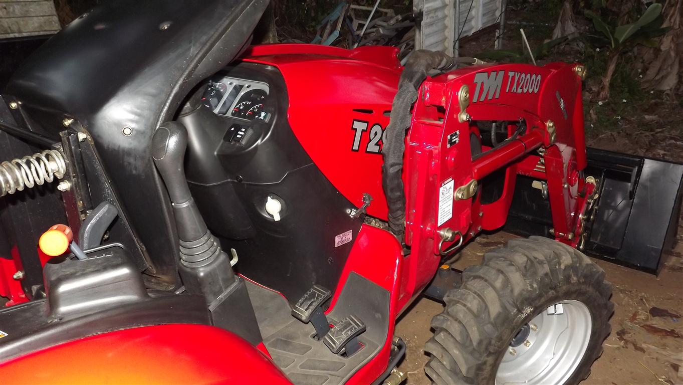

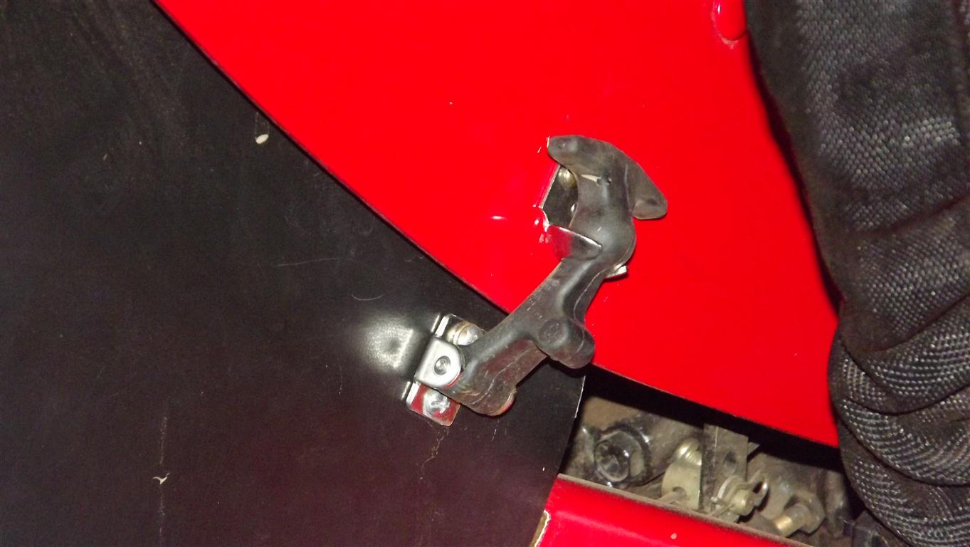

Look in local stores for the rubber latches with no luck, found a pair of rubber latches for marine applications similar to yours in the internet and bought them,I installed them this afternoon they look (much better than the bungee cords)and work great.
Can you post some pics of the hood hold downs and how they are mounted to the tractor??
Thanks!
/ T-233 Owner #23
Here is a couple of pictures taken when already dark using the flash.I use the loader a lot today without any inconvenience.
/ T-233 Owner
#24
Thanks victormh!
Good job! You installed yours where I was planning to place mine. Any problems or interference on the inside of the dash support upright?
/ T-233 Owner #25
No, there is plenty of space to deal with the screws and nuts, I cut the extra lenght of the screws at the hood side so they don't come in contact with the dash support when you close it.
