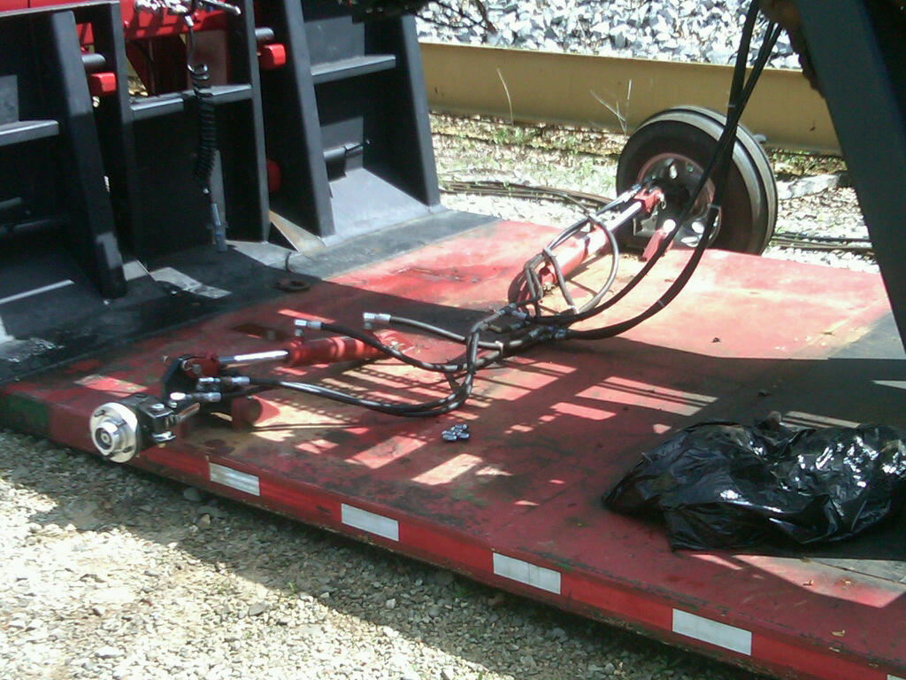

If you're familiar with a tractor pulling sled, these tires are on the front of it. They lift the front of the pan as the sled goes back down the track to the start line. This picture isn't the best but will give you an idea. Part of the catch here is that the tires fold all the way up going when it's being pulled. A tie rod could be made to work but would be a little tricky and one more thing to trip over.
Lots of other sleds use a setup basically identical to this, that's why I feel sure it will work as I get the details figured out. It's almost always on level, relatively smooth ground and speeds are 10 mph tops. Most of the steering will be minor corrective steering just to keep the sled straight.

thanks for the picture, now I understand what you are trying to do!
Unfortunately with that setup a master/slave won't work at all unless you move both cylinders to the same side of the pivot point (I.E. in front of or behind).
Flow dividers should work with it set up as is since both cylinders retract for left and extend for right. it will just turn faster to the left and to the right with more force. which isn't a cancern, alot of tractors have the same turn characteristics.
my question now is do flow dividers work in reverse too? as in to combine equally 2 input flows? if not will they allow flow in the opposite direction at all?

Be careful with a flow divider. Due to tolerances and differences in leakage, they WILL slowly get out of sync. In a well designed circuit, one or more additional valves are needed to re-sync the cylinders. Additionally in many cases with some small error, a flow divider can generate excessively high pressures, so additional relief valves are also generally recommended. Bottom line is that it can get complicated quickly with a flow divider.

all of the ones i know about require two for this function however sun hydraulics makes a valve to do this with eliminating the need for the the two gerotor flow dividers. if you go with the gerotor you can still "t" in the inlets and use the outlets to cross connect the cylinders keeping the steering turns even

Well everything is working like it should after the flow dividers were installed today. The cylinders work together so my steering appears to be up and running. Thanks to everyone who helped with this.
