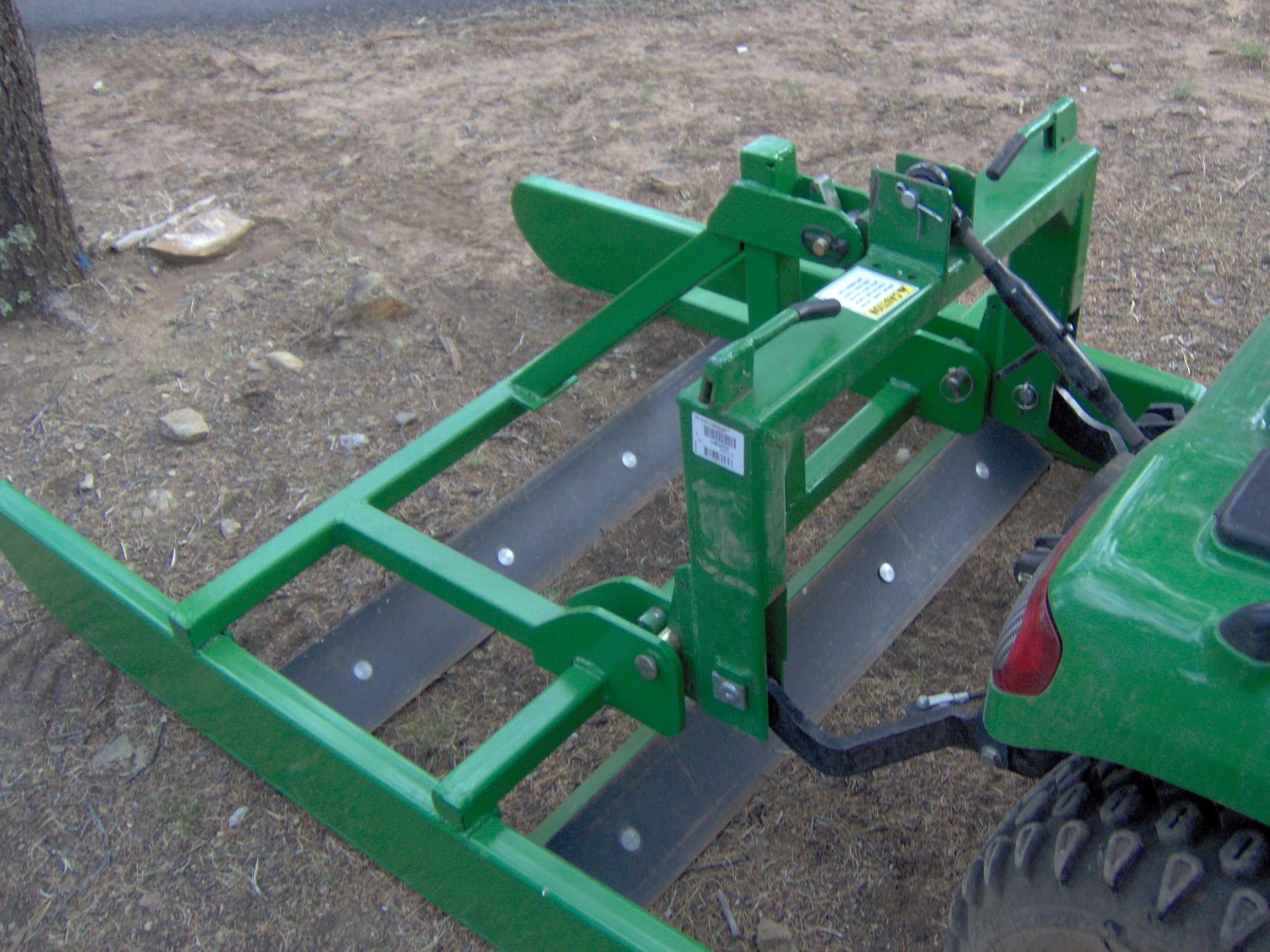

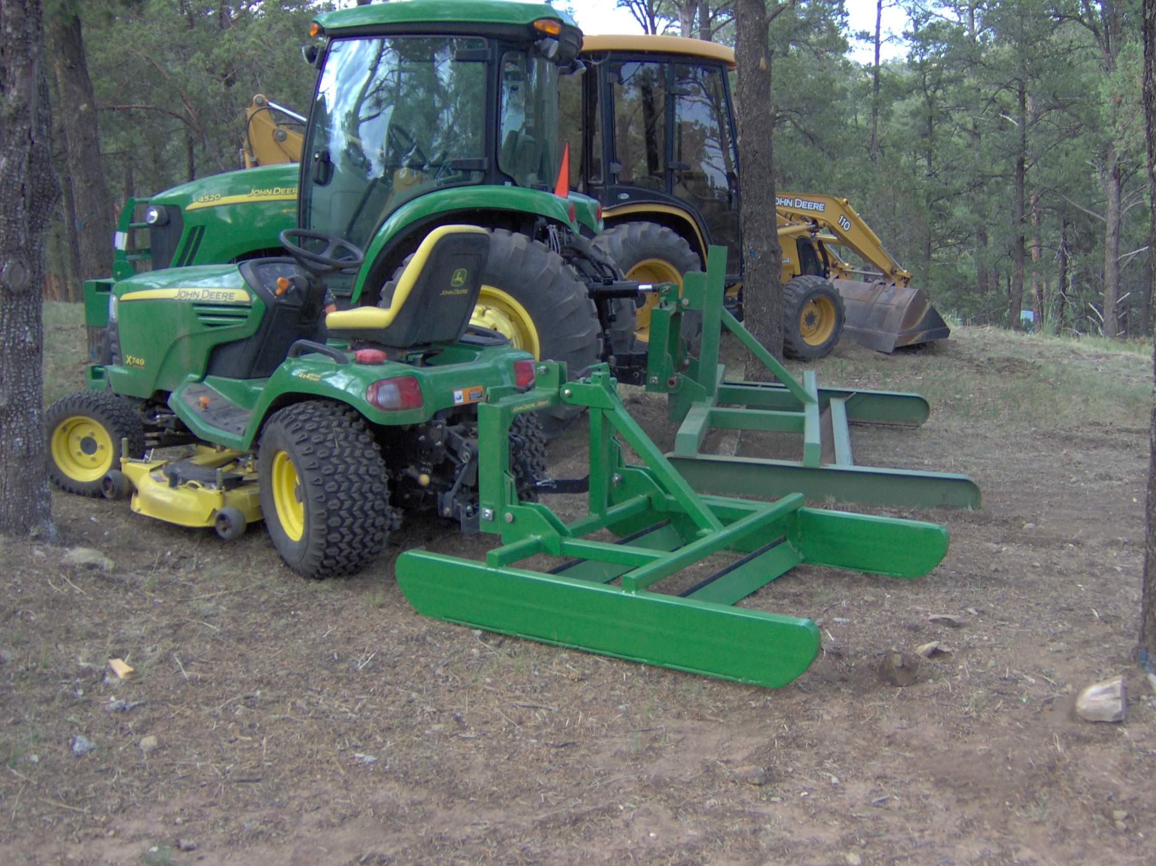

I think you might be money ahead with a small landplane for driveway maintenance. I built this one last year for my x749 and should be just right for a BX25.
