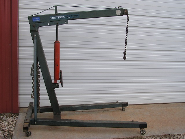

In the past I have used my shop crane to move a wheel and tire to the other side.

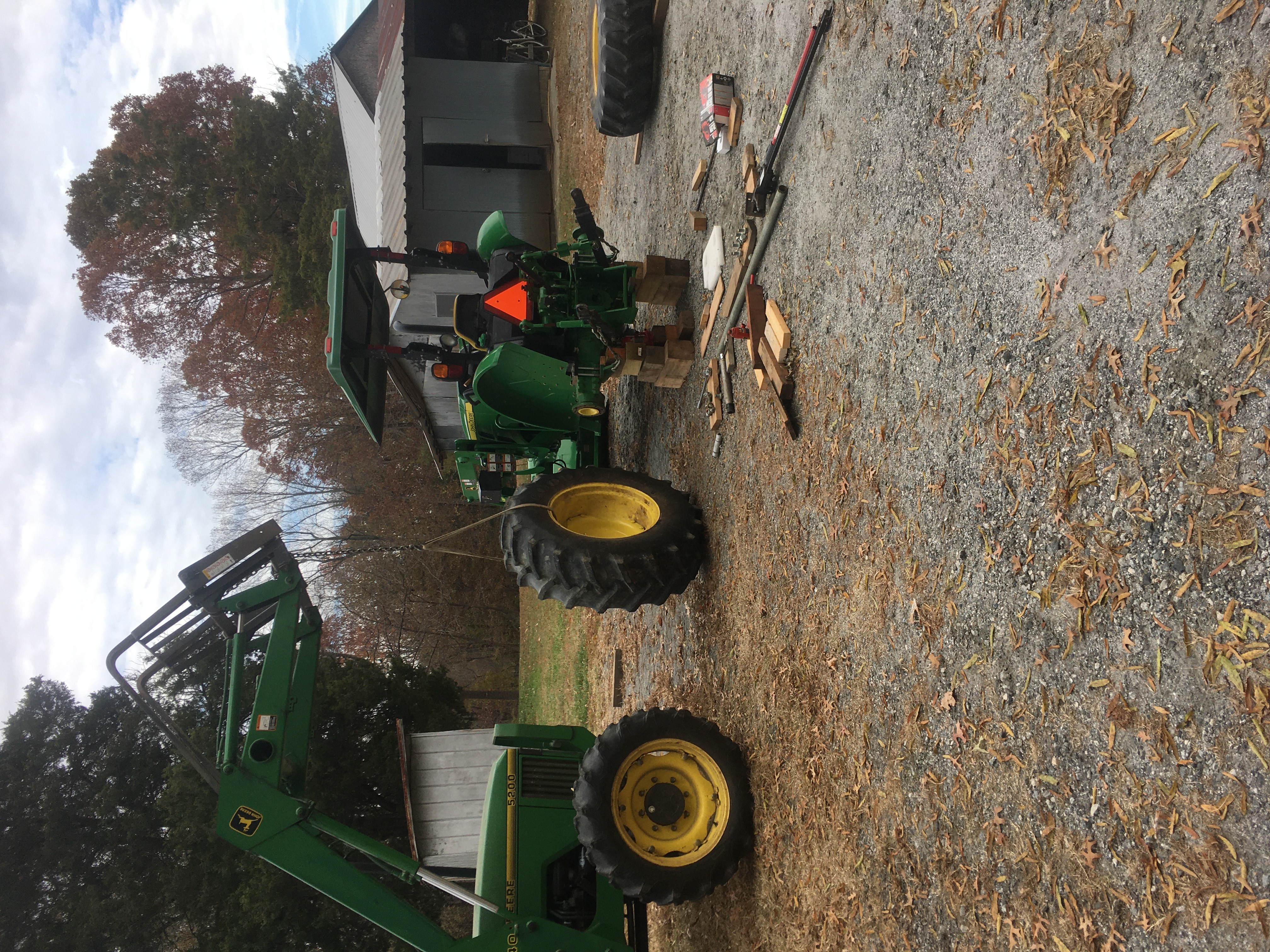

I just did this. Swapped liquid loaded tires side to side. 700 pounds of liquid in each tire. Break loose wheel bolts on both sides first. I needed a 6 foot cheater on the wrench. Then jack onto Wood blocking. No 2x4s or concrete blocks... 6x6 or better. You want as wide and stable as possible. Block the tractor till you see daylight between the tire and ground. You'll need clearance to remount the tire. A strap and another FEL to handle the wheels. To rotate the wheel to match the hub, simply rest the wheel on the ground, and push the strap opposite the rotation you want. When you lift, the wheel will rotate a degree or so. It takes a few tries, but works well enough to do single handled. There was too much drag to turn the axles through the diff.

I did 16.9 x 28 R1s. I bought the correct size bolt, but much longer, cut the head off, then ground the shank to a point for a line up pin. I also cut a cross slot on the end so I could us a screw driver to remove.
Install at 12 o'clock. Then work the wheel tire in place. Have the axle flange a little low so the wheel tire leans in as it goes on. Slowly jack the axle up and as wheel tire be comes straight up/down start the bolts. Get a few in and remove the line up bolt.
Be sure to retorque after a few hours use.
