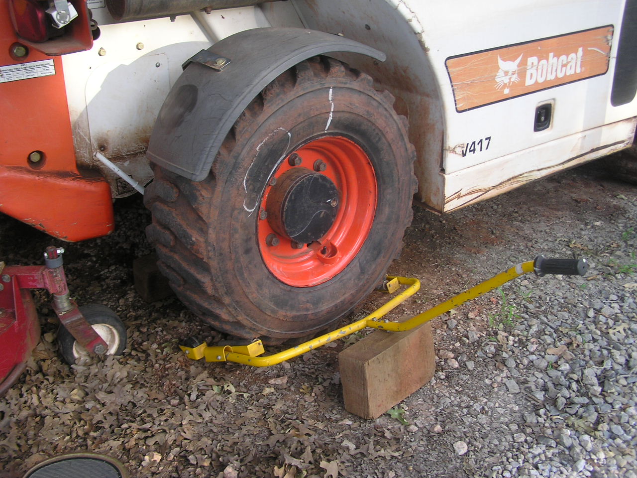

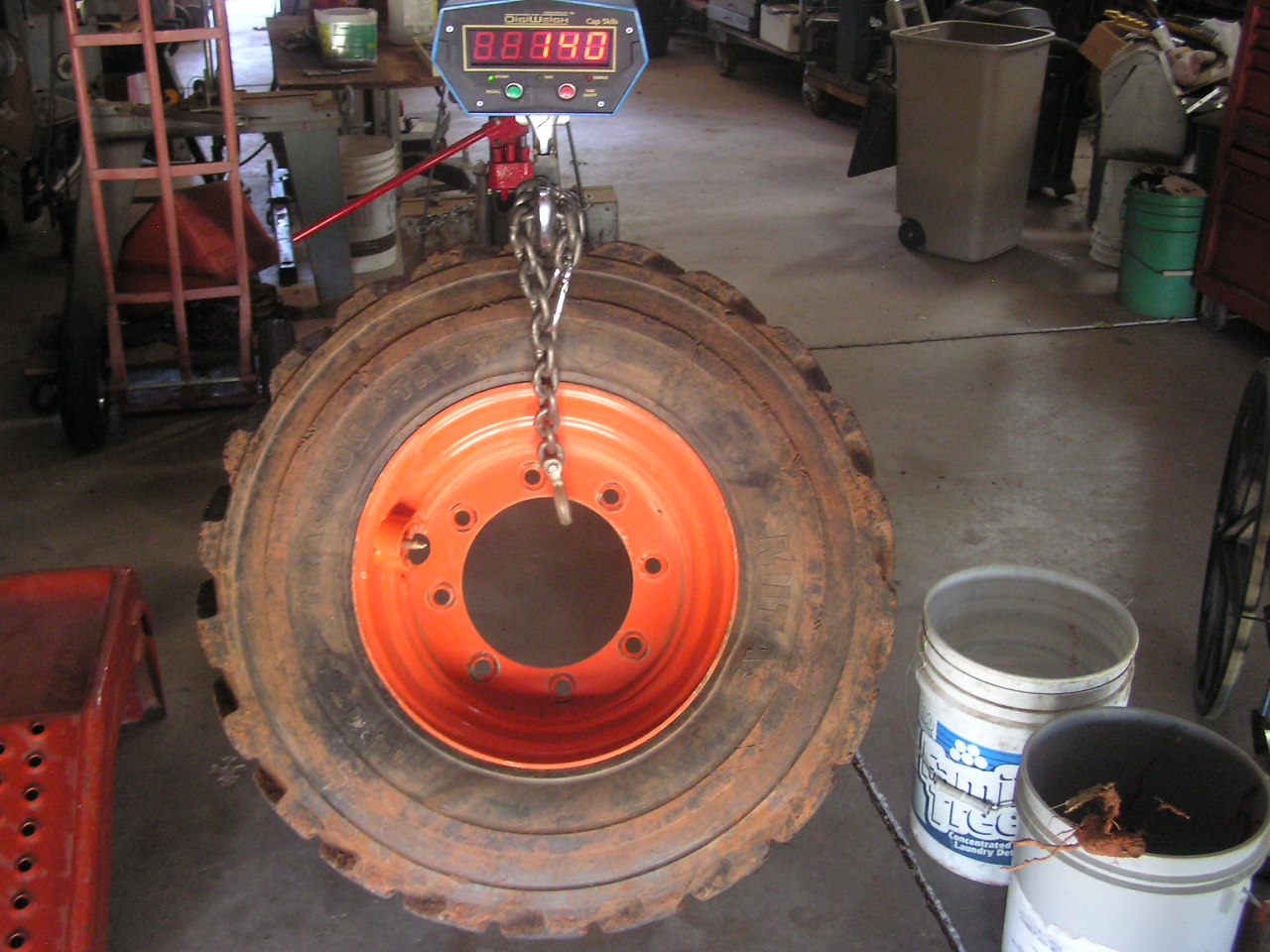

This is what I use on the 140 pound, 14-17.5, V417 tire and wheel:
