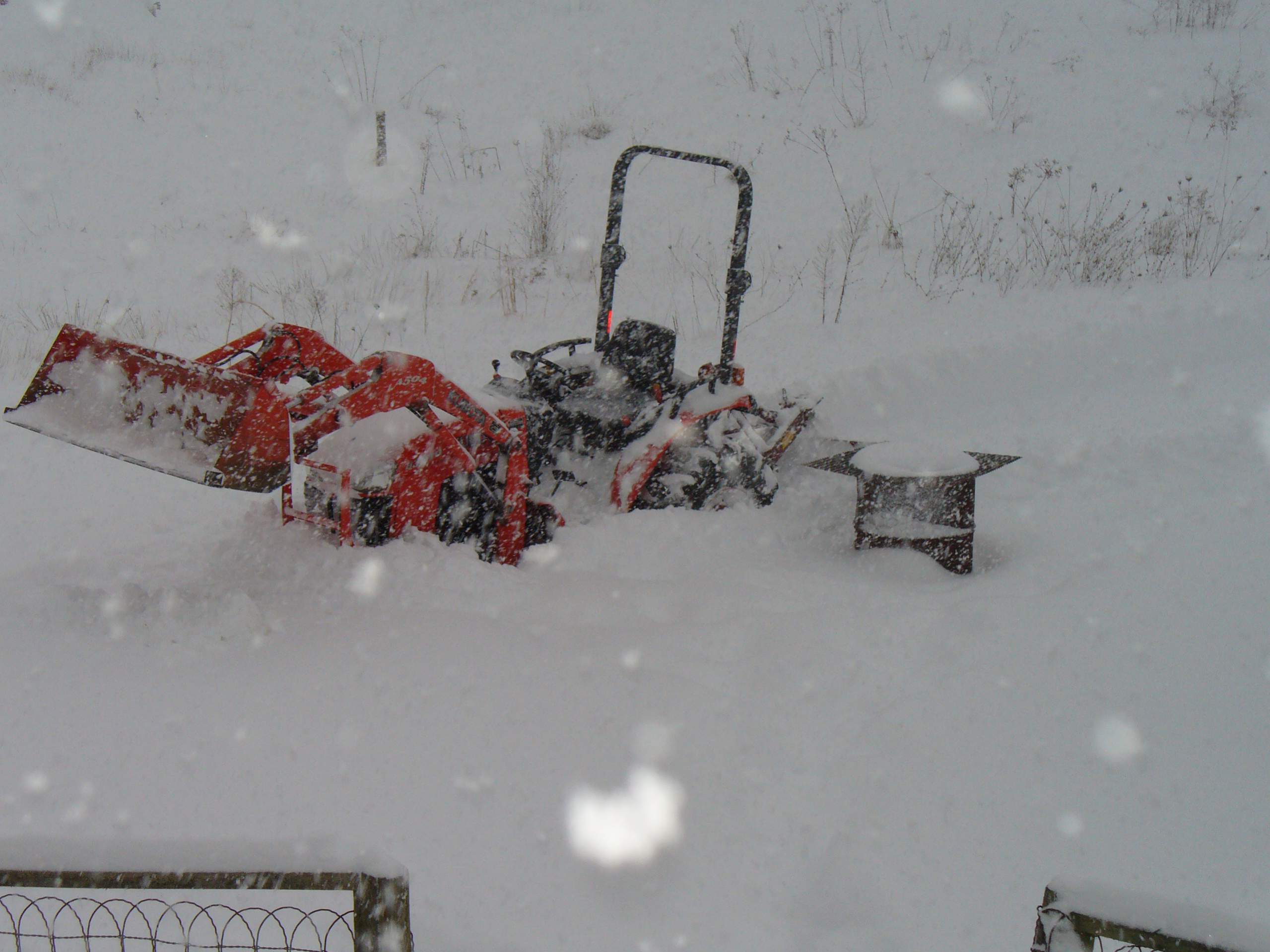

After rereading this thread it occurred to me I never updated this on the snow performance. The performance in the snow is probably the biggest improvement of all. With the R4 tires anything more than about 6-8" of snow was very difficult to get through, especially on any kind of grade. The pics below was with 26" of snow. The front R1 tires were completely out of sight but it still churned it's way through, I was amazed.
   / Switched from R4's to R1's on my B3200, review and pics #20
Amazing what theyll do isnt it. ... 3 or 4 yrs ago we had a couple feet of snow accompanied by trees downed on fences. The worst were at the bottom of a 15 degree hill in a narrow field. I had to work on the tree forward; lifting off the fence with grapple, cutting free from stump, and then backing up the hill with it because there was no room to turn around or go past to get on the bottom side. I found that whipping the fronts rapidly left and right enabled me to maintain progress with the 7520. I was surprised to be able in this reduced directional traction condition for the R1s.
... Also, even with the 2 ton FEL lift capability I have never had any problems with the R1s if I just aired them up enuf to prevent excessive squat with the load.
