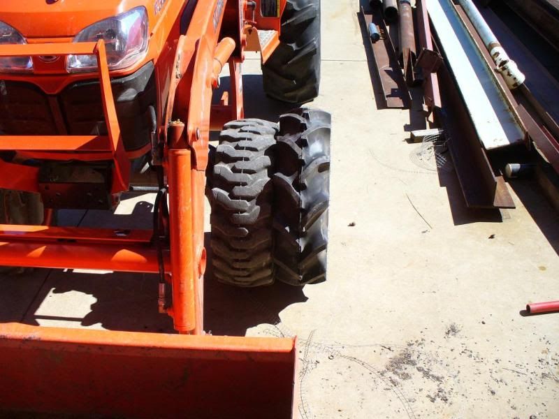

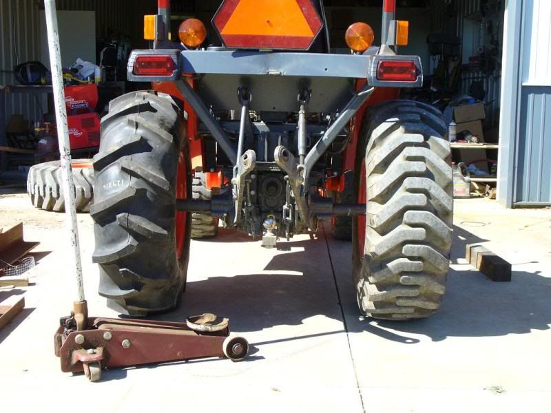

Here's a couple comparisons of the Ags vs the Industrials. As you can see they are a good bit taller, and also a little narrower than the R4s. The fronts are 180/85-12 (7-12) and the rears are 12.4-16

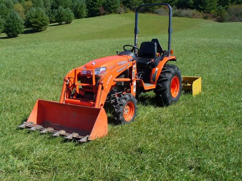

Mounted up:

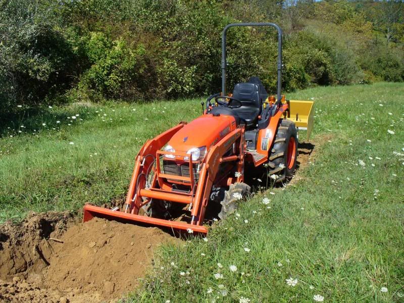

So once I got them on I immediately headed to the back of the farm for a little bit of excavating. I was amazed at how much easier it filled the bucket with these tires vs the R4s. I dug this in less than 5min.

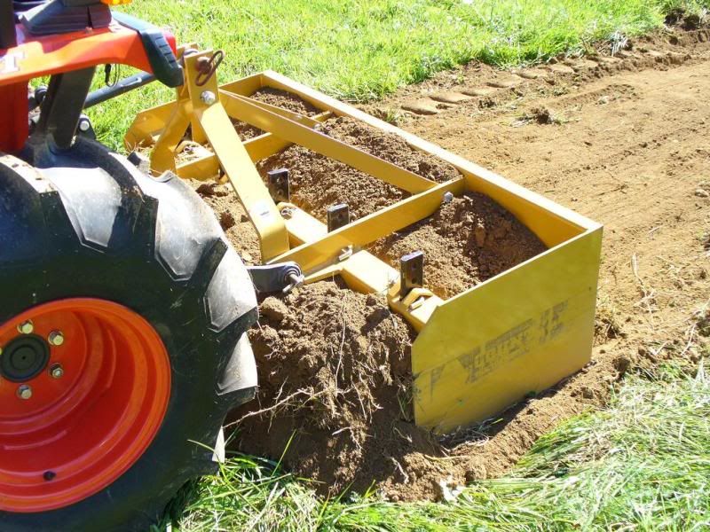

Excellent pulling traction, full load of dirt:

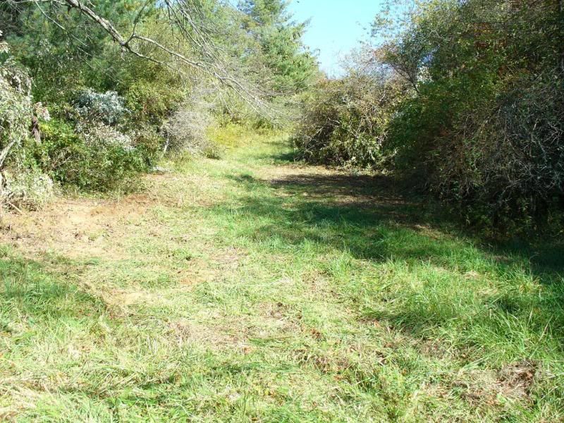

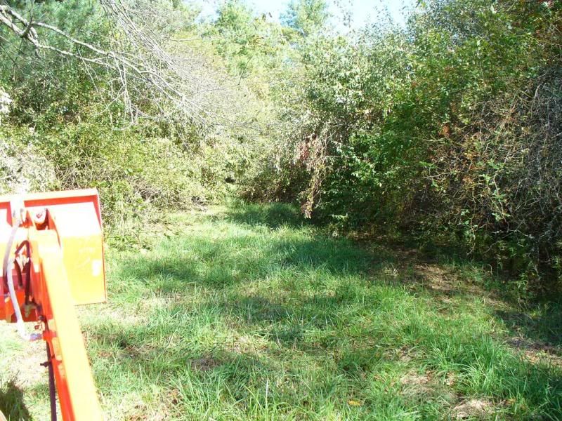

Next I headed back to an overgrown field, pushed out a few small trees and cleaned up the entrance to another field:

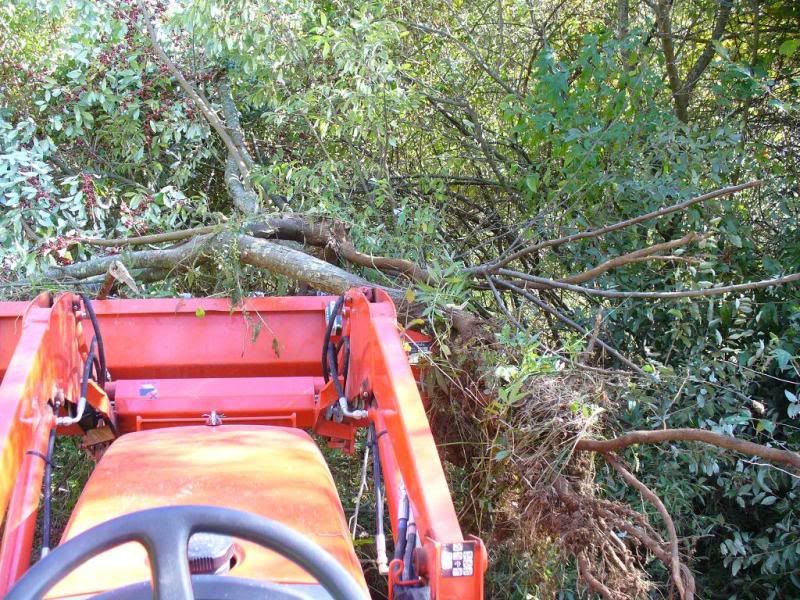

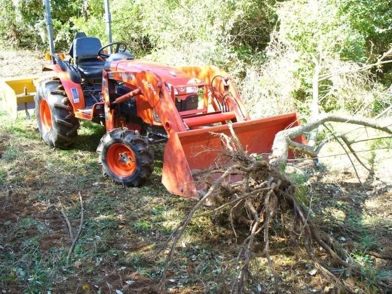

Couple of different trees I up rooted, just took one push about 4-5' up the trunk to get them over, then engaged the teeth in the root ball and pushed them out:
Here's a before and after pic, about 20min later:

With a good floor jack it was easy. Break all the lug nuts loose, then just jack it up to the right height so the tire is barely on the ground. Remove the lug nuts/bolts, lean the wheel out and roll it away. Move the new tire into place adjust the jack, lean it on the studs and install the nuts/bolts. If I had an air impact it would have been even quicker.

Are the fronts load rated high enough for your loader ?
Many are NOT !
The thing I find a little "questionable" is your claim that you can now push over trees - implying that before you couldn't ?
Now a B3200 is still a B3200 and weighs about what a B3200 weighs.
I doubt that it's ability to push over trees just by leaning on them increases THAT MUCH as a function of rear tire pattern.
{saplings, maybe}
What little tree pushing I have done has been with the tractor stationary, i.e. by bringing the bucket down the trunk, not by driving forwards.
When the front of the tractor rears up things are a little more under control this way than if I were driving "over" the tree.
Things can still get "hairy", but I think the risk of forces getting off center are less.
BTW, I can get 43% more ballast in the R4s than in the R1s and they are tougher around roots and rocks - obviously I am not SOLD on ALL the virtues of R1s (-:
