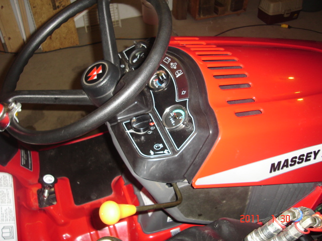

Have you checked with your dealer? Might be more $$, but the ones they used on my 2310 work and seem to be holding up well.
You can see the two switches in the pic, one on either side of the dashboard area. They're both rubber-coated. On mine, the switches were dealer-installed-- they might have them in stock.
