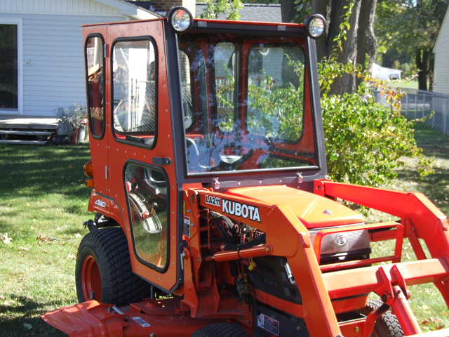

Nice job! Can you tell us where the glass came from? Also, was all the material new or salvaged? The frame looks like 1" square tubing and maybe some angle?
   / Sweet Home built BX Tractor Cab
#23
<font color="blue">Can you tell us where the glass came from? Also, was all the material new or salvaged? The frame looks like 1" square tubing and maybe some angle? </font>
Front windshield was salvaged from an old RV. Side and rear windows are quarter inch 'Lexan'. Door skins, roof and rear panel are made of floor underlayment, primed and painted orange. Frame is 1" square tubing purchased from the local steel supply. .....about $500 in materials. (Labor....priceless /forums/images/graemlins/smirk.gif)
Don

I am interested in the glass and grommets for them .... any suggestions or coaching? What type of glass (shatterproof etc)? How much? From where?
#30
I know the front window was salvaged from an old RV then cut down to size. The sides and rear plastic/lexan. The silver colored grommets are/should be a standard hardware store item.
Don
Edit/update: The screws/grommets are: 1" long stainless steel self tapping screws with matching stainless steel grommets.

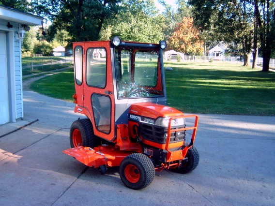

This is an excellent thread to bing back for the start of winter!
I had never seen this cab, it is a fantastic home build!!
After contemplating what it would take to build even a modest cab, this one surpasses anything I have dreamed of.
I suppose lexan could be used all the way around? The molding is an available product, all the RVs use the stuff.
The angles on the cab and the radius corners in the lexan make this a top-shelf cab.

That is a great job, I was looking at aftermarket but i could probably build it cheaper.Is the heat just air from the engine or is there a radiated heater?
#33
The engine is mounted in reverse so the fan actually draws air in through the screen below the steering wheel. There was a plate on the bottom side of the tractor he removed so air could be drawn from underneath and not thru the now enclosed cab area. He covered the intake screen from inside the cab, now monitoring the engine temperature to be sure it was getting enough air to cool and not overheat. He used a small 12volt heater from Harbor Freight and mounted it on the ceiling at the top of the front window. Enough heat to keep the front windshield from fogging up, though not enough heat to plow in shirt sleeves.
Don

This is excellent! I'm looking at doing something similar for my jx95.
