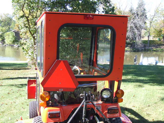

At the bottom of the grill there are 2 plastics just under the battery that you have to remove, so the air will come from there and not from the cab trough the grill.

The floor underlayment that was used is 'Luan'. It's typical use would be to create a smooth surface to install floor covering such as linoleum. This wood product (luan) was used (rather than sheet metal) to create a 'thermal break'. A 'thermal break' meaning, to decrease the amount of 'cold' being transferred to the inside of the cab.
