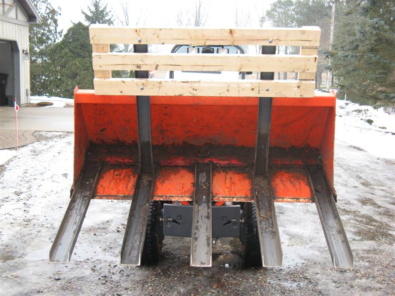

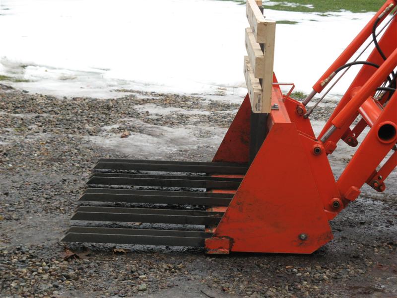

Toolguy, have you got photos (close up) of your forks for your bucket?
I'm looking at making a pair for my 7800 but would like to see different options on attachment ideas. Your's look pretty solid! I have HUGE piles of brush that I will have to move this spring.

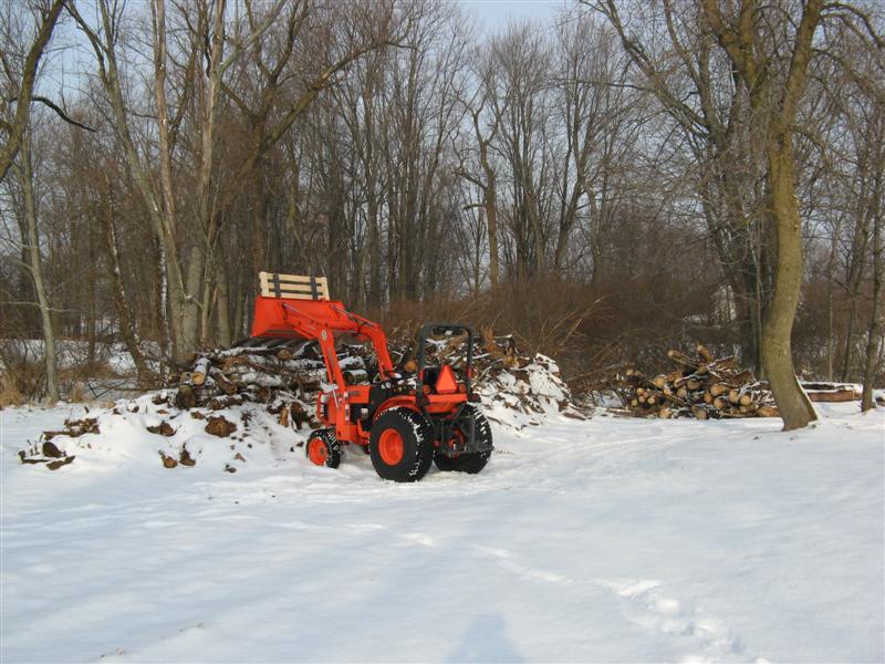

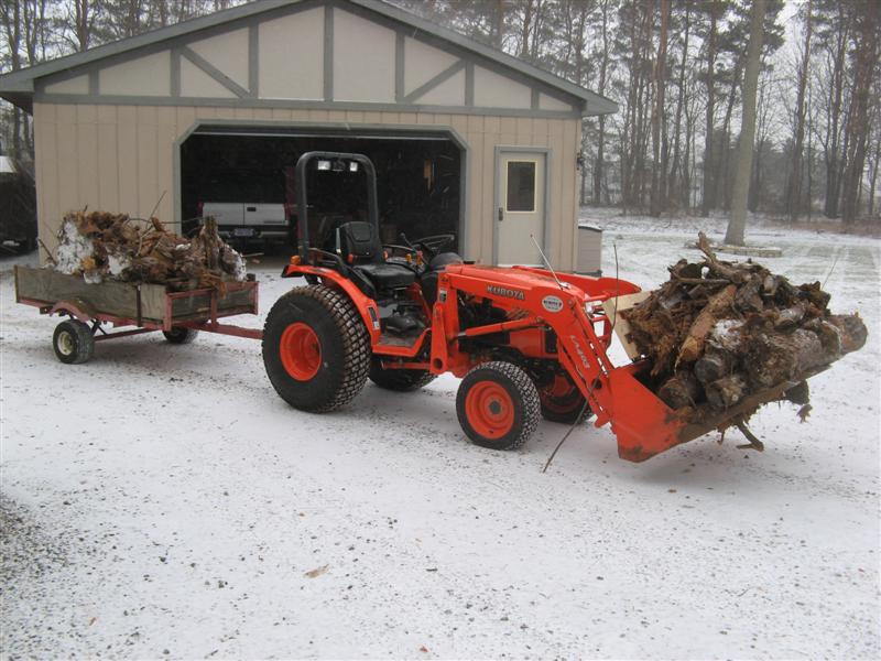

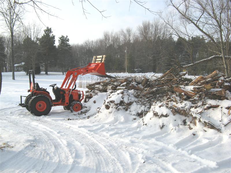

Taiser, The forks are made out of 4" channel iron. Along the back of the bucket I put a 1.5" x 3" tube with tabs welded on the ends and then bolted to the side of the bucket. The channel iron is welded to the tube and bolted to the bucket just behind the cutting edge. The forks extend out from the bucket 24". The uprites are 3" channel and are bolted to the top edge of the bucket with welded on tabs. The 2 x4s along the top of the bucket were a quick way to add more capacity and to keep stuff from falling on the tractor hood. They work good and are lightweight. Some angle iron and expanded metal would look better, though. All the bolts are 7/16". Overall, I think it matches the capacity of the tractor very well. The last pictures shows the burnpile I made from the brush and junk wood behind my house.
