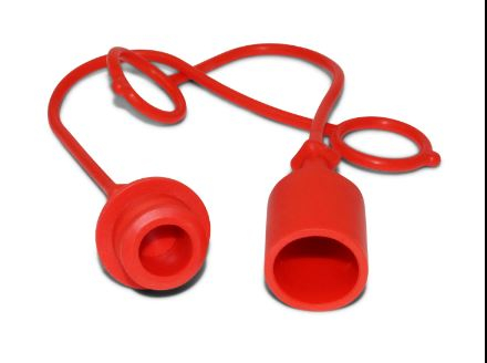

How do you keep dirt out of the connections?
Keep the caps on them.
Caps :dust cap for hyd connector - Image Search
The caps or plugs are nice when they are clean, but after working they are usually filthy. Then my go to is pieces of paper towels stoved in the female connectors. When it's time to connect, pull out the paper towels and a quick rinse with WD or brake cleaner and then a shot to the male connectors and good swipe with a towel, ready to go.
I usually keep paper towels and WD in the cab.

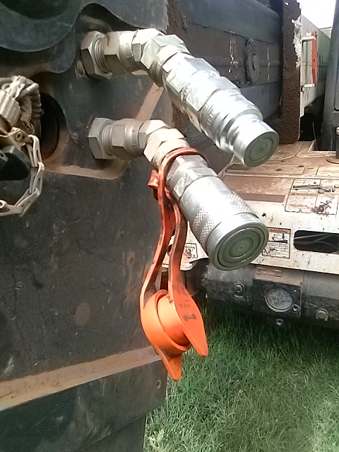

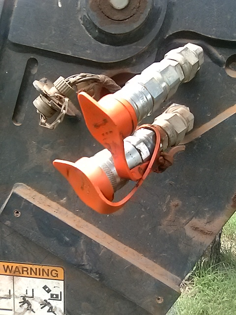

Took pictures of the flat face coupler caps on the V417:
They push together like this:
