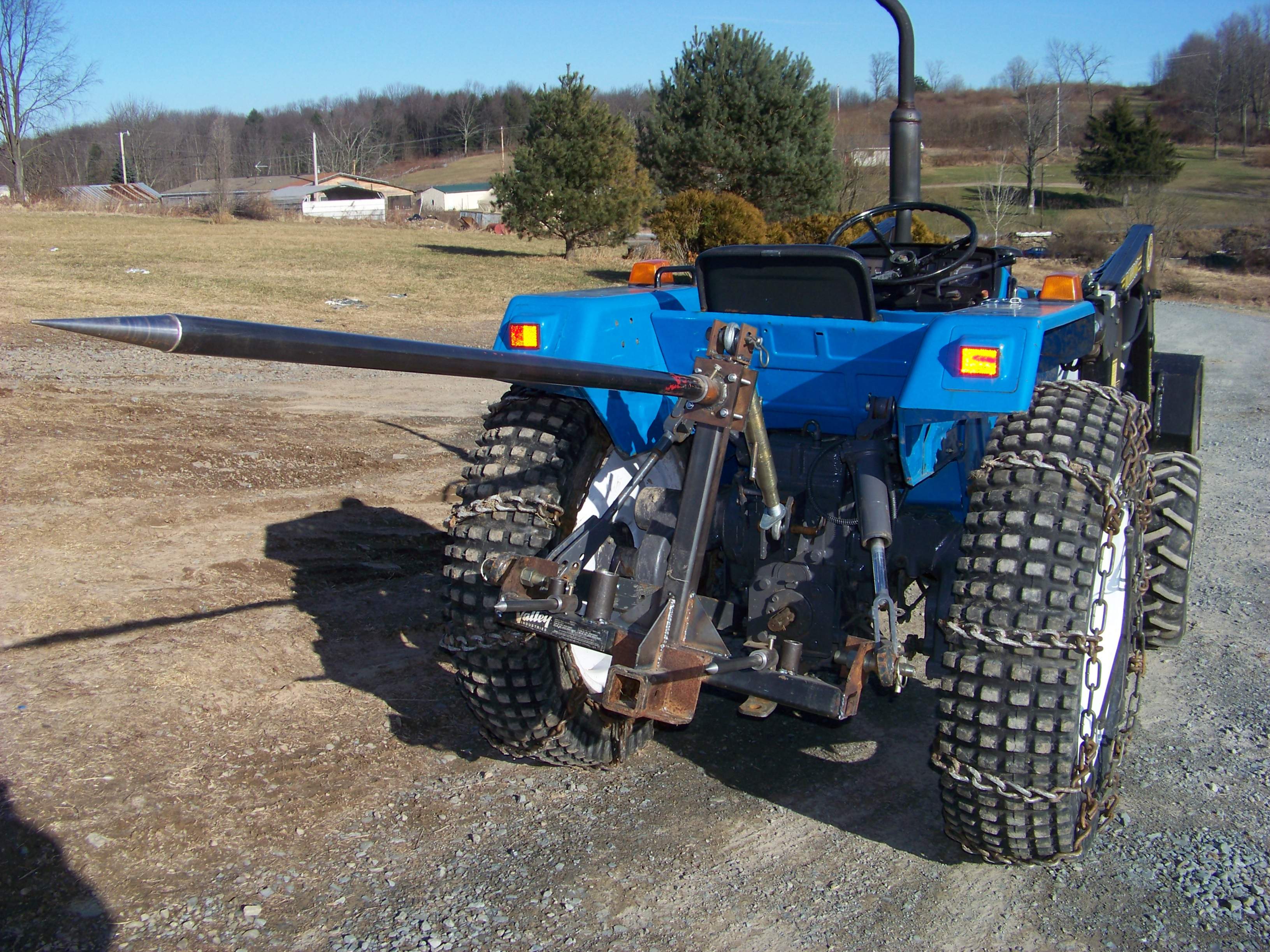

at work I have a Mitsubishi with a loader. I swaped the tires so the dish is out and it works fine . It scares the heck out of me sometimesthis way . I would not want run it again with out the dish out .it has been running for four years so far no problems.
