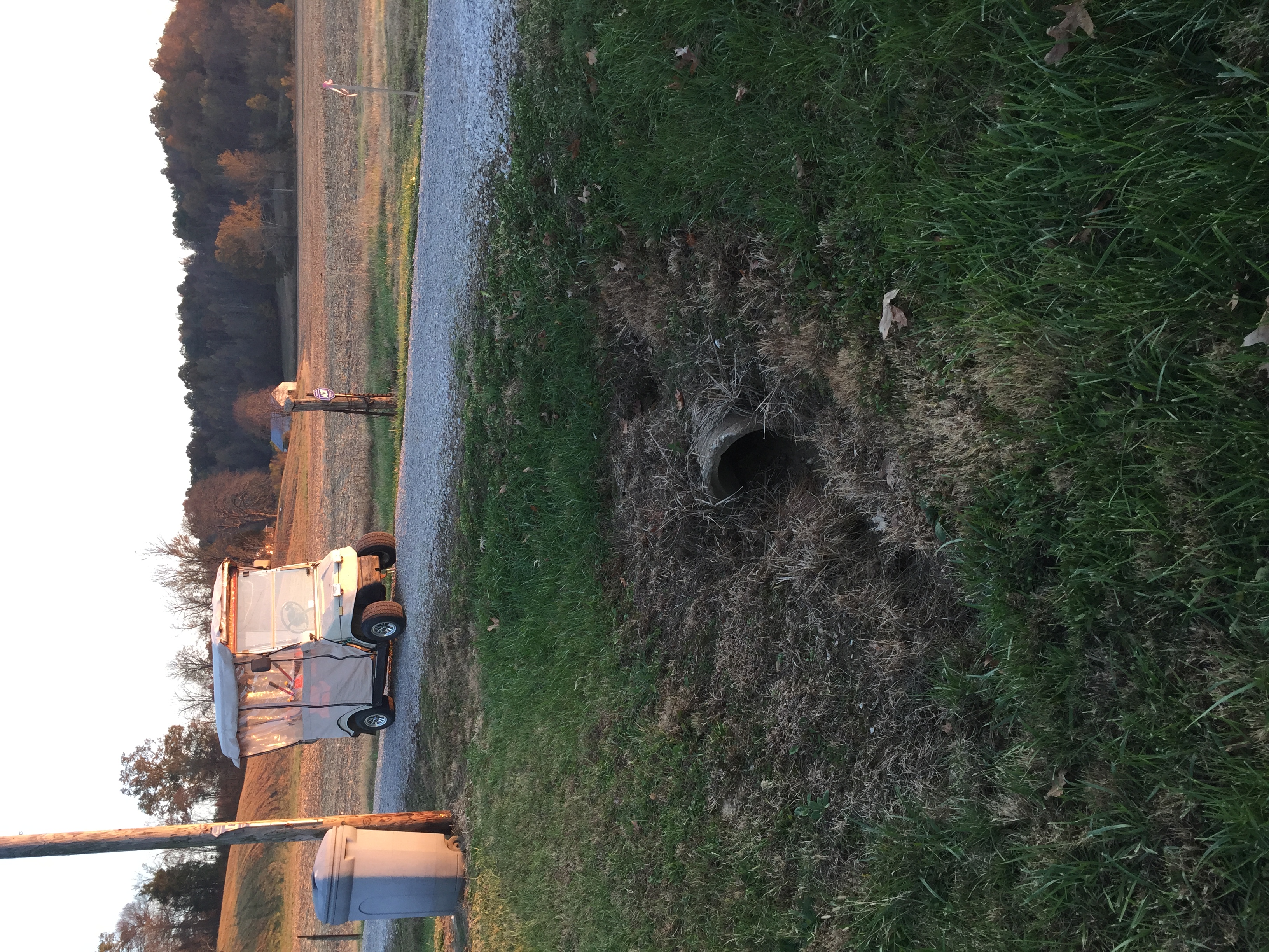

Got a swale by the driveway culvert from the highway to the field to direct water into the culvert.
I would like to fill this and add a vertical drain down to the culvert with a grate over it.
Similar to a riser but for a water meter but 3 feet high and able to percolate water from the sides if possible.
Any suggestions?
Thanks,Mike

Please see the attached picture of the swale I wish to fill
Thanks,Mike

GREAT! So you want to level out the terrain and pump the water out?
   / Swale filling #7
Assuming this is on the high end of the culvert?
I think he is wanting to install a catch basin raising the grade (i.e., riser)...no clue why to allow it to perc water though...
   / Swale filling
What I want is to fill in around a catch basin that will allow water to flow into the culvert.
The culvert end in the picture is the high end so water flows to the other side.
It’s the catch basin I’m wanting to construct.
Sorry I’m having trouble making myself understood.
Thanks,Mike
I was thinking if it let water perk through the sides of the new catch basin it would drain water through the fill as well as surface water entering through a top grate.
   / Swale filling #10
Do you get ice and snow? That can be a game changer when designing such things. Spring thaw and all.
Personally, I am doing something similar and totally unable to find any surplus concrete storm catch basins or cast sewer grates. Frustrating!
