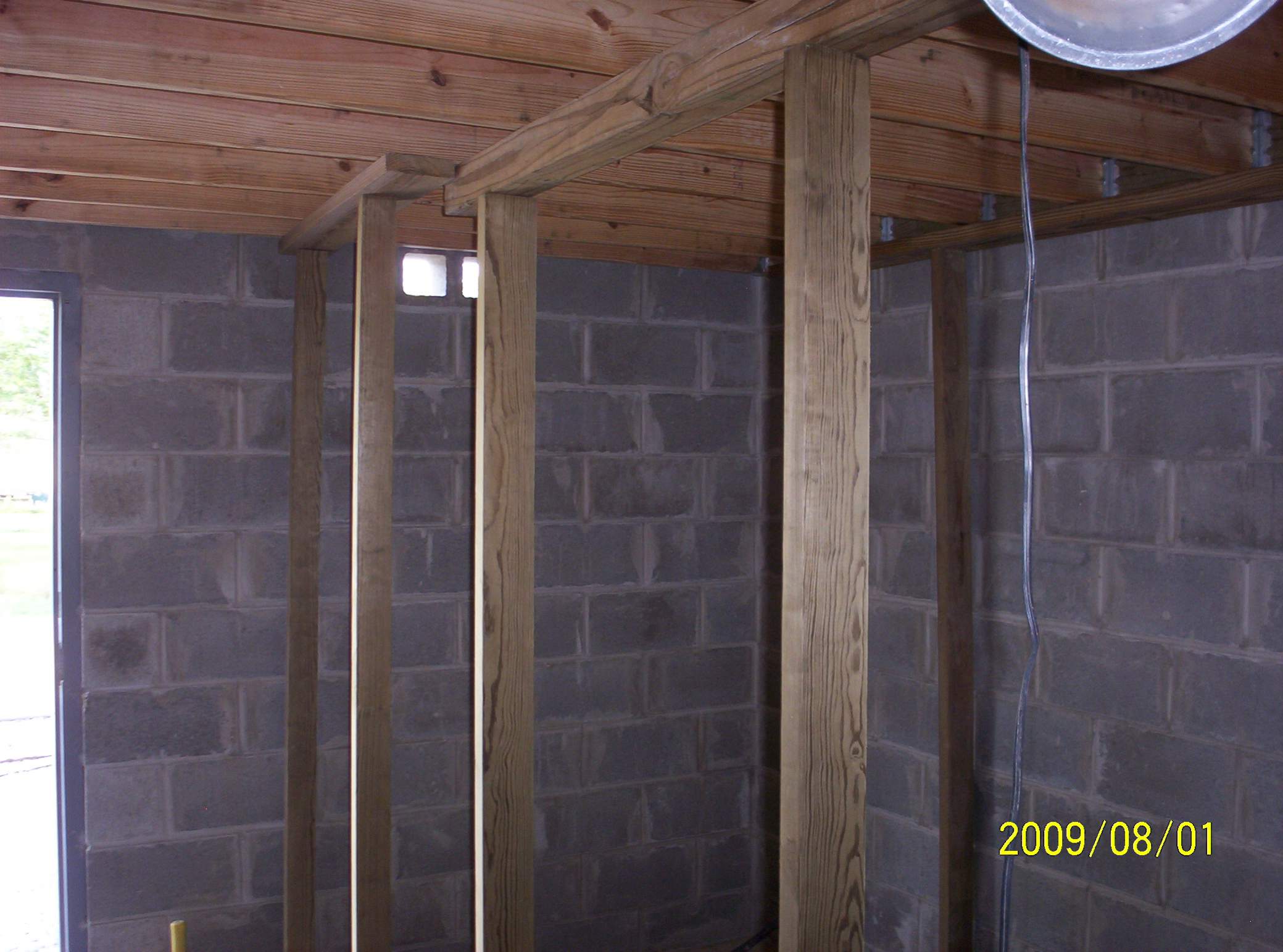

When I put a raised concrete floor in my previous 18x24 shop, I built the floor from I-joist and decked w/ 3/4" plywood. The concrete was not structural, just a 1 1/2" topping on the decking. The floor was built for the dead weight of the concrete in addition to the live loads of floor tools. It was only slightly more expensive that a typical wood floor and gave the characteristics I was looking for, i.e. thermal mass and wear surface.
What loads are you looking at? If you don't intend to drive or otherwise heavily load it, a similar approach may be applicable for you. You really are not spanning that great of a distance.

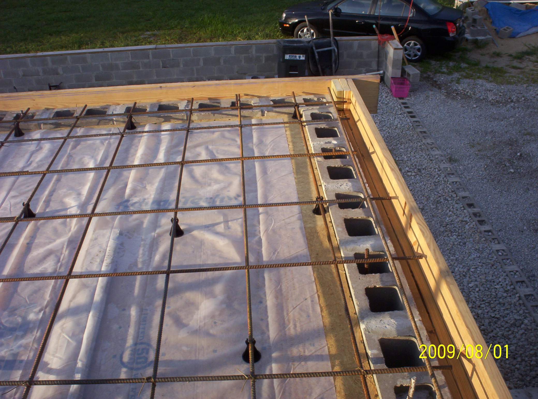

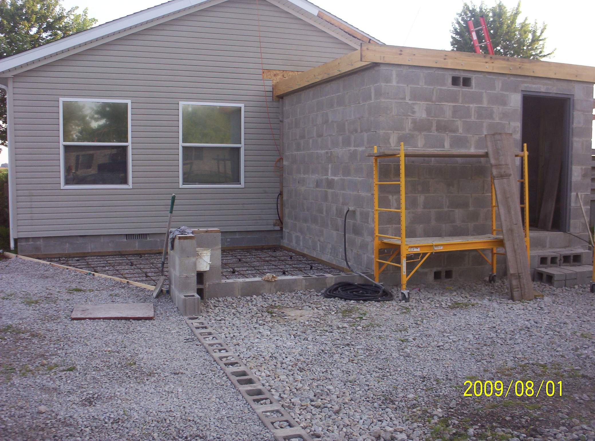

I just installed a new concrete porch 30' x 7' on my son's house 4' above ground level. The previous porch was concrete poured on 26 gauge corrugated metal and from 2 to 3' thick and in perfect condition after 74 years.
We had to tear the old porch out to replace termite eaten sills and joists in the house that had no termite shields on the piers.
We replaced the porch with a 2 1/2 to 3" thickness of 4000 psi concrete set on 26 gauge galvalume R panels. We asked the concrete company to bring some cardboard test cylinders to insure that they did not short the cement in the mix.
I prefer using metal instead of wood for the form decking because the wood will rot out and attract insects.
There will be no heavy loads in a 12 x 24 tool shed and there is no reason a concrete floor 3' high can not be used with sufficient support. My reasoning goes that the thinner and lighter you make the floor the easier it is to support and 5000psi test concrete that is the same thing that the highway department uses in bridges can be reinforced and still be very strong in 3" thicknesses.
