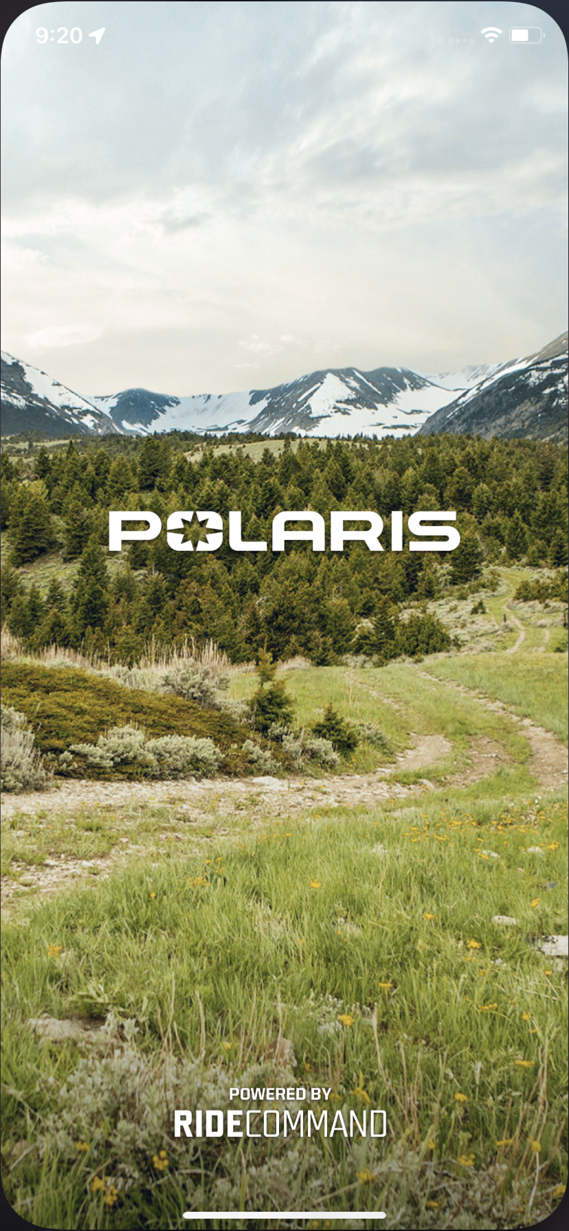

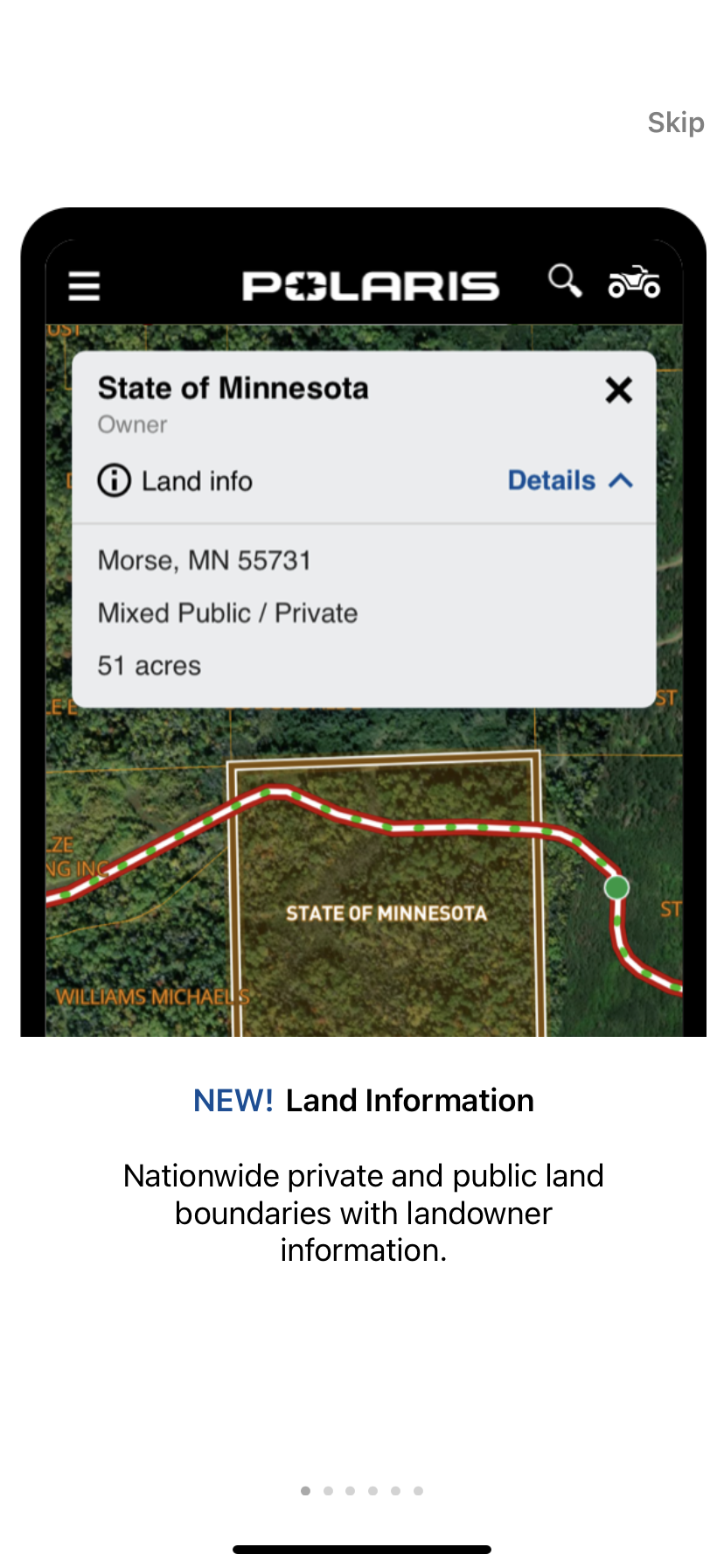

did they give you maps with the survey? … i think with some map, compass, chainsaw, metal detector and a little bit of sweats and determination you should be able to pull it off … there is also the Polaris app it could help you can track your course it is ver clear and there is a new feature to track property line but i haven’t played with it yet.
