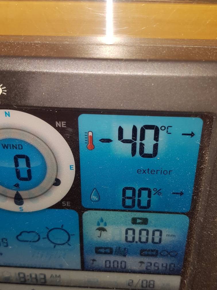

That was on Monday morning and I needed the tractor. Plugged it in for about 3 hours and she fired right up with block heater and transmission heater. 20210208_082309.jpeg

That was on Monday morning and I needed the tractor. Plugged it in for about 3 hours and she fired right up with block heater and transmission heater.View attachment 686087
We have the same weather station. Luckily there was no wind, or was the manometer frozen solid? :eek:
