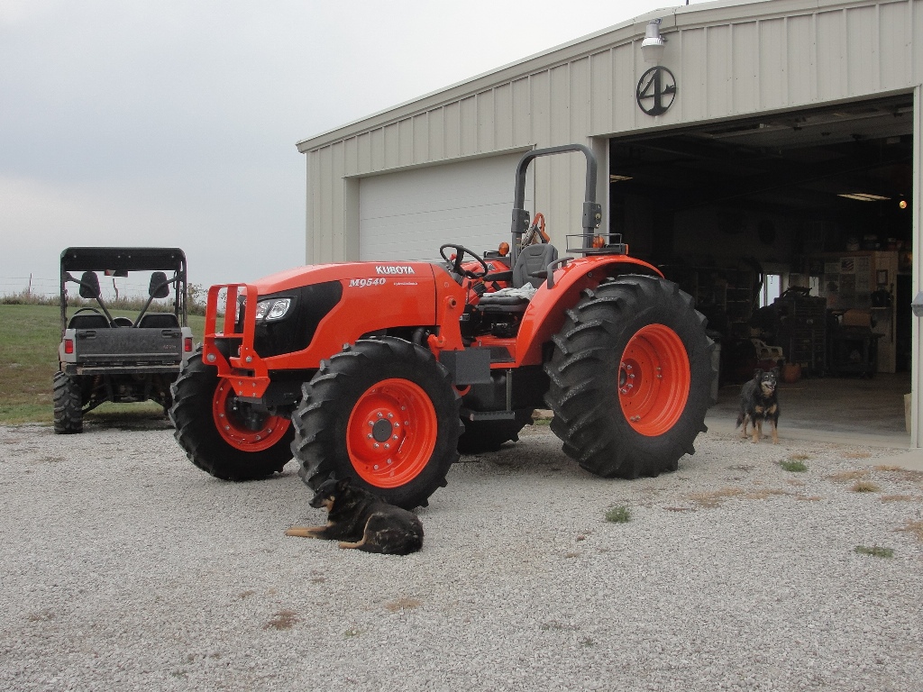

Yeah, I totally agree with that. Not saying throw away your ROPS. Just saying in some cases it's just barely better than none at all. And in the case of my Kubota it will not keep the tractor from rolling onto it's back. It's simply not tall enough to do that. Read an interesting article about the testing process. The ROPS is required to be strong enough to carry the weight of the tractor in a complete roll over. To get that strength mine had to be shortened to it's existing height. Shortening it shortened my lifespan, but it met the governmental requirement of carrying the tractor. Look at this picture and tell me where the "safe zone" is for me as an operator if my tractor rolls over. Draw an imaginary line from the top of the ROPS to the top of my front tire.

And in my case, as I stated above, I realize my Kubota's ROPS will not provide me with a "safe place" to be in a rollover. So I consider it non-existant. I never wear the seatbelt. And I also drive my tractor as if it doesn't have a ROPS, avoiding the chance of rollover religiously. And I'm in steep timber terrain 80% of operation time and countless times have been on 3 wheels.
