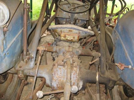

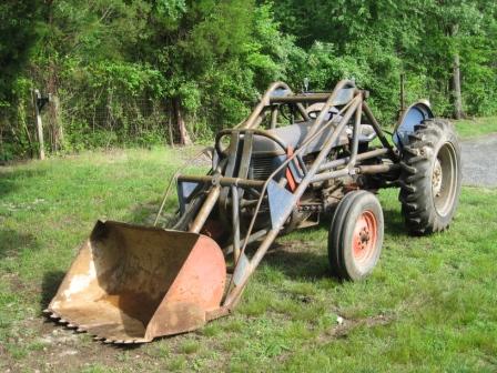

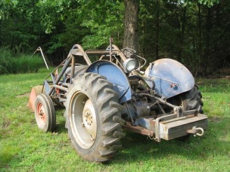

Hey all! I've got a gravity down unit on my 1951 TO20 Harry Ferguson. I think this is close to a 9N. It has hydro dump bucket and does a fair job digging; however, the bucket is not wide enough to offset the earth for the front wheels. The teeth make all the difference. My tractor is hard to steer with a full bucket and the loader connects with 3 bolts up front and 4 in the rear. I have ballasted tires and a 3pt weight to counterbalance. I do not like it as compared to my modern Branson, but I do not think I would ever had bought the new tractor if I had the Fergy first.
