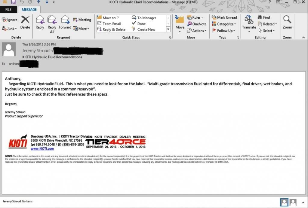

OK, here we go. I talked with Jeremy Stroud (Kioti Product Support Supervisor) today about the Kioti Warranty and which Tractor Hydraulic fluids can be used. I specifically asked about Napa Premium Heavy Duty Tractor Hydraulic and Transmission Fluid. NAPA fluid was given the green light:greenflag::trafficlight:. I was driving when he returned my call, so I did not go into the others. He stated on the call that it must be a multi grade (10W20, 10W30, etc.) hydraulic/transmission fluid rated for finial drive, gears, wet brakes, etc. It must also say common fluid, common sump or common reservoir. I asked him to email me what we talked about, because I was on the road. See the attached email. Jeremy at Kioti was very knowledgeable and helpful. Thank You Jeremy!!!
My thoughts: Single weight oils are not recommend and may void your warranty if the oil is found to be the culprit. The tolerances in these new tractors are tight. It takes time for strait weight oil to warm and thin. Each time this happens you cause small amounts of wear which causes components to fail early.:salute: I hope this helps.
