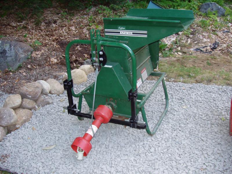

Problem solved.
I took the PTO drive and shaft to a local machine shop, and in less than a day he found the part I needed, created an adapter, and welded it onto the shaft at the proper length.
And it works great. Yesterday I had several little piles just waiting to be turned into chips, and in short order, they were.
Interesting that the local orange and green dealer took 2 days to tell me what a big deal it was going to be to get the PTO fixed (and acted like I was asking them to pass a kidney stone) - then in less than 24 hours at the machine shop, it was fixed and working perfectly at a reasonable price.
Makes me thankful I did not buy a tractor from that dealer, and also thankful that I found a very capable and friendly machinist. Given my track record for breaking stuff, that's sure to be a good contact.
Jay

We also had a heck of a time getting the PTO attached to the tractor. This is a new tractor and the first time that anything was connected, but after lots of filing and grease (elbow and lithium), I was able to get it on and off smoothly, but only in 1 position - if I move it to the next slot it will start on, then bind up. We tried the PTO shaft on another tractor and it went on and off easily. Is it normal (or not abnormal) to have to file the PTO spline on a new tractor? I never had this problem with any of my other machines.
Jay
The connections on the PTO are tight. So when you buy a new tractor, the coat of paint on the PTO shaft makes it close to impossible to attach a PTO driven implement. Once you get the paint off the shaft, the PTO should go on smoothly. I am sure that you have figured that out by now.:)
   / Super Apache 3PH Chipper Questions (long)
#17
I found one place that it goes on smoothly, so now I just line it up that way, et voila! Not sure why that's the case, but don't really care all that much.
I only have a chipper and a snowblower that use the rear PTO, and I can get bpth of them attached without any problems.
Maybe as some of the parts wear a bit, it will go on easier - but if not I can certainly live with it as is.
Jay
