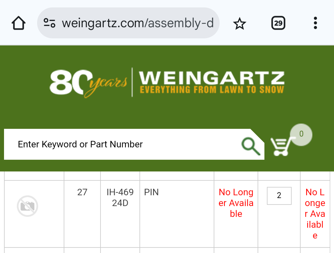

I'm going to say so. What got me was that the weight stuck on the pin. Previous owners ignored it. It eventually wallered the hole for the cotter pin so much that the weight almost had full range of motion.
   / Super A Governor Weight Pin
Looks like the reason the price is so high is due to the pin being discontinued.
