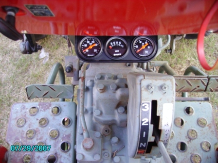

I have sunpro gauges to put on my 3110 .any one that has put them on there tractor what did you use . the nylon tubing or did you get a copper line and put it on. what would be the best.
   / sunpro gauges -3110 #2
I installed the Sunpro on my YM1700 initially using the plastic tubing. After about 6 months it quite working. The tubing had a pin hole in it. I think the vibration cracked it. Go ahead and go with the copper tubing.
   / sunpro gauges -3110 #3
use the copper tubing. I left my lights on. I hate where the oil sensor is on this 3110 just above the oil filter .Kinda in the way

   / sunpro gauges -3110 #5
Did you get them installed? I have a 3000 and have been considering adding some sunpro guages for a while. I would love to see where you installed them and any advice for installing them.
Thanks.
   / sunpro gauges -3110 #6
I cut holes on the dash with a hole saw. I installled them myself. I will try to get a picture and post it. There was plenty of of room on the 1700 on the left side of the dash.
Sydken I have not put them in yet . but I have the copper line to use on it. I am building a trailer right now as soon I get done with it . I will put it on and put some picture on here were I put them.
#9

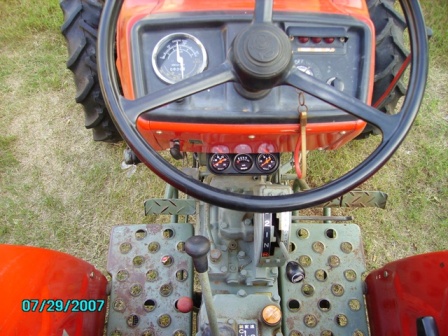

Put the gages on my 3110 today.
