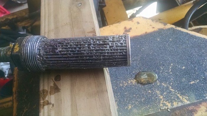

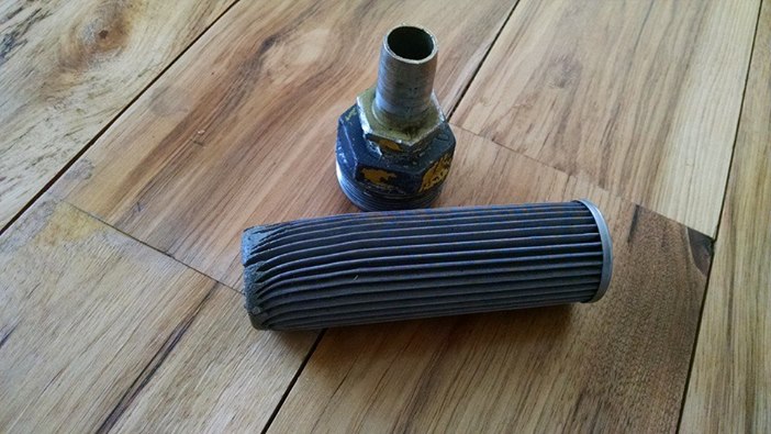

Well i pulled the sump screen and it was pretty clogged on the bottom,... mine is a t4 and i am pretty sure they are the same as the T5. Terramite gives the part number part number EZ-Flow P/N 6942, but i am unable to find anything on the net about it. Is there anywhere that would sell them locally? or cross reference to another screen At frist i thought someone jb welded it together but now i am thinking that is was not supposed to come apert. I am kinda in a hurry I moved the machine over to the wives side of the garage to change the oil and i am pretty sure its going to snow by monday.... 1459159_707681394579_3962599301999893633_n.jpg10978513_707681259849_7068636330559107437_n.jpg

Do a search for a company called flow ezy. They have many different strainers and can even make custom strainers. Check with your local Napa or tractor dealer, they may be able to help as well. If nothing else you could always jb weld that one back together.

That is where i have been looking. the inside of my tank has some sludge on the bottom so i need to clean it out first. I found this one Strainers | MSCDirect.com I am not sure what the mesh size, or gmp should be but this one is the closest. The length is right on at 5.4, but i am not sure if the dia. that the list is it o.d or i.d the o.d of mine is 1.5 but the i.d is 1.0. I guess I will call terramite Monday and see if they will release some info, and not try to sell me a filter for $40+$20 shipping when i can get it for $18 shipped everywhere else.

That strainer looks very similar to those found in hydraulic tank applications. You might get lucky trying out hydraulic equipment suppliers.
