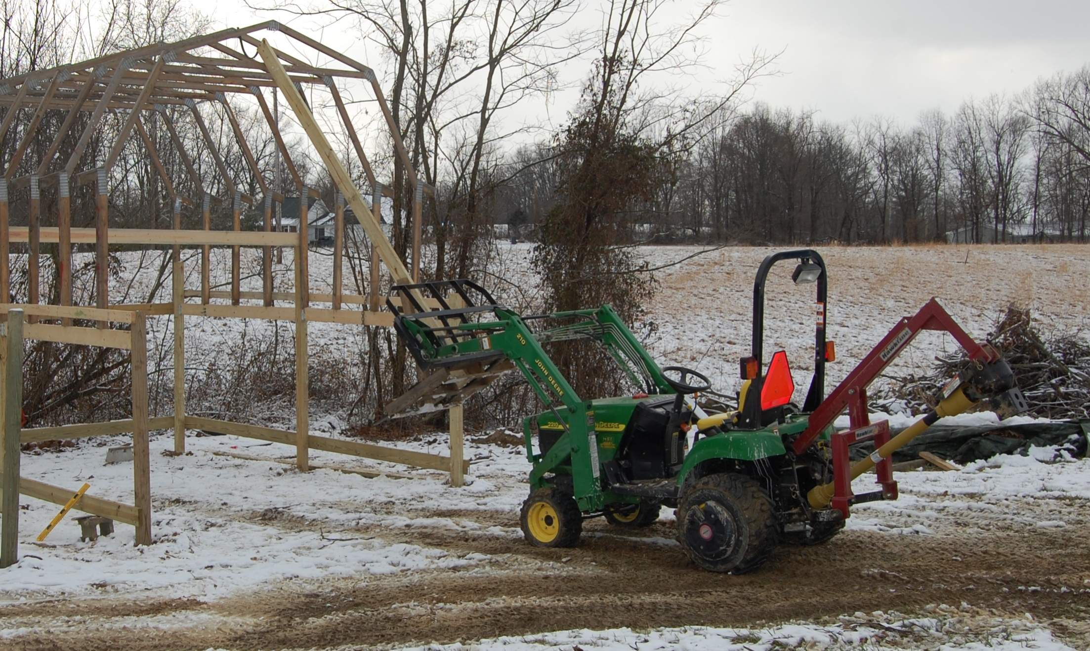

I used a Hawkline PHD on my 2210. It would carry a full size auger and worked well. The tip would drag a little while transporting on some grade changes but never caused a problem.
The biggest issue for mine fitting wasn't the reduced lift height but the smaller distance between the top link and lift arms. This caused the boom to reach very steep angles when fully lifted. Had to remove the top link holder thingy but still had to be carefull because it would hit the metal cross bar if raised fully. Fixed that by drilling an additional hole in the main boom further towards the gear box to put the pivot pin in. You could tell it was a little big for the 3 point but it worked. Dug many a hole with it.
As far as digging depth, it would put the gear box in the ground, so about 4' 6". They make 2' extenders to go deeper if needed. You auger down, disconnect (leaving the auger in the ground), add the extender and keep digging. When finished, you take them off as you bring it up. Only used it on one set of holes and it wasn't as bad as it sounds!
No problems power wise with a 9" and 12" auger in my clay soil.
2210 is gone now and this is the only pic I could find with the PHD attached ( but no auger).
