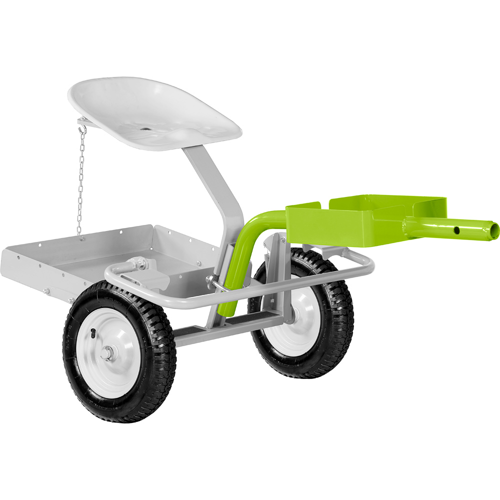

Mounting to the wheels is usually done with post mounts to the wheel hubs similar to the barbell weight posts. Then the sulky is attached to those posts with bearings at the ends of arms. Earth Tools has the design perfected with the one they build.

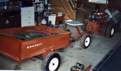

Here's the one on the Gravely that I had. Used it A LOT.
I also put a seat on the cart and used it more or less as a sulky. Sometimes, I put the 2 together.

With the wheel mounted sulky you have to have an implement mounted in order to keep the tractor balanced. If you want to run a sulky with the engine out front, then use a trailer coupler like Earth Tools sells. That locks the tractor to the sulky in a solid connection, allowing for sideways articulation. That's what I use for my sulky and trailer on my BCS, but I don't have a need for the wheel mount design since I don't have a mower.
I can connect the tractor-sulky-trailer-log splitter all hitched as a train. Sometimes I have a large wagon behind the trailer instead of the splitter if hauling lots of cooking or camp gear out to to the fire pit.
