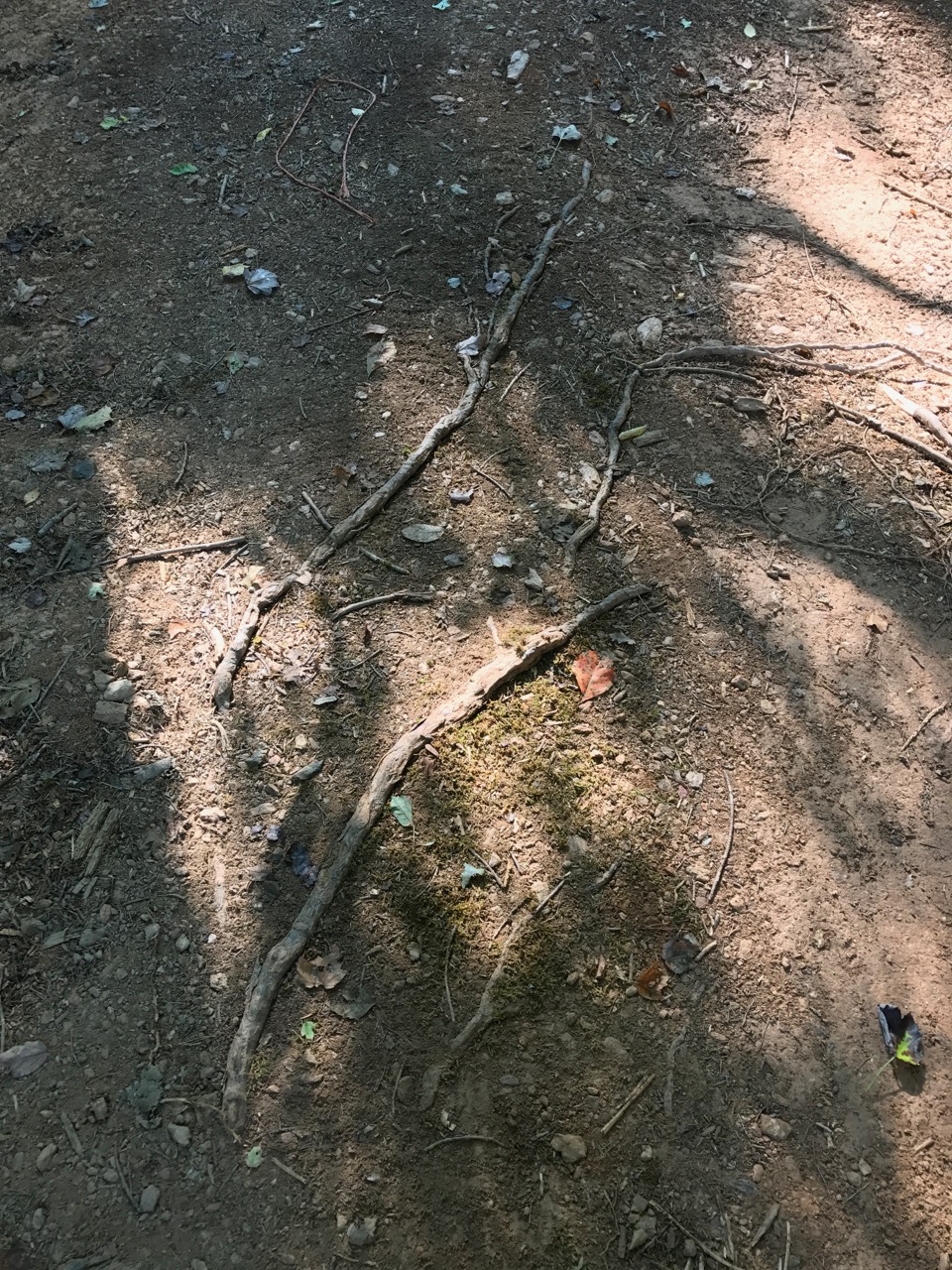

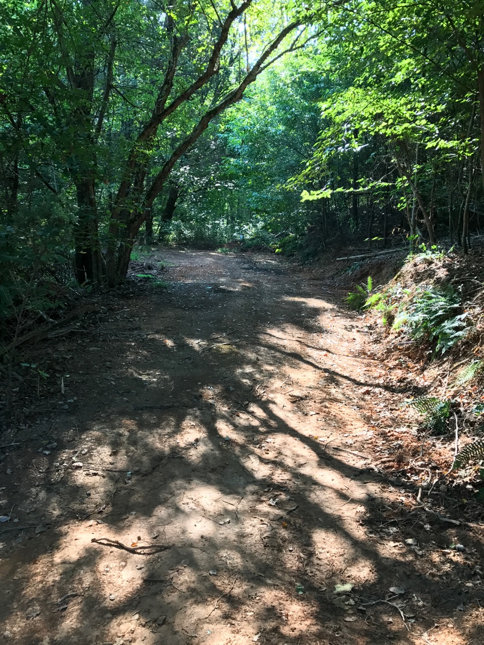

Hi,
I've been working on clearing out an area so that I can build a shed to keep my tractor (Kubota BX23S) in. After clearing out the brush and a few small trees I'm at the point I want to make sure it is nice and level. I do have a scraper blade, but I don't believe it will do any good until I get rid of the roots that are present. What is the best way to deal with roots, other than digging to China to remove them (being new to tractors, there has to be a better way).
The images attached shows the area cleared and the roots I'm dealing with.
Thanks for your suggestions!
-Dan

I'm not aware of a simple solution other than backfilling over roots with sand. A layer of sand beneath concrete is recommended anyhow.

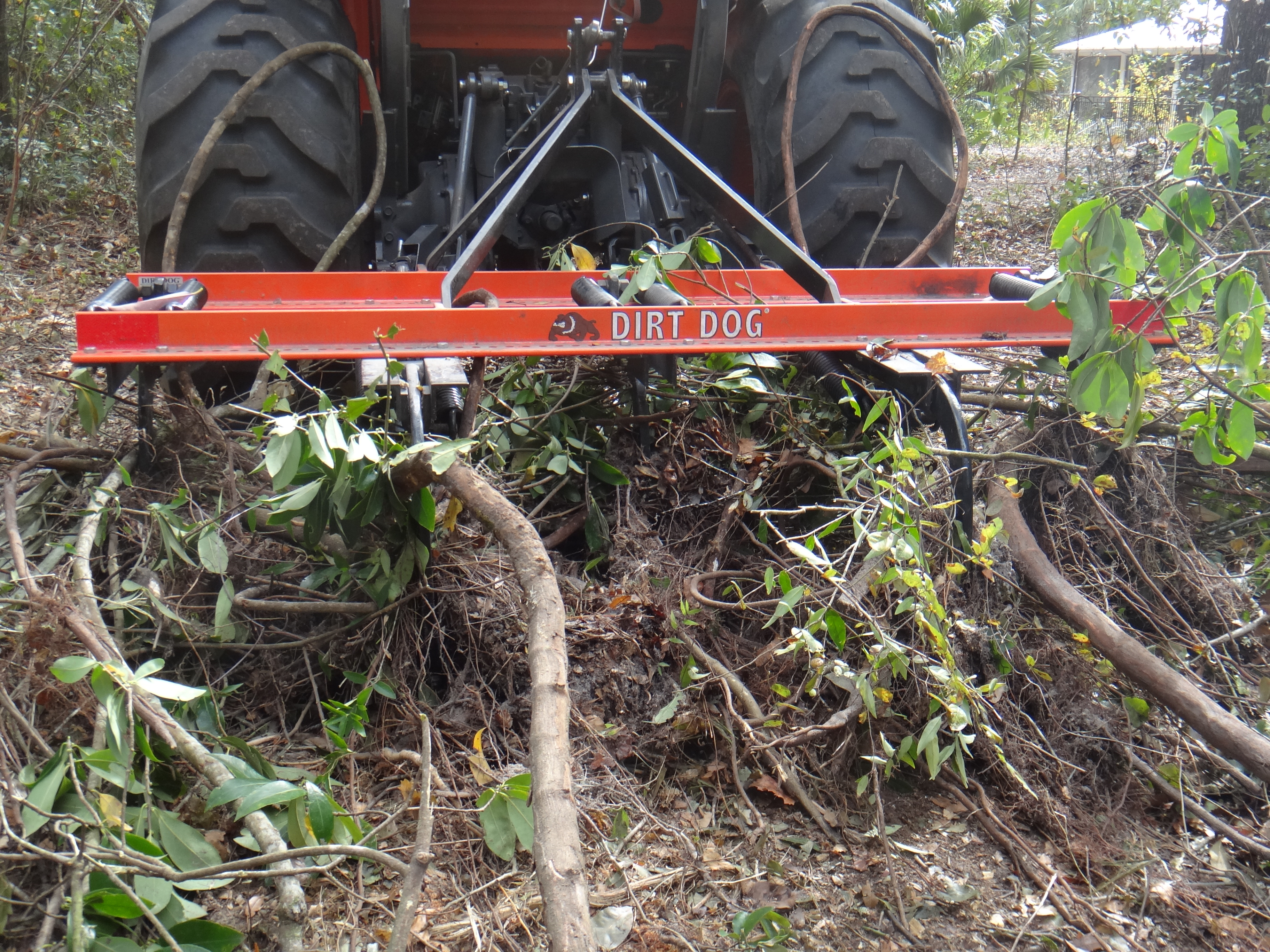

A Ratchet Rake bucket attachment is good for this type of task, to 4" or so deep.
If you feel the need to drag out roots 6" to 12" deep a Field Cultivator is an excellent implement. I have done a lot of root removal from Florida sandy-loam.
Dirt Dog (brand) produces their Field Cultivator / All Purpose Plow with as few as three spring-protected tines. Also good for pasture aeration IF THE SOIL IN NOT TOO HOOF PACKED.
LINK: http://www.tractorbynet.com/forums/attachments/339095-dirt-dog-all-purpose-plow.html?highlight=

Just start the levelling process. Pull roots as required.

Not clear to me why you care about the roots then... Are they preventing you from grading appropriately? Are you worried about incursion into your new foundation? Or does it just look 'unkempt' and bother you?
   / Suggestions needed - How to deal with roots.
#9
Hi Luke'sScreenName - The shed will take up about 1/4 of the area cleared, so the rest will be driveway, for lack of a better term. The roots are preventing me from grading the surface, that's all. i'm not worried about them under or near the new foundation, since the base of the shed will be raised for air flow. I could just leave them in place, but would rather be able to smooth out the area.

For smoothing just dig out some dirt from the side hill.
