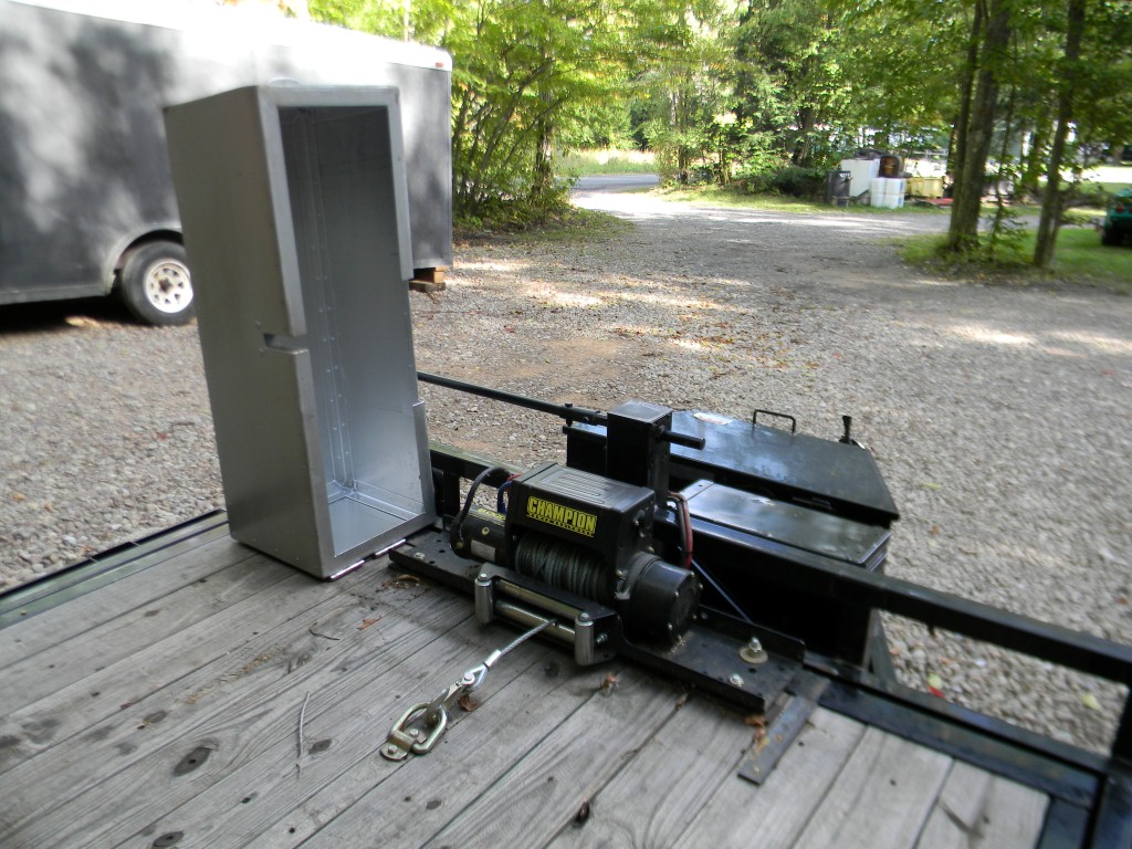

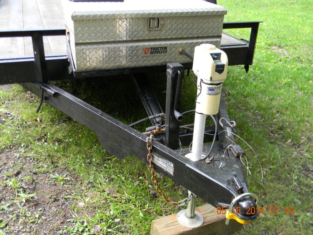

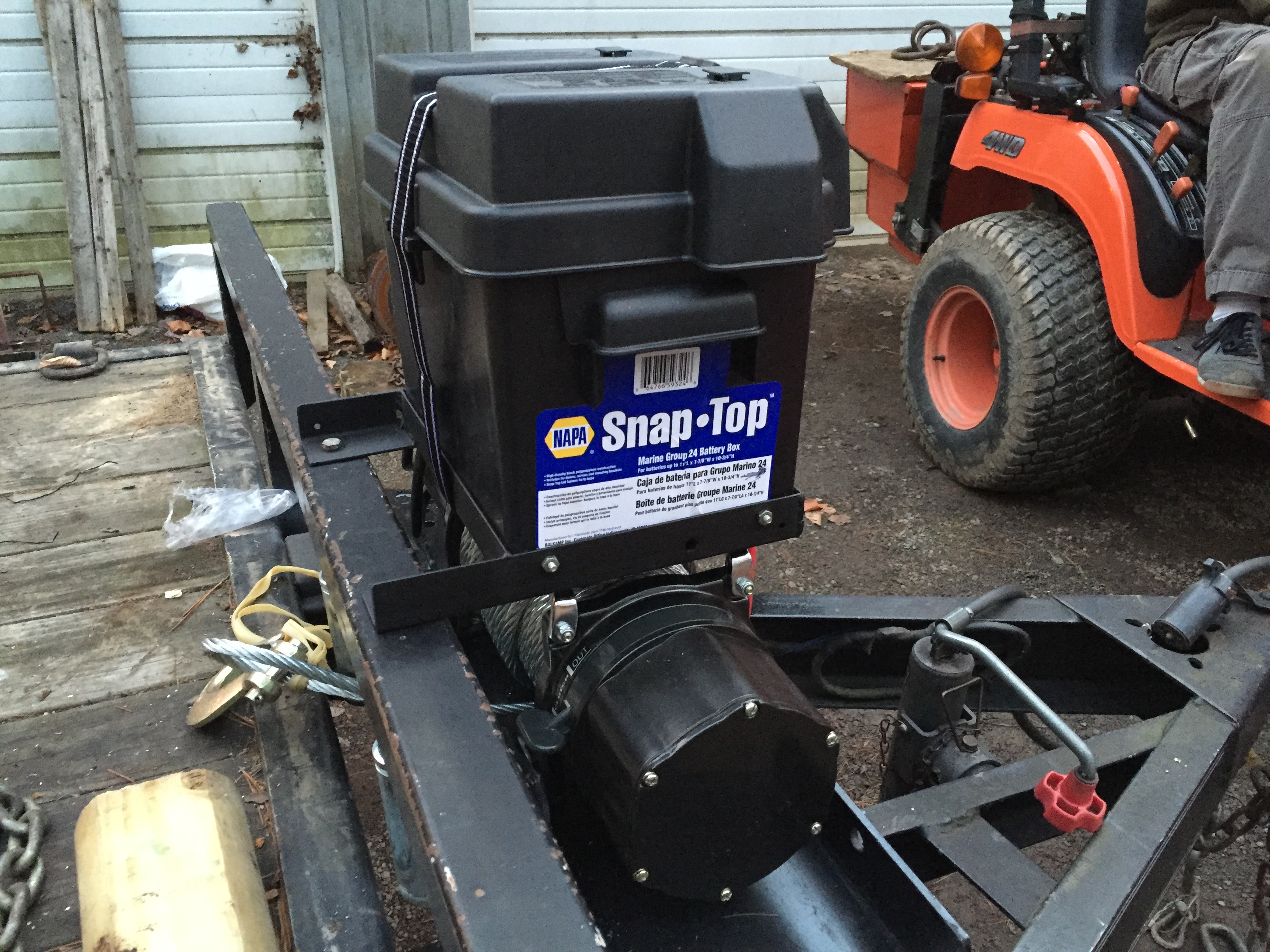

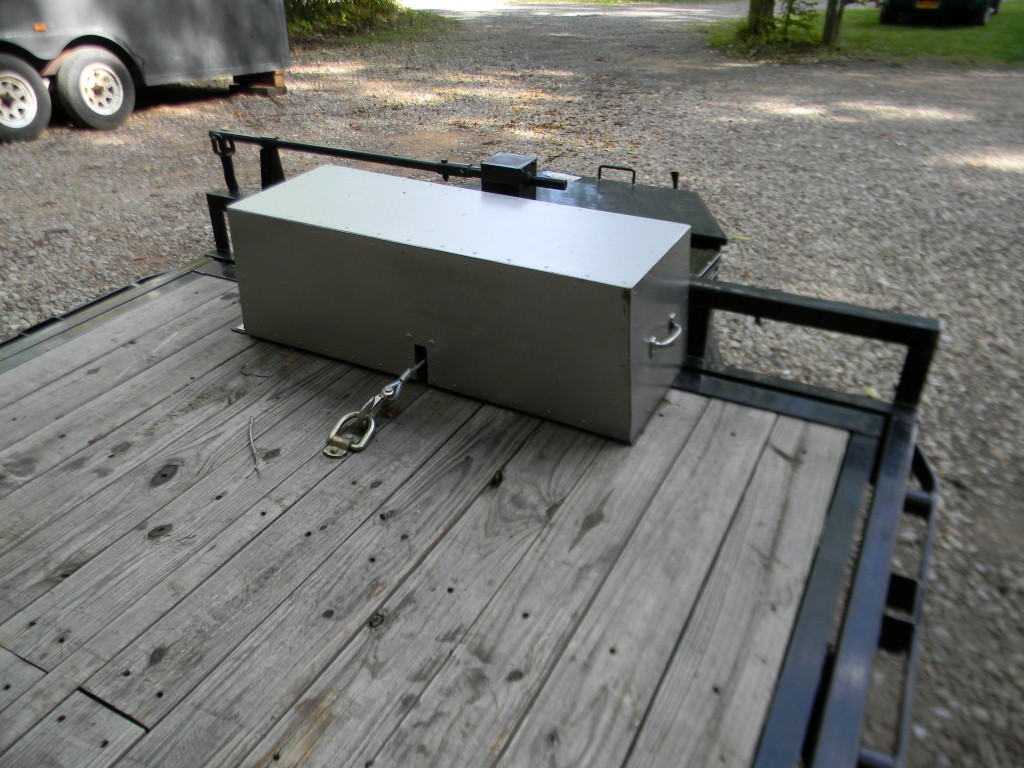

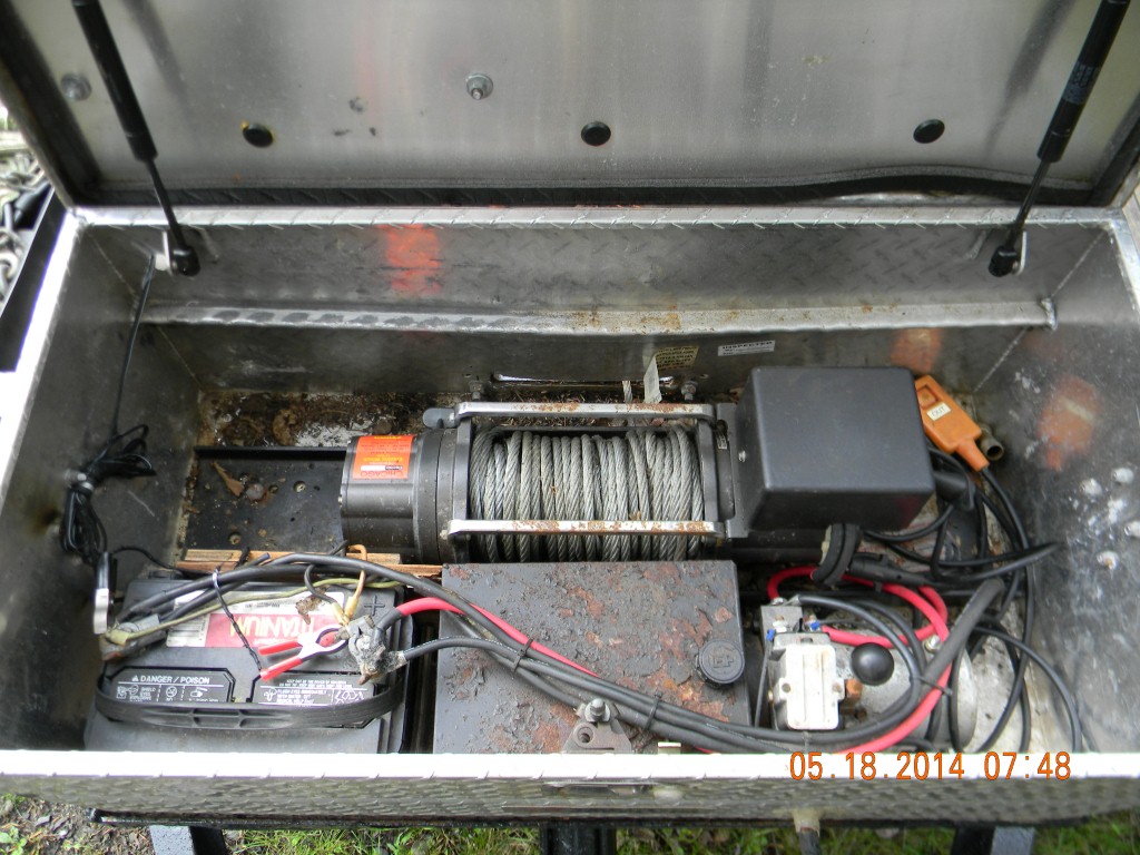

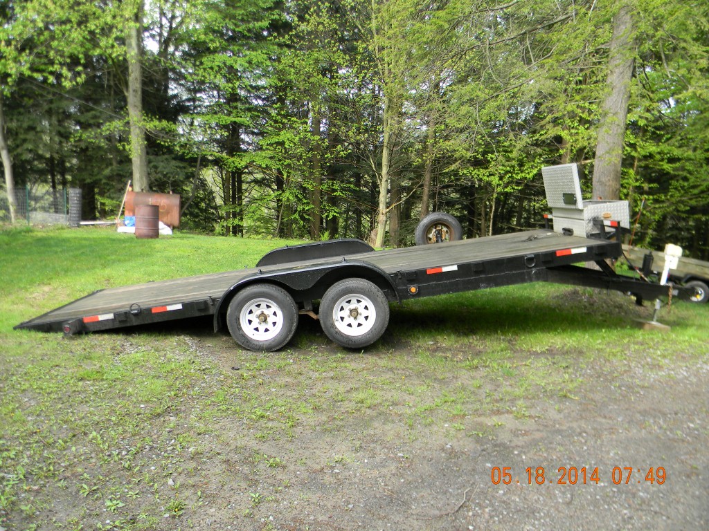

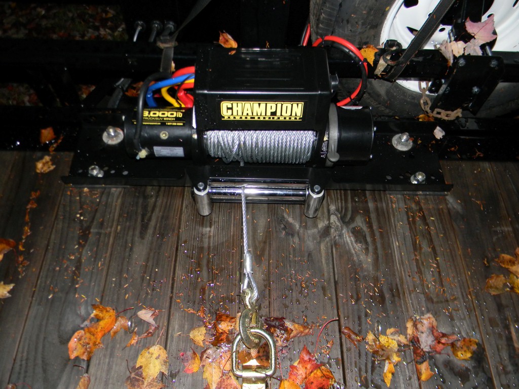

I've owned a couple full tilt trailers. The style shown by Terry is a very good idea. I thought of it but IMO a winch mounted to a portable cradle was kind of heavy as I have limited lifting ability in my left arm. I decided to mount mine to the trailer.
The first was a 20'er and I made an angle steel frame in front, mounted a TSC box and installed the winch inside the box. Also in the box is my tilt bed pump which I installed. The trailer was originally a manual pump tilt. (first 3 pics)
My second is a 22'er and I mounted the winch to the deck and tilt bed steel frame then made a cover for it. (second 3 pics)

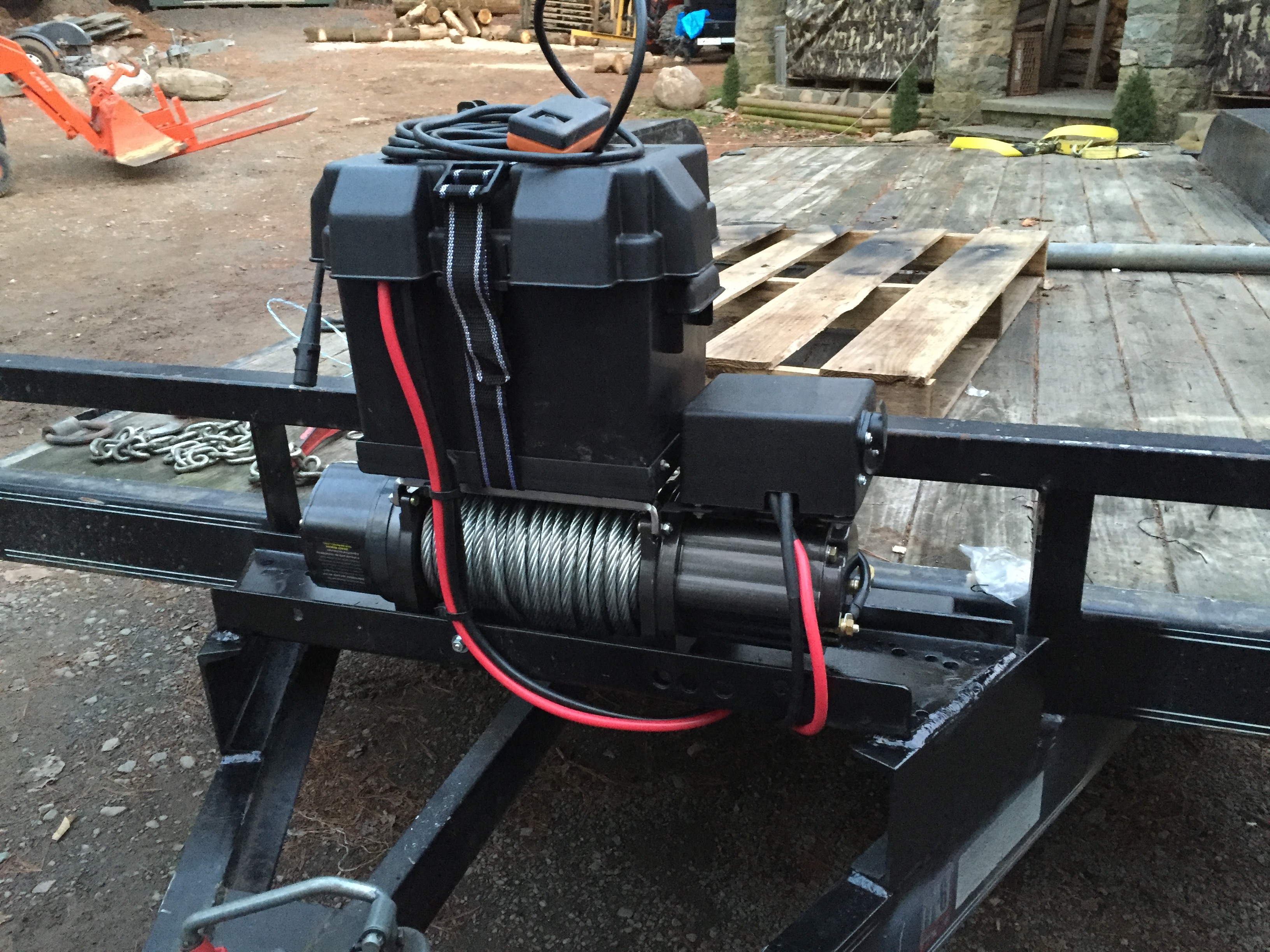

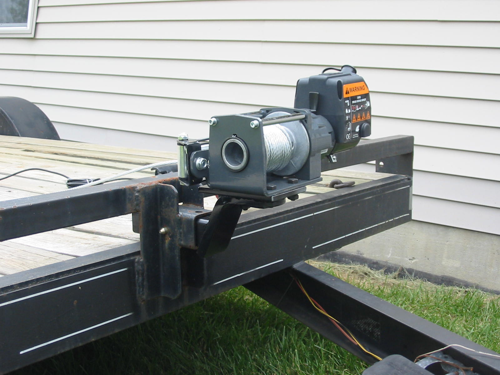

Here is my version of a winch mount. Works good, added a wireless remote after the picture was taken.

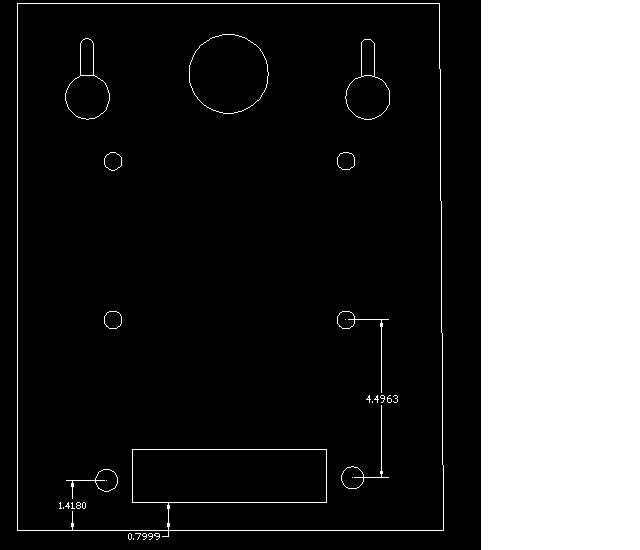

I cut out a portable plate for mine. The winch and roller are bolted to the plate and the whole thing can be placed over a hitch ball, strapped/chained to a tree (w/e) or shackled to the trailer. I welded a tiedown ring to the center of the trailer and just use a shackle to connect the winch.

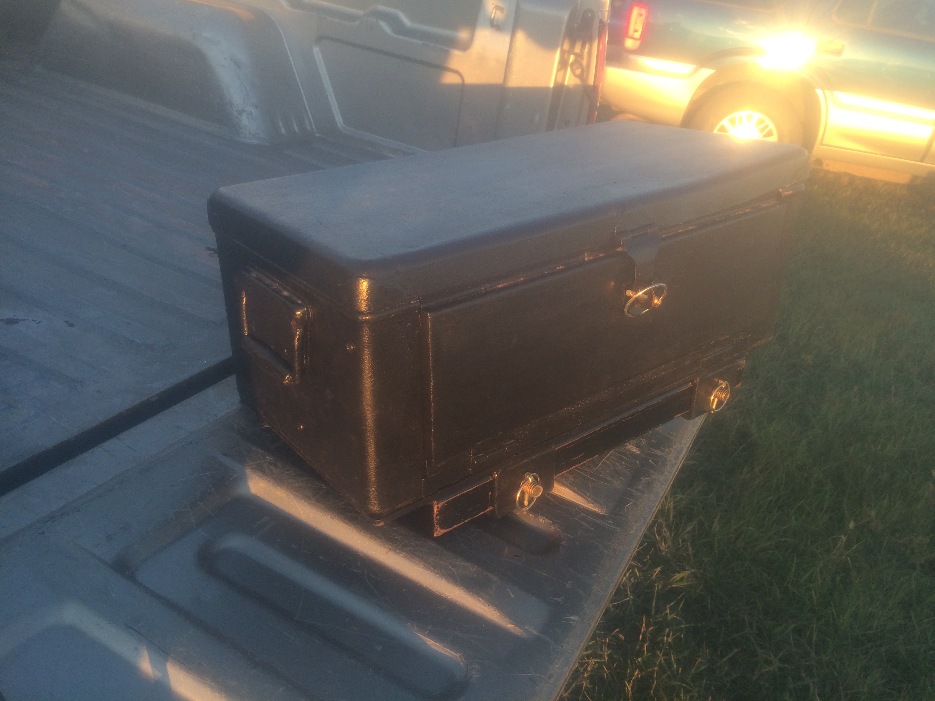

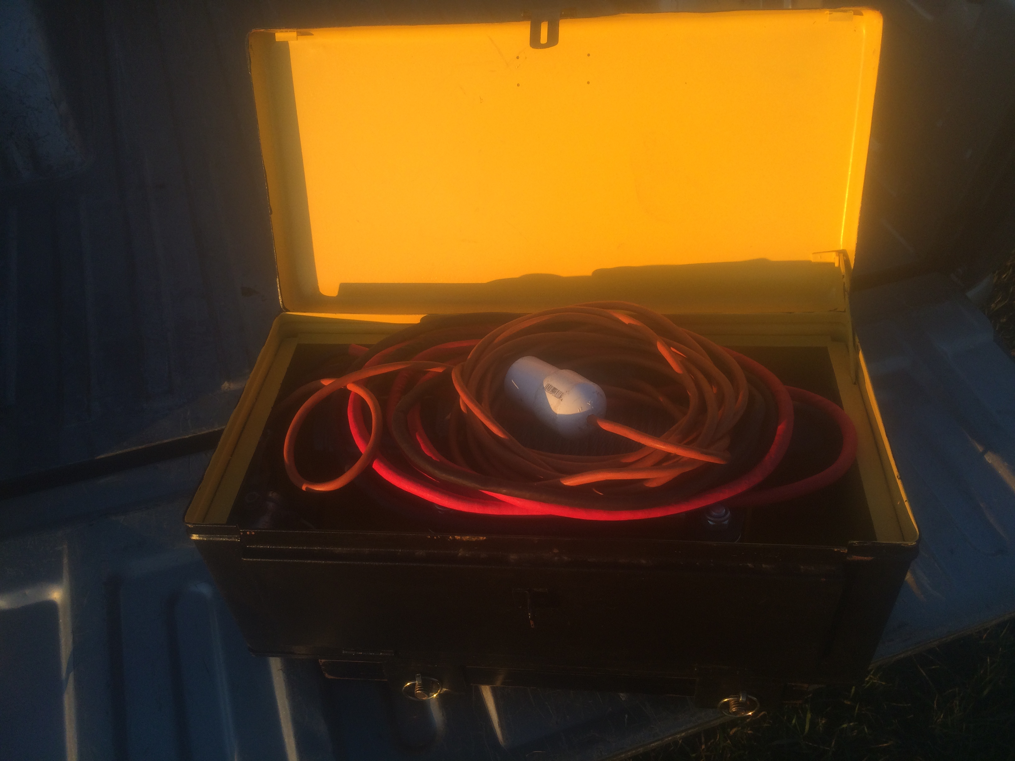

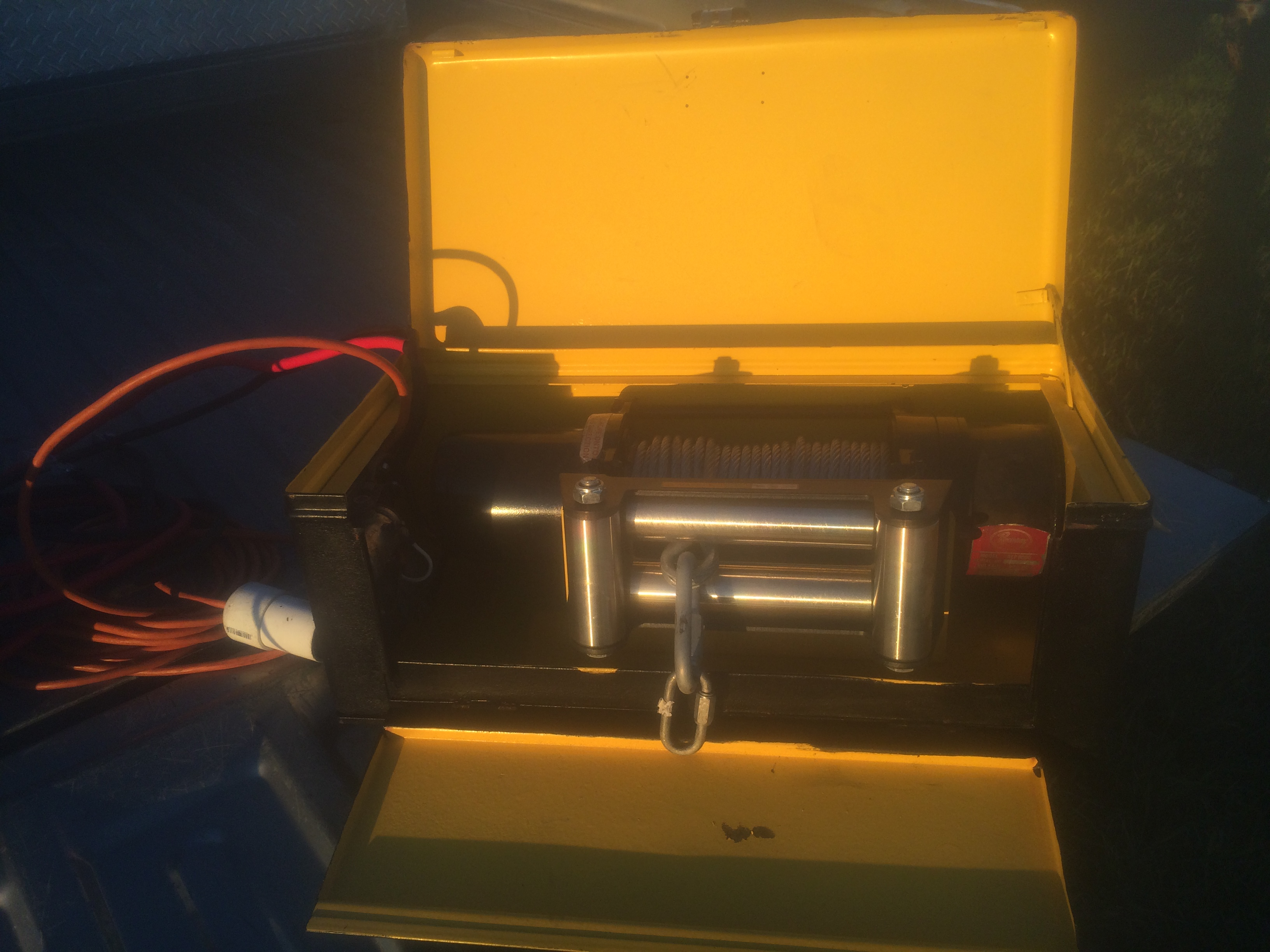

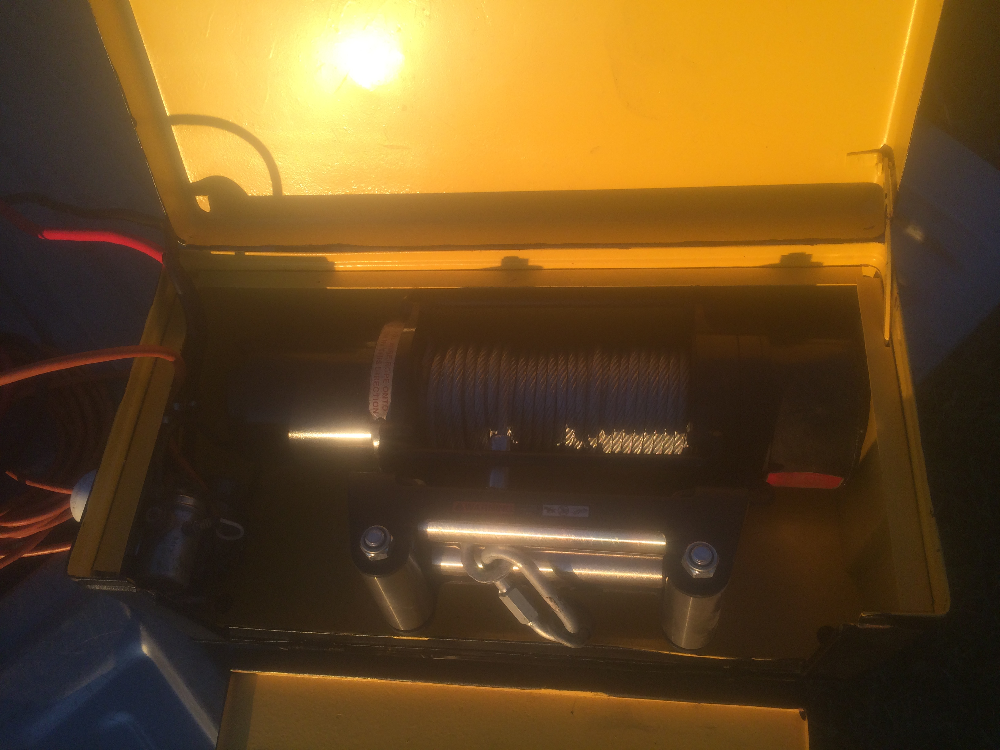

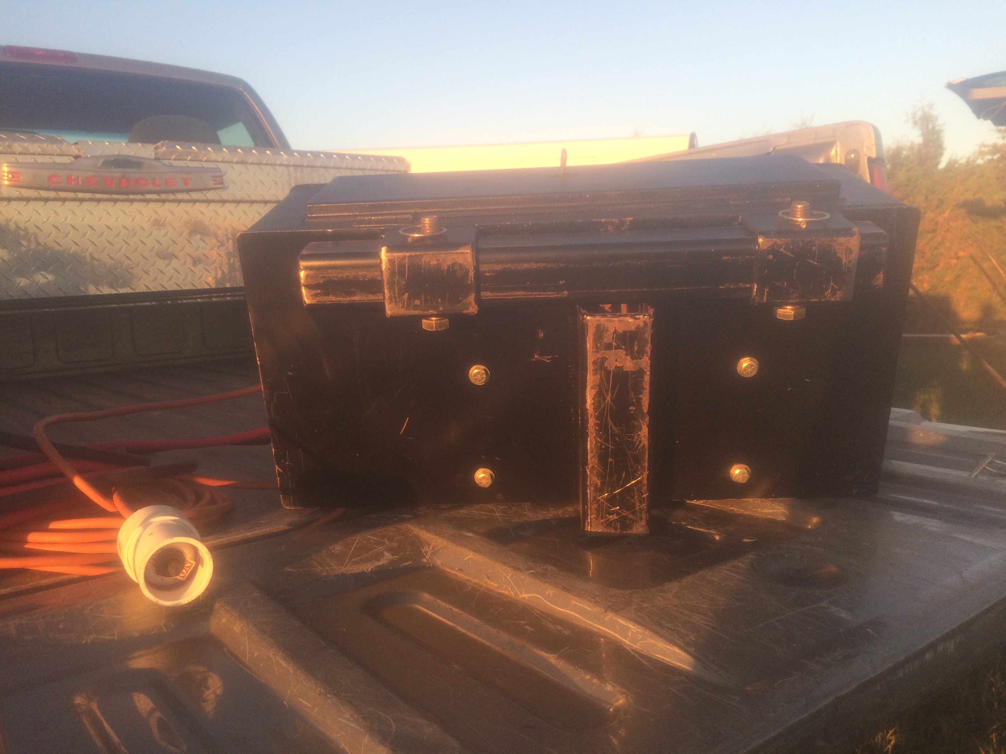

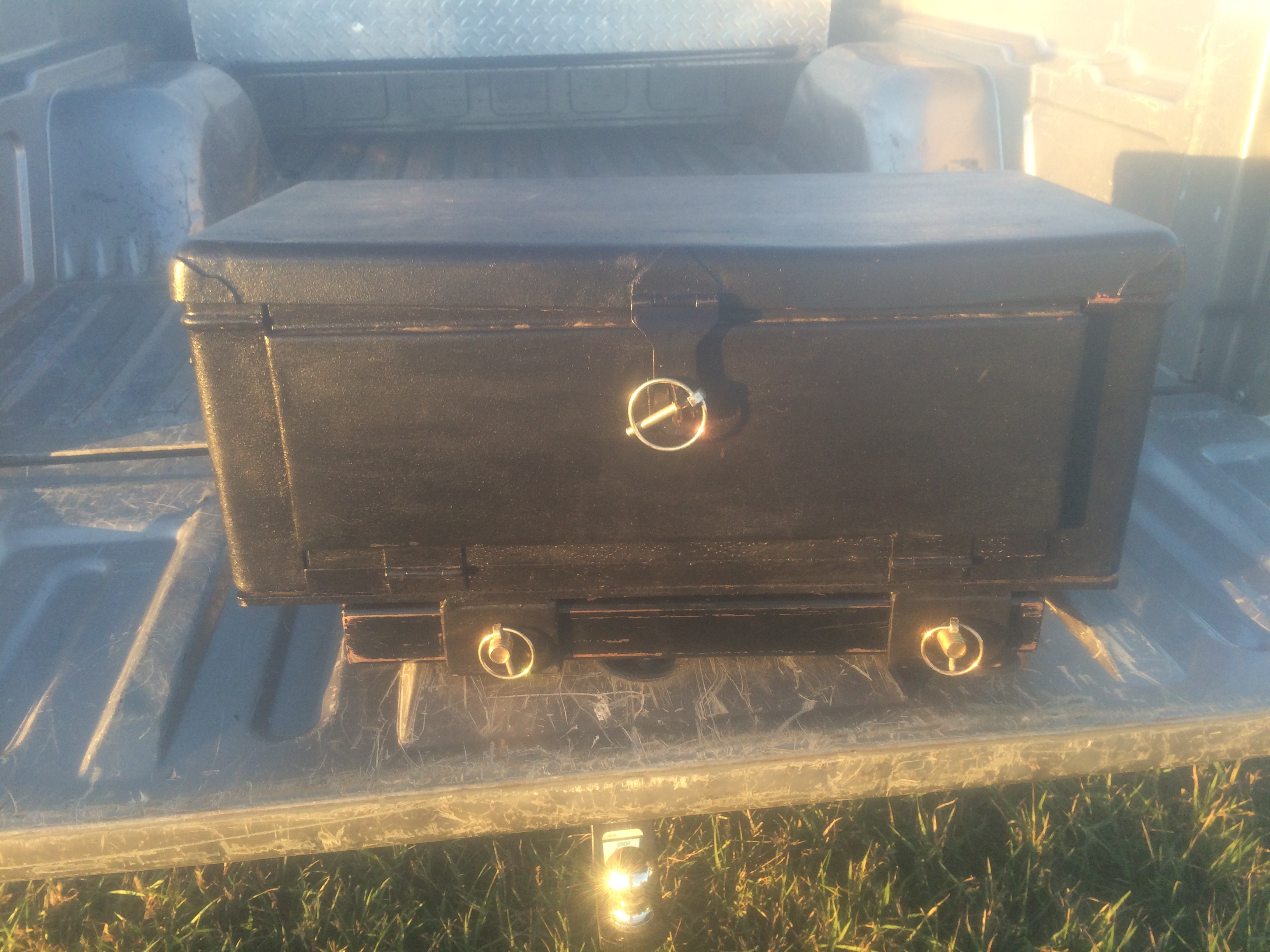

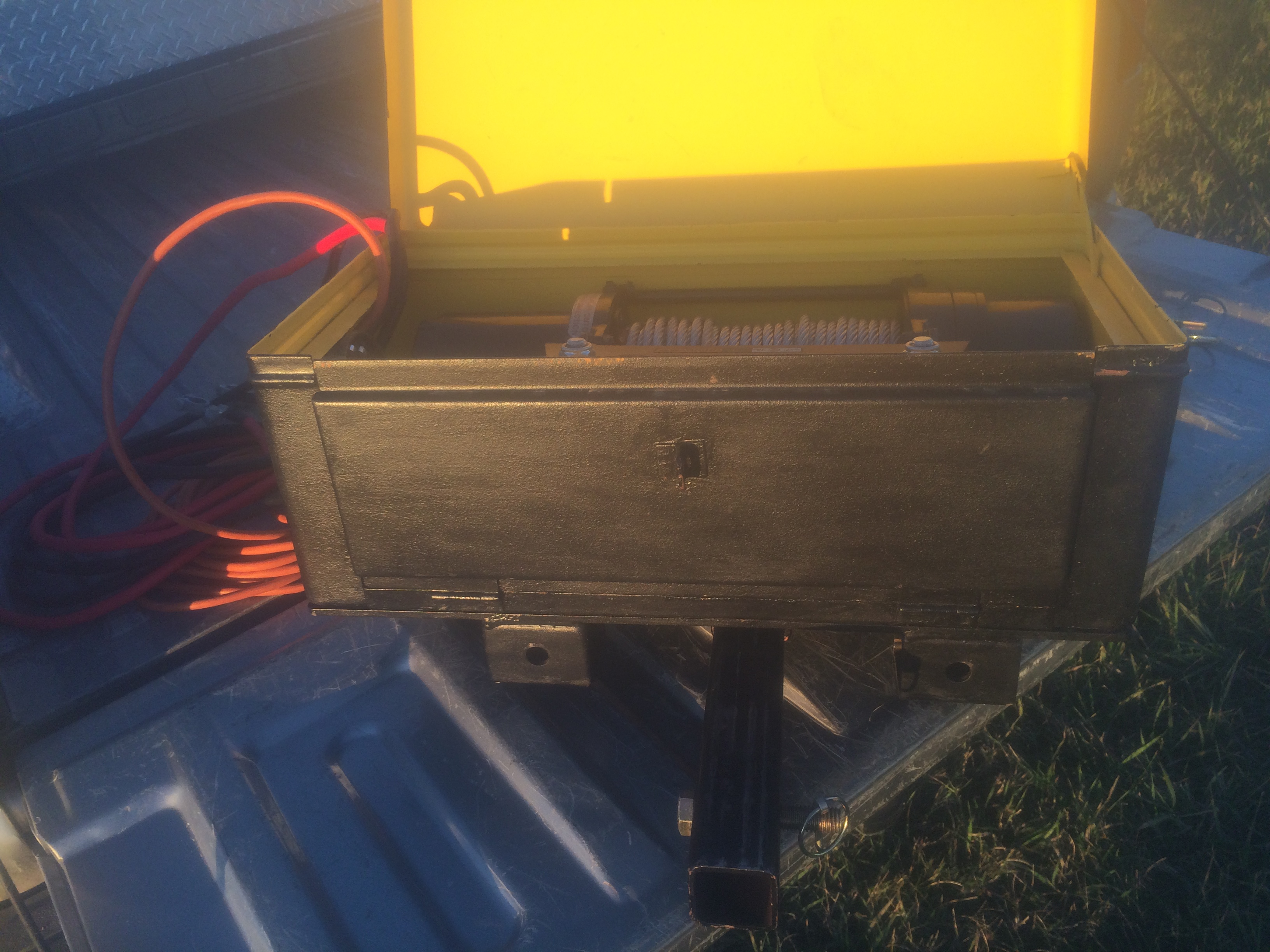

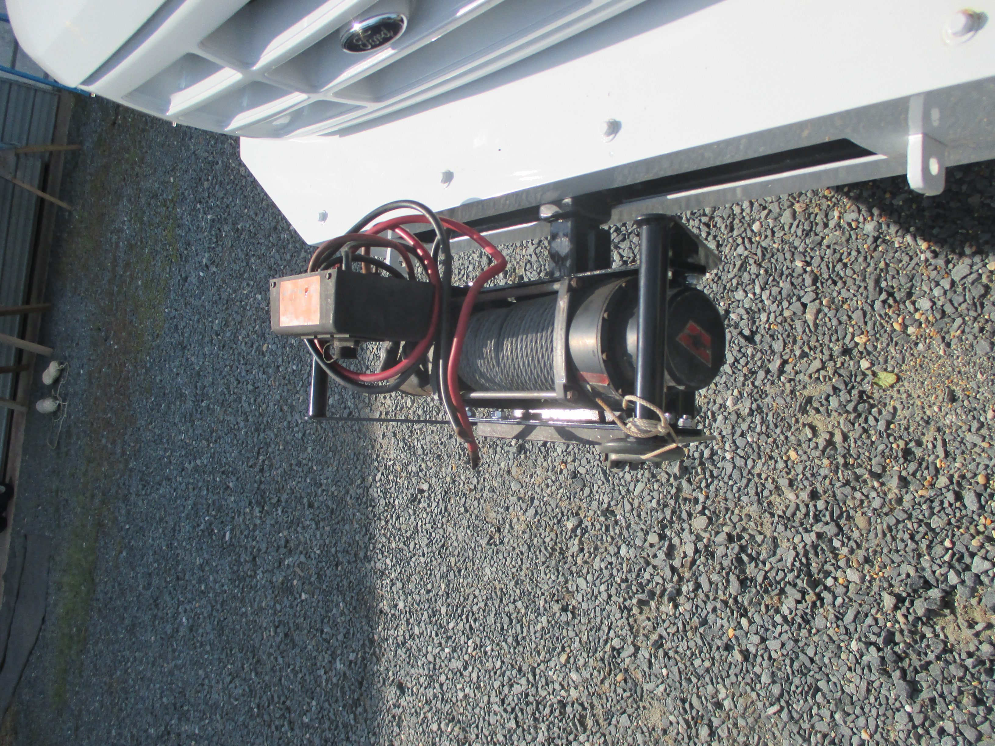

Here is my setup. Love it. 2 handles, easy to carry and fully self contained. 8000 lbs. Warn winch, mounted inside an old toolbox to a 1/4" plate on the bottom. The "legs" are square tubing that also hold the 2" square tube that slides into the female on the trailer or into a receiver hitch. Pull the pin and it stores on the shelf until next time.

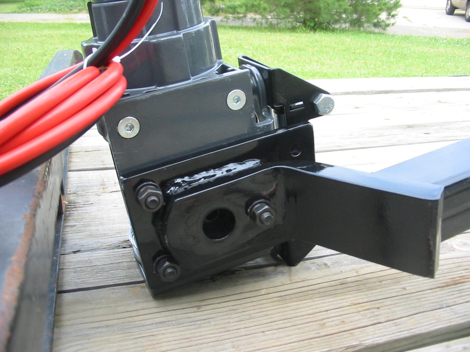

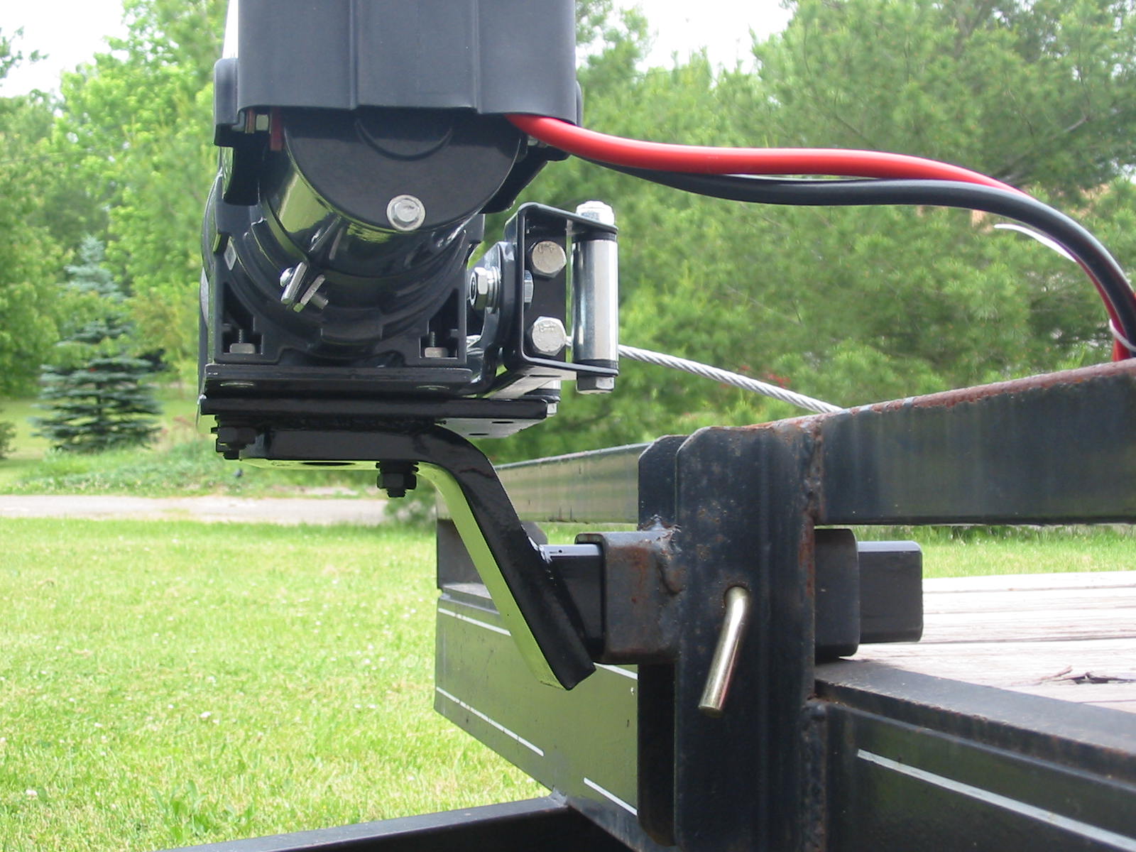

My trailer is a short 16' so I needed to mount my winch forward of the bed. I used a drop hitch with a plate welded on to it to bolt on the winch. The winch can be rotated 180* and remounted so that I can use the winch in the receiver in the rear of my vehicle. Last year I mounted the winch in the receiver of a disabled pickup so that we could winch the vehicle out of a back yard to a place that my trailer could access. Then we moved the winch to the trailer then pulled the truck up on to the trailer.
The winch is a Warn 3700 which is small enough to carry easily yet powerful enough to pull vehicles with flat tires. I only put the winch on the trailer when I need it so portability was important to me. The receiver mount system also lets me mount a hitch and ball to the front of the trailer bed so that I can hitch the front of a small trailer with bad bearings or flat tires once I get it up on the bed. A couple of straps at the back and I can haul it home.
