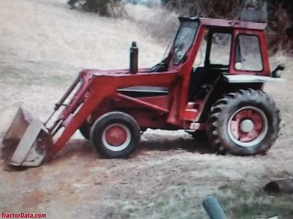

A true tractor loader is a rare beast. It's a permanently mounted front end loader on a tractor with a 3pt hitch. The loader is not removable easily. I had one. A mid-late 70's International IH2500B. It was an industrial unit, not an agricultural unit. Other than being 2wd (did not like my sandy soils), it was a really good option for a machine. It was built to take the abuse of a front end loader. The front axle was beefier. It was a low tractor. You straddled the transmission hump. So it was not a walk-through operator's station. You had to climb over it. It was also 8000#. The 3pt was the exact as it's agricultural counterpart, the IH574. It had draft control, as well as position and depth control.
I don't know that anyone makes a true tractor loader anymore.
   / Suggestions for tractor loader #5
Mine was almost identical to this photo from tractordata, but yellow.

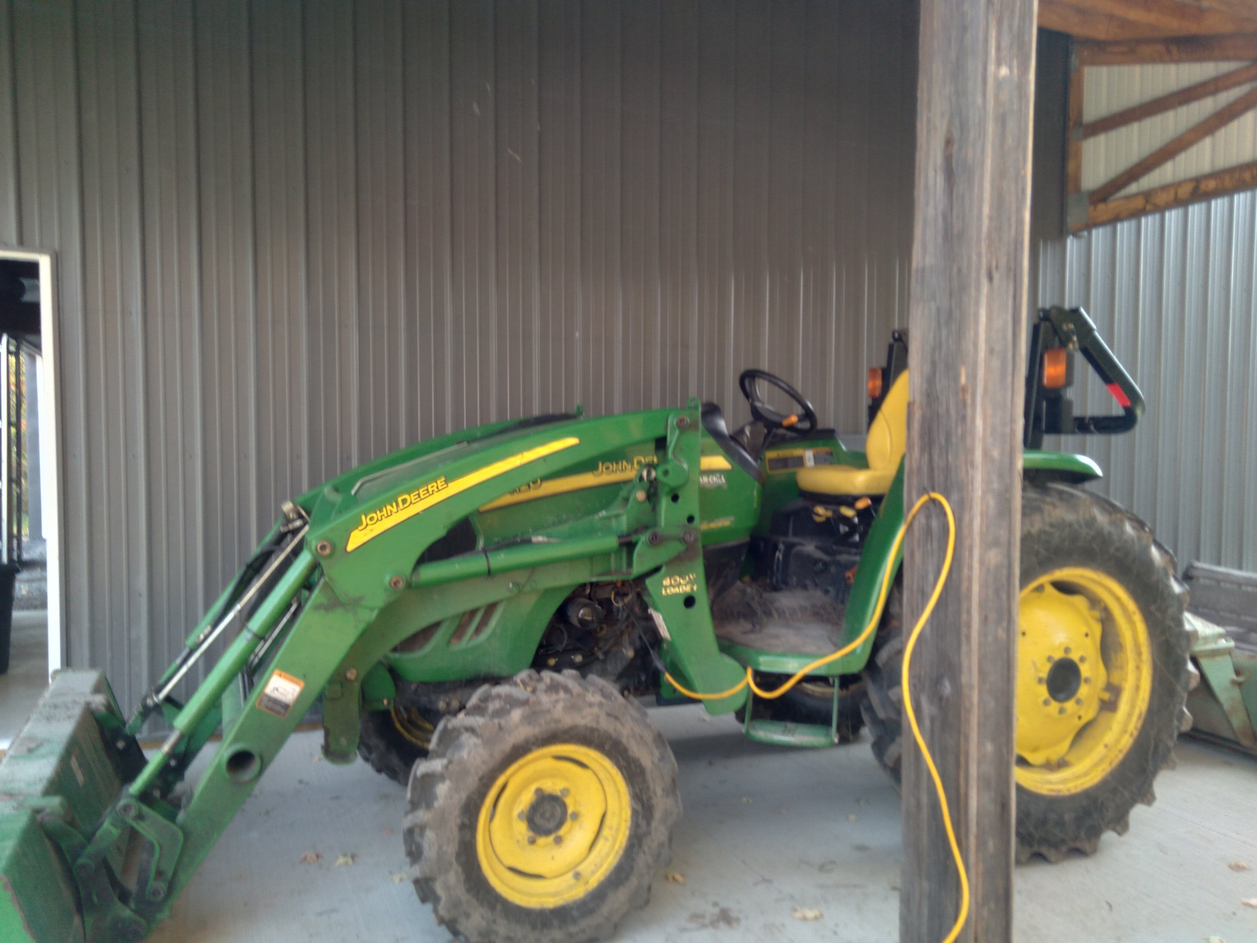

My suggestion would be to skip the backhoe and just get yourself a CUT with a loader. Those are basically just toys if you have access to a real excavator. If you can find a pre tier-4, low-hour, 45ish hp model with low hours, I would take that over a new one any day. Set it up with loaded rear R-1 tires, a block heater, and a back blade and you will have a snow clearing beast.
Something like this 1000 hour, 2005 John Deere 4120 would be perfect:
