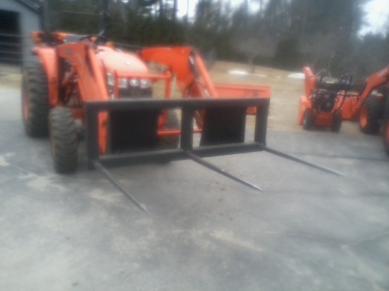

   / Suggestions For Pallet Forks For A LS XG 3135H #20
