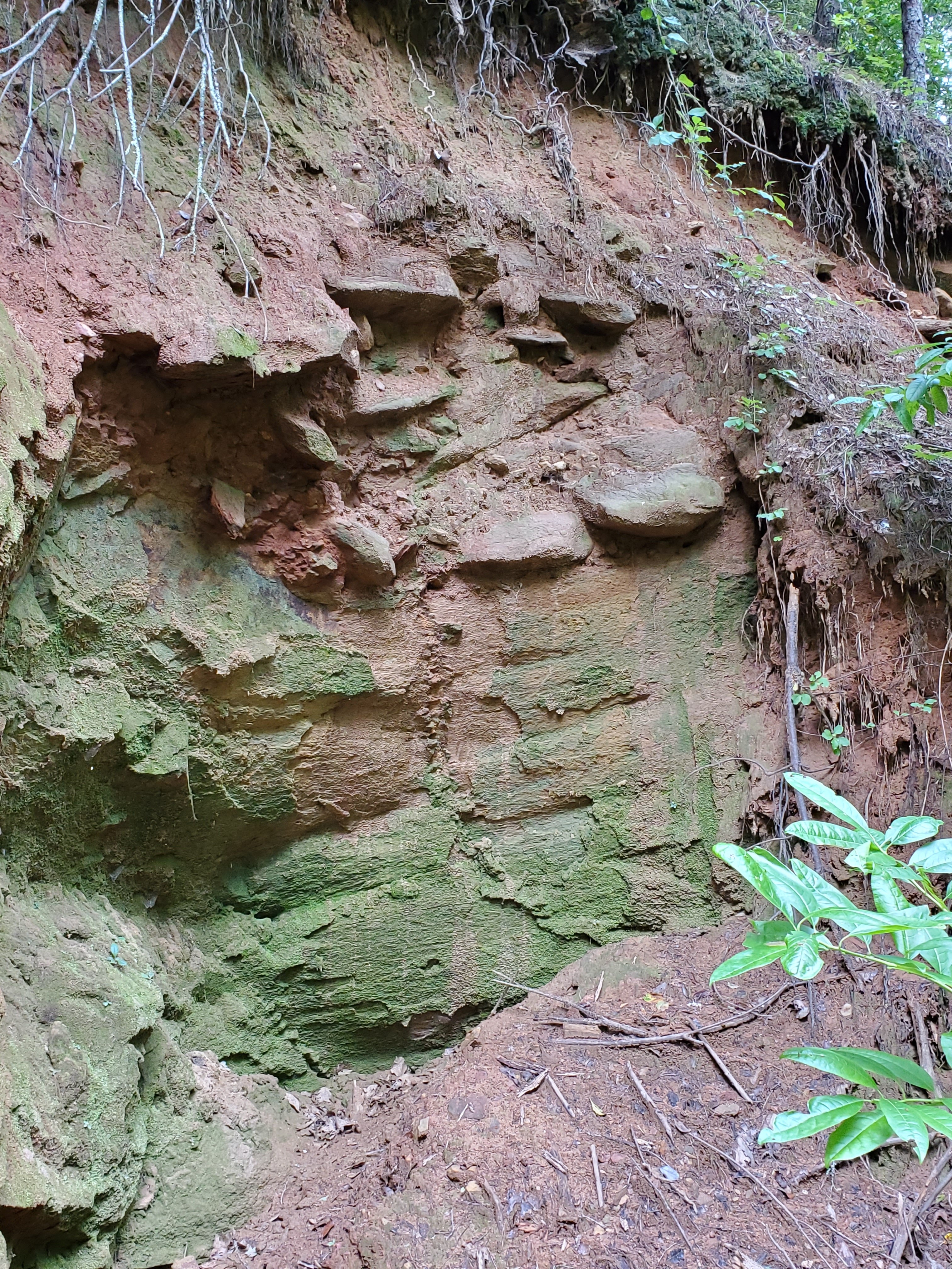

Pricey is relative. A TLB tractor is only as good as the tools that is can use so the rock bits are not pricey because there are only 4 other choices when facing rocky soil. Don't dig there ( not an option in rock infested W NC [ see pic] ), use the back hoe or excavator ( leaves a very big hole to back fill, dig by hand and spend 8 hours+ on each hole, or pay someone else to dig post holes. "Time is money" even though I'm only working for myself so everything is paid for in jobs accomplished. As I've said before. I buy only when 50% return occurs within 3 months and fully paid with 3 years.
