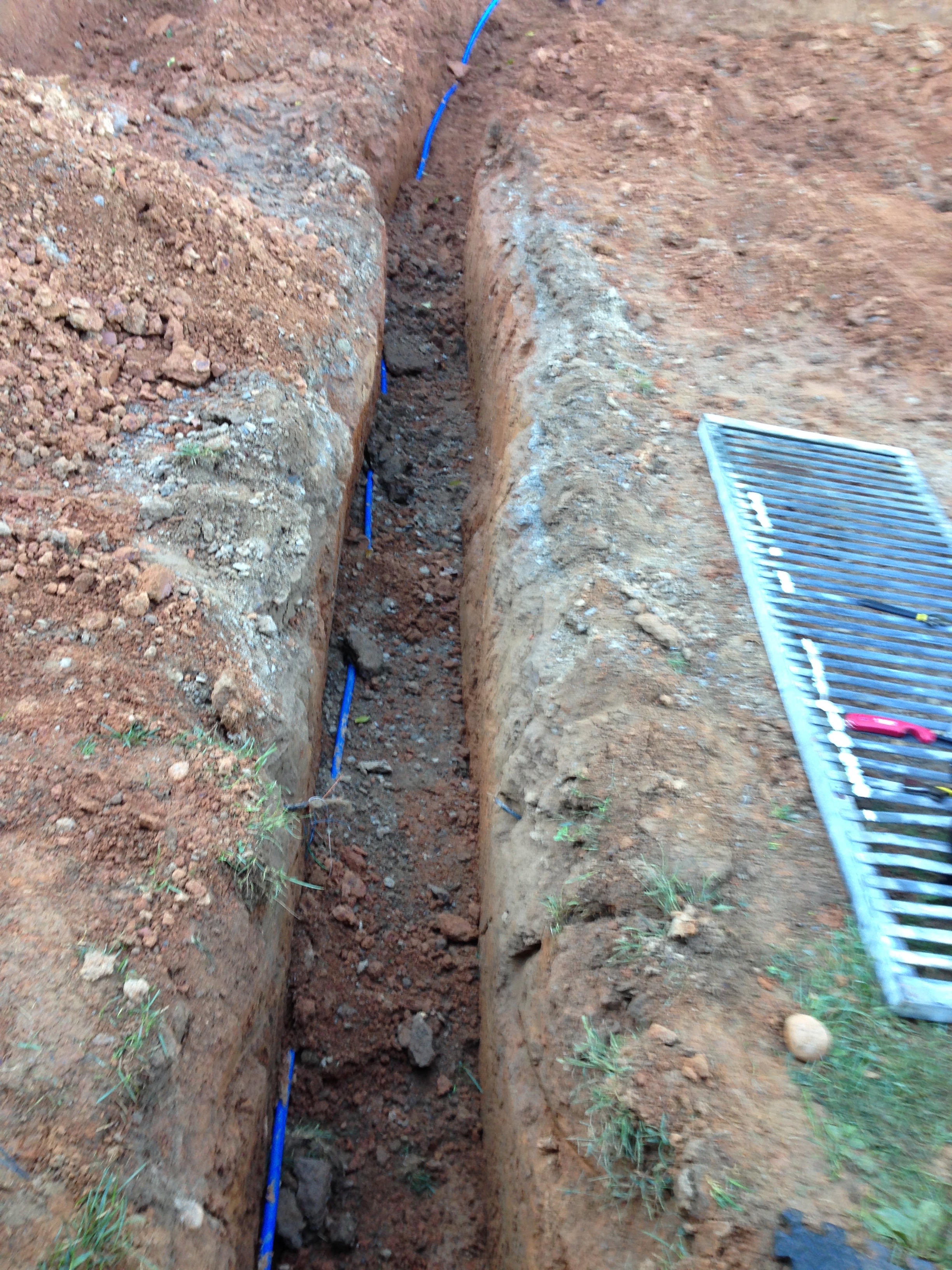

I have a Case 495, 50+ HP, Cat 2 hitch. Some photos below of a shallow trench between two buildings. That was dug with a 9" bucket on my backhoe. The backhoe would certainly do all of this but it would be very slow going and create much larger trenches than needed.

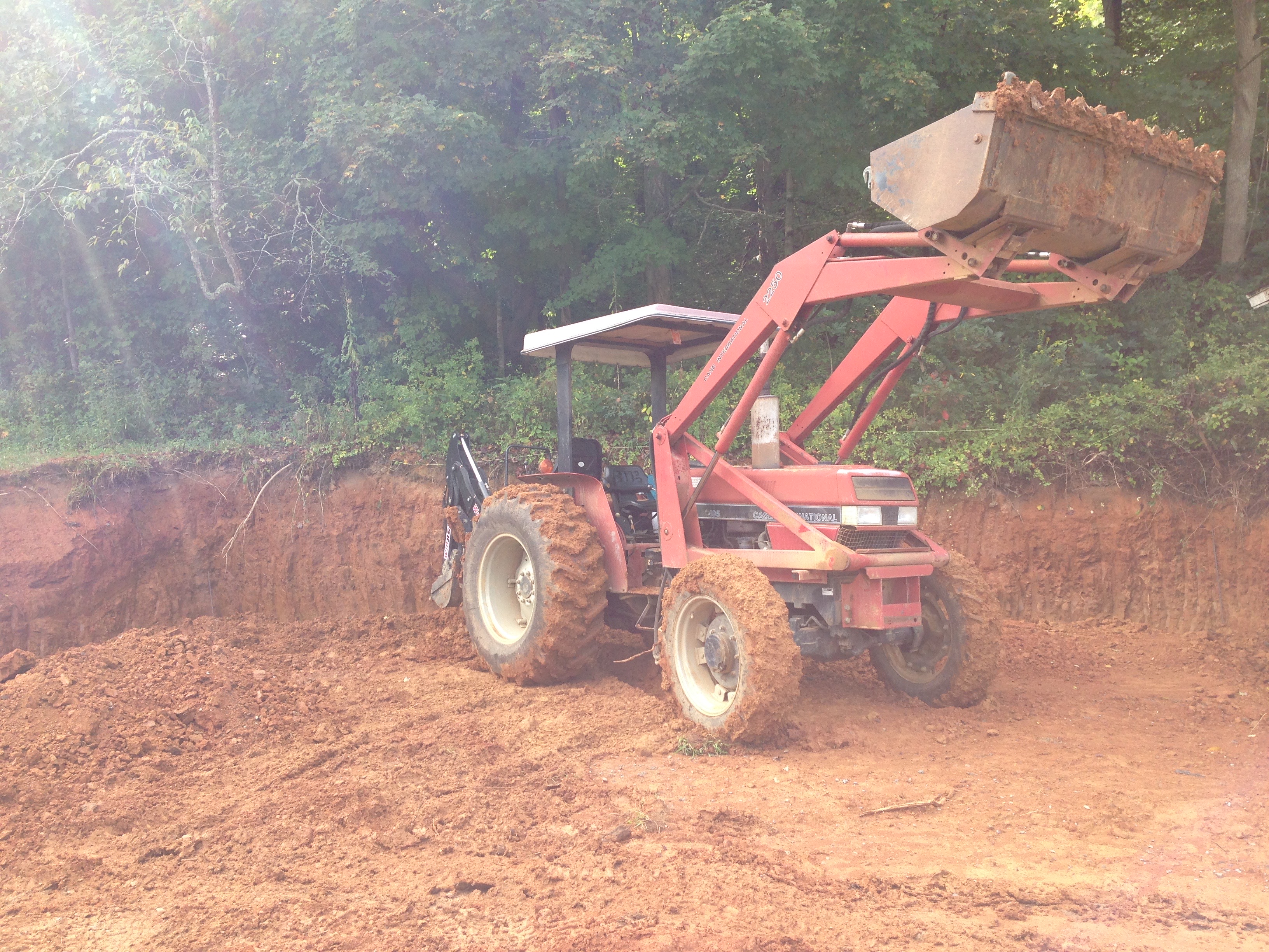

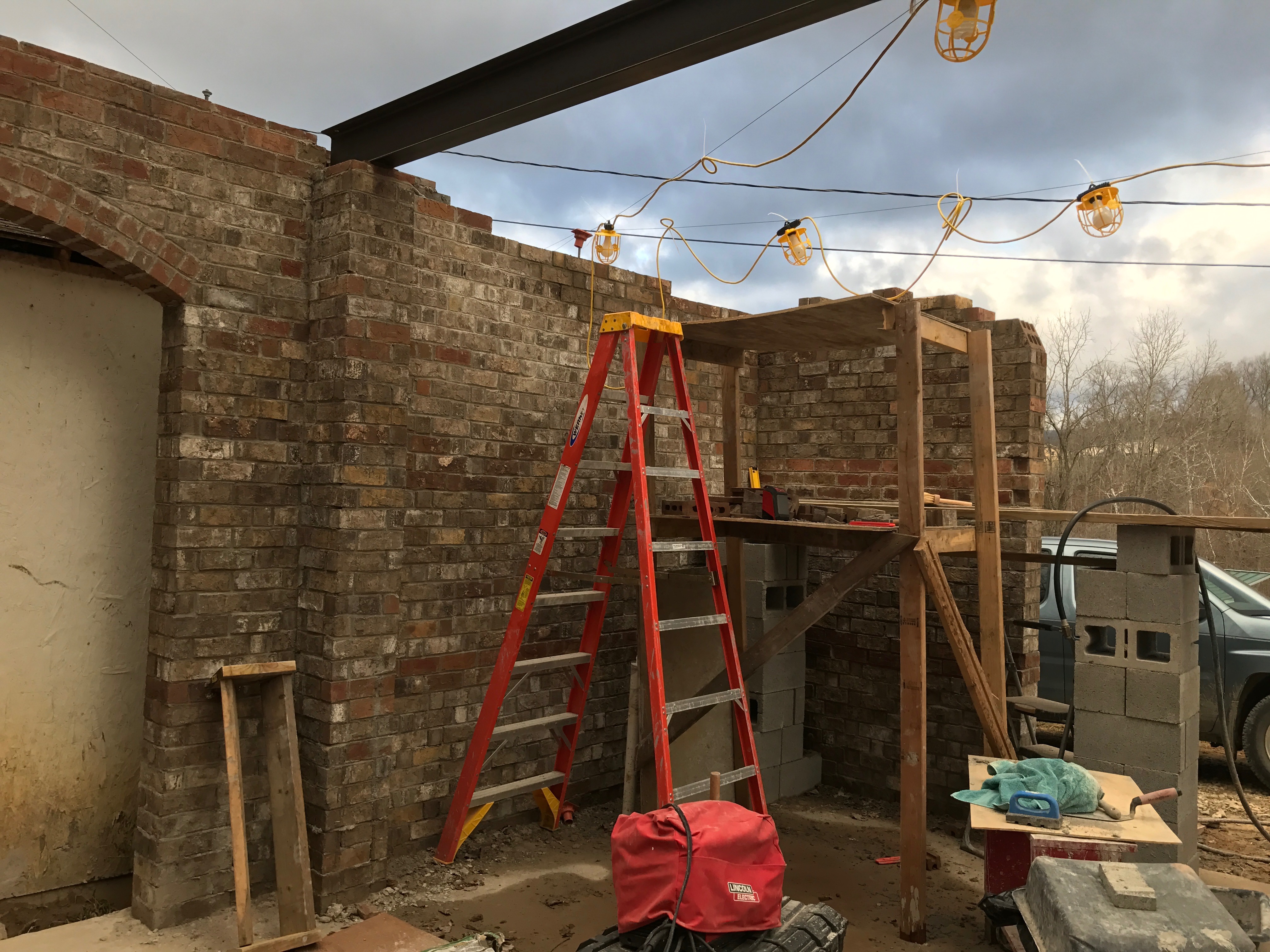

There's a photo of the triumphant tractor having excavated the site for my new machine shed. Its structural brick around the unbackfilled sides and block where there is backfill.

View attachment 499684View attachment 499685View attachment 499686
ABSOLUTELY the trencher,...unless you have rock.
I did exactly what you are planning,.... a few years ago.
I have a backhoe, but the trencher was the perfect tool.
Trencher is fast too!
