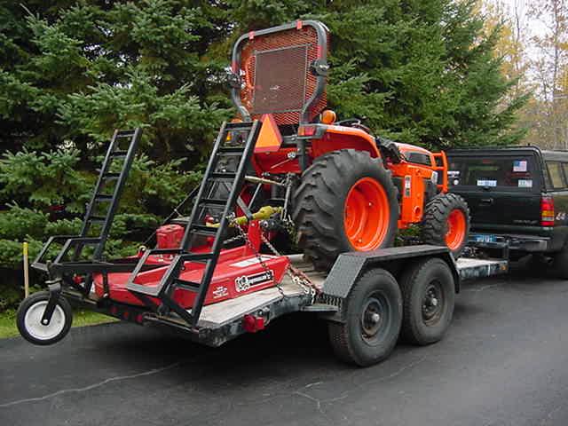

I had a trailer with ramps made and the only problem I have is how the ramps are stored. Mine tip up per attached photo, the type that slide underneath (U-Haul Car Haulers have them) would be better in my opinion. Hauled my son's Mustang 200+ miles and the ramps did a little damage to the back of the fenders. Also wish my trailer was 4-6' longer. Had it made to haul my AC H3 Crawler, never thinking of other uses.
penokee /forums/images/graemlins/smile.gif

We deliver tractors almost every day. We use ramps. We do so because, as already stated, we haul multiple unattached implements. They do make tiltbeds with a section of fixed bed at the front, normally 4'. That solves some problems if your extra implement(s) can fit on the fixed portion. If the extra implement issue isn't a problem, then tilts are the way to go.
