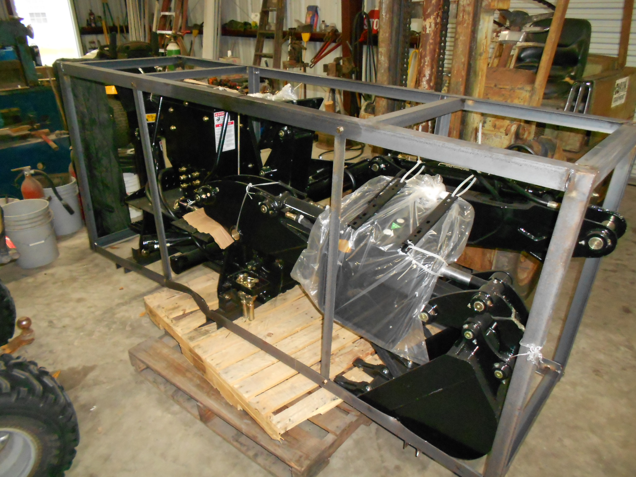

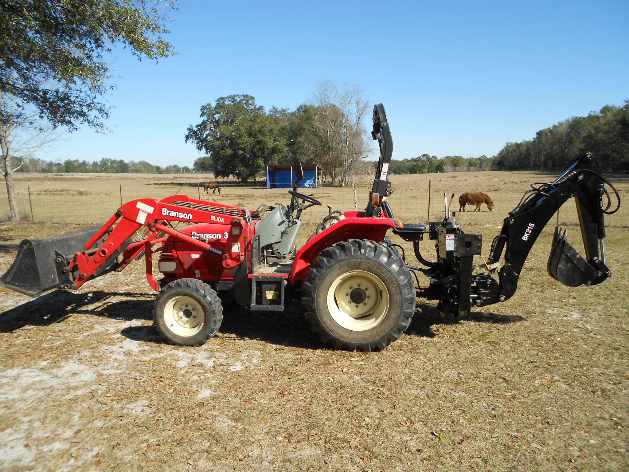

I bought a very well made hoe from- Titan Attachments - PalletForks.com - 8-65-8241
They sell several but the newest has the curved boom and their list is $3700..
I bought it first of the year and got it during one of their many sales and they offer free shipping!
It is 3 pt mount but I fabricated a subframe for it to fit my 3510 Branson.
It is smooth and has plenty of digging force with tractor hydraulics and only 13-1500 rpm.
It came with international stick pattern but I switched hoses to SAE pattern which I think makes more sense.

Agree, I have a Long brand 10 ft BH. It is quite heavy. It is a 3 point style but when mounted we realized it could tear the lower arms and top link right off the tractor. We fabricated a simple channel iron frame w/ a big U Bolt attachment to rear axle, and extended forward to the 2nd bracket holes for the FEL. The older utility tractors had fewer obstructions from 3 point to loader. The unused 3 point remained in place, lower links, the mfg provided a rigid top link connection arm. You are wise NOT to rely upon the tractor linkage.

The danger of using a BH on smaller tractor without a subframe is that the stress can break the tractor in two at the transmission/bellhousing.
Subframes extend under the tractor to the front spreading the stresses and reinforcing the basic design.
