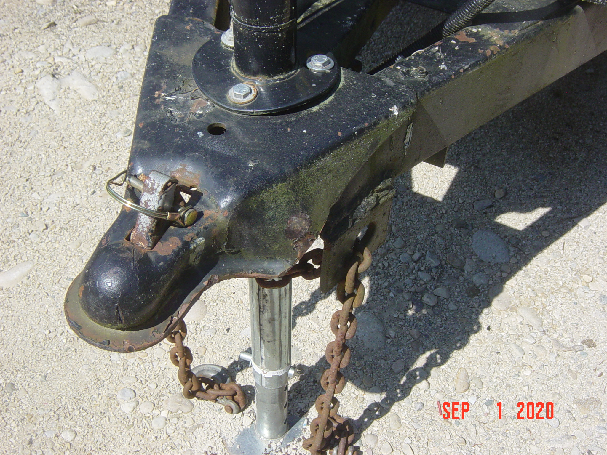

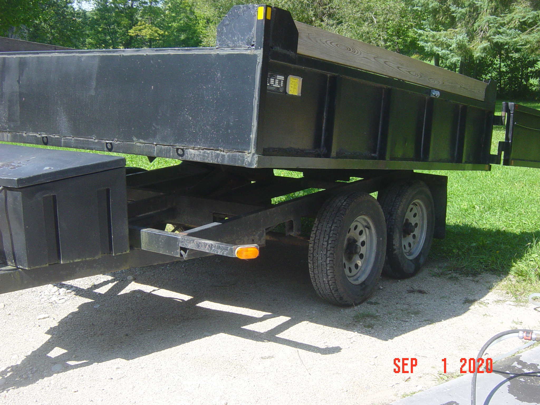

So, in the middle of another job, I "just" wanted to move my dump trailer, wash it and put it away.

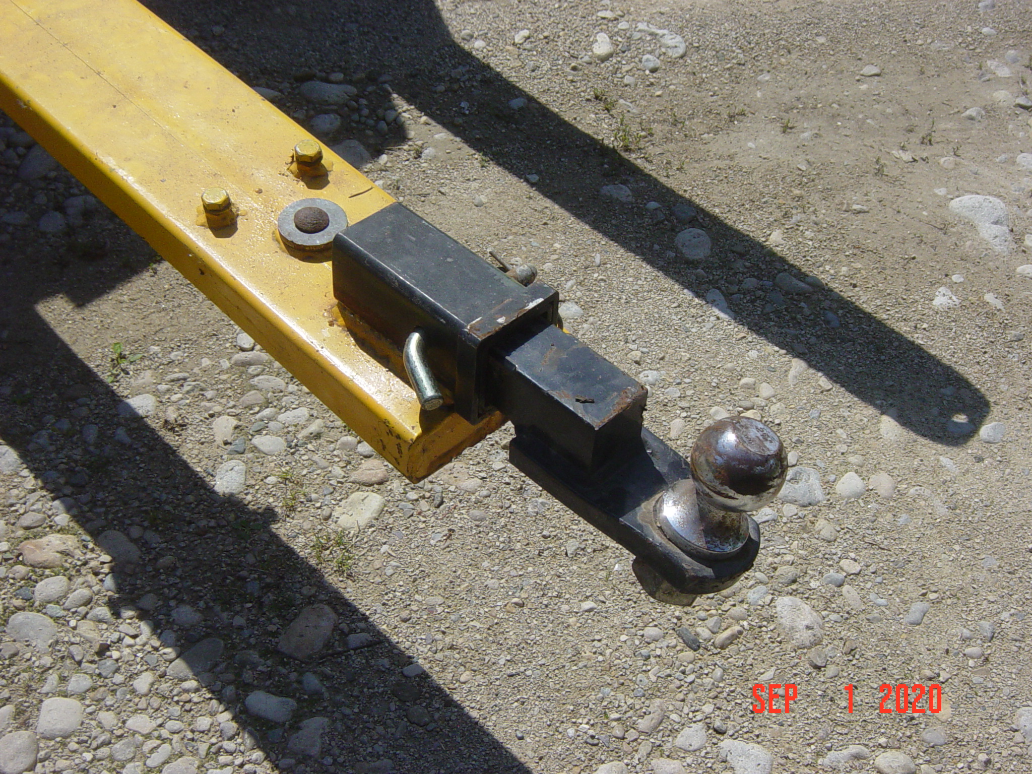

I used the loader fork hitch, and put a little down pressure on it because I wanted to straighten out the somewhat wonky electric jack. But the ball came out and got stuck in behind the proper place.
I knew something had happened "AND SHOULD HAVE GOTTEN OUT TO LOOK" but proceeded to move the thing with some sharp turns.
DSC00241.JPG I think they might call that a twisted testical. I never would have imagined bending that plate. That is a 2-5/16 ball and maybe 3/4" plate!
DSC00242.JPG I don't know if you can see the boil on the right side of the picture as looking at it. I already used a sledge to hammer the thing halfway back. But I think the hitch is ruined. It must have created leverage between the ball and square hitch bar, with massive mechanical advantage.
If you think something isn't right. S T O P ! And investigate!

The perfect opportunity for your to replace that with a hammer blow coupling. I realize they can also be messed up but its less likely and a safer coupling to be using also. Same for replacing that jack with a heavier duty one.
It is amazing what can happen moving something around. A little leverage goes a long way. Ouch.
/ Stupid Is As Stupid Does
I actually would like to extend the tongue on that trailer. It is a terrible trailer to back up and I can't move it around empty with my mule because the jack is in the way. It's just not anything I wanted to spend time and energy on at this time.
I am concerned how easily the hitch popped off the ball. A friend says they are adjustable underneith to fit "your" ball. Is that true as for the adjustment? The "your" ball thing makes no sense. Is my 2-5/16" ball a different size from your 2-5/16" ball?
I still remember one trailer we had for years with a CAST hitch and adjustable bolt and butterfly locking nut. I would love to have those again. Not this stamped out garbage.
I had that happen once when the coupler latch rolled up and didn't lock onto the ball. I check that every time now--That was 20 years ago. Fortunately not on the highway.

Look up “bull dog hammer blow” hitches. Extremely well made and not likely to have issues with them. They come in a wide variety of styles. For a frame tongue, round or square tube, bolt one and many others.
Jacks are made that attaché to the side of the tongue. Crank them up a few turns and you can pull a pin and rotate them up and out of the way or just remove them from the hitch. They do wiggle a tiny bit but have never had one fail. Multiple trailors, heavy loads, several decades of use.
You may already know all about these, perhaps they might be of use to others.

Thanks. That first ref, I cut and pasted and it just came up with electric jacks.
A friend asked if maybe I want to just go pintle. Would make hooking up to a tractor easier.
I gotta say though, that with already having a battery for the dump, an electric jack is very nice. BUT, subject to damage. I bent it this time, by trying to grab a bucket load of washed stone, with the trailer not connected to anything, just wheel chokes.

I looked for several years to either find something used, or new that I liked. Instead everything I found was either rusted out junk for nearly the price of new; or if new it would be a TSC style angle iron junk, again for way too much money. I finally broke down and bought a lightweight 2990 GVWR dump trailer. The body is rather lightweight but the frame is rugged, and I can build a new top if needed down the road.
